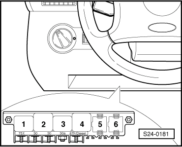

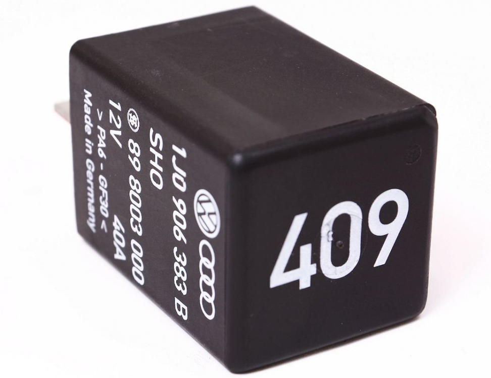

The fuel pump should prime when you open the driver's door. I think the fuel pump relay is the 409 relay, as I've just removed mine to send up to another member for testing. It's not too bad to get to. Need to remove the panel that contains the OBDII port under the steering wheel and you'll be able to see all the relays.
Looks like this mate  image.thumb.png.8cba2cda9c54512a6491f51e8ce40d1d.png  & is located as Mankee says here image.png.1c9a67c7ddfa99f662be9cf106bb9eb4.png & if I remember correctly is position 4.
