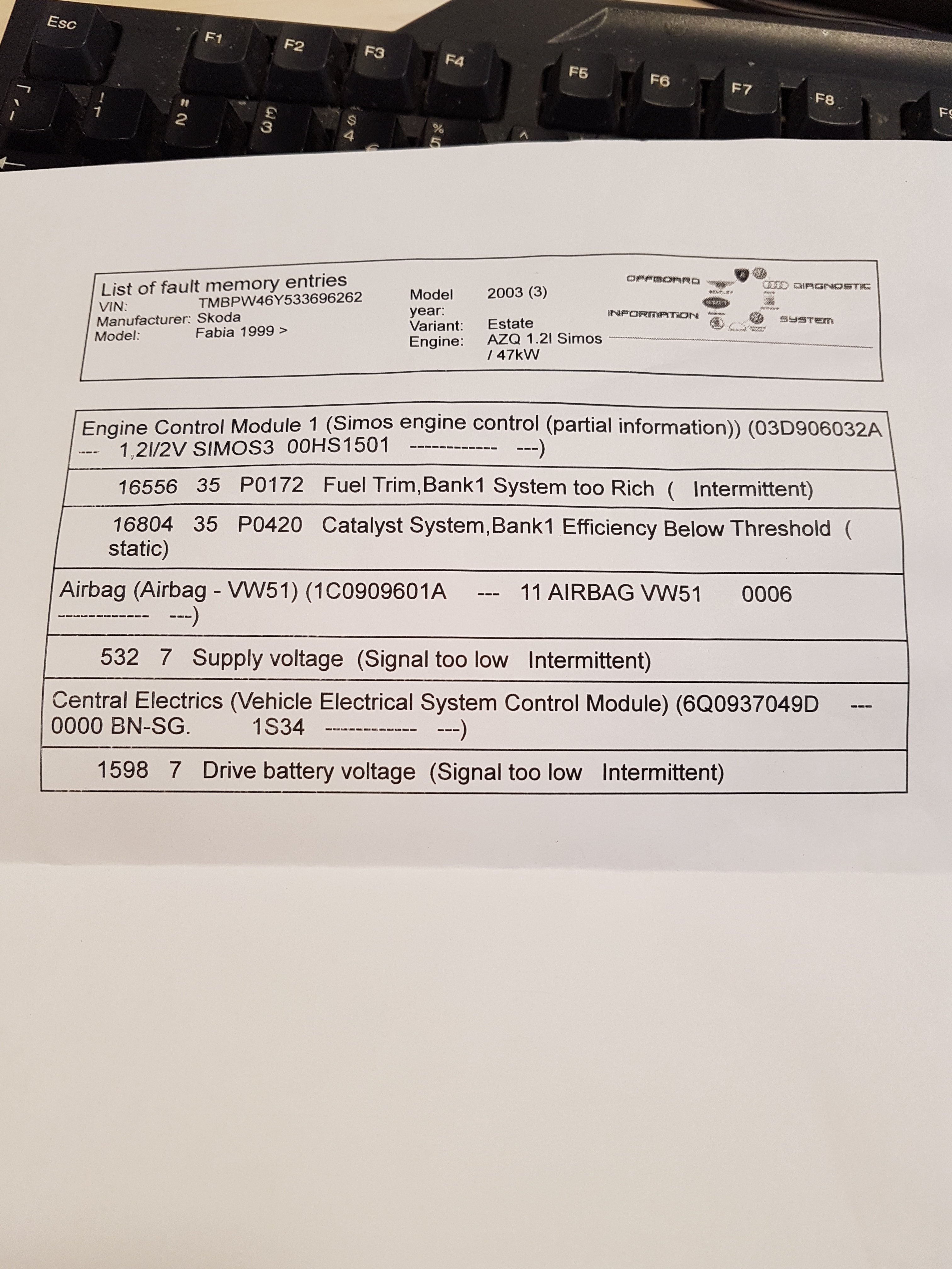

I've become the owner of a Fabia 1.2 (2003) in the last month and put it through a full service a week after picking it up. Unfortunately, in the last few days the EML has come on as I was driving down the M5, so I dropped in to a main dealer who, after fault checking it, produced one of these sheets (attached). The chap from the work shop advised the following:
1. Check the main wiring loom for water ingress - apparently a common fault and one that Skoda may be willing (subject to service history) to contribute towards replacement
2. If the loom shows no sign of water, replace the "Bank 1" sensor - which I presume is the Lambda Sensor adjacent to the engine (?) if so, could someone who's not technically/mechanically minded do it?
The only thing i've noticed is that the fuel economy is really poor, which could explain why it's flagged up as running "too rich"?

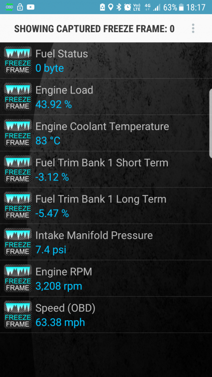

I decided to buy an OBD II reader and download the "Torque" android app which referred to the Bank 1 sensor again. I've just cleared the code, EML has gone off and i'm hoping that after 100 miles or so,  it doesn't come bcack on again and that i'd just have to leave with the poor fuel economy.
Does anyone have any comments to add/suggestions on whether I should just go ahead and replace the Lambda Sensor?
Many thanks in advance.
Chris

Suggestions from official documentation for fault code 16556  – Test fuel pressure regulator and holding pressure ⇒ 1.2/40; 1.2/47 Engine - Mechanics ⇒Rep. Gr. 20 .
                                                                                                      – Check the exhaust gas system for leaks (particularly when using lambda probes).
For fault code 16804                                                                     – Read measured value block, display group 046; check values in display field 3
                                                                                                       – Inspect exhaust system for leaks or inspect for damage if necessary between both lambda probes
                                                                                                       – Perform the exhaust-emission analysis ⇒ Maintenance ; Fabia .

How long had the engine been running when you captured the 83 degrees C?
Possible thermostat over-openness?
I think all of these issues stem from the excessively rich running, over-fuelling tends to soot up and foul both the Lambda probes and the catalyst.
The most common cause of over-fuelling is a faulty ECT sensor causing the ECU to believe the engine is always cold. I would replace the ECT sensor first and do a hard reset by disconnecting the battery and forcing the engine to re-write the dynamic map during a long run down the motorway to burn the probes and the cat clean.

In all honesty, I can't accurately remember. I will take another reading tomorrow aand let you know what that is and how long the engine was running for.
