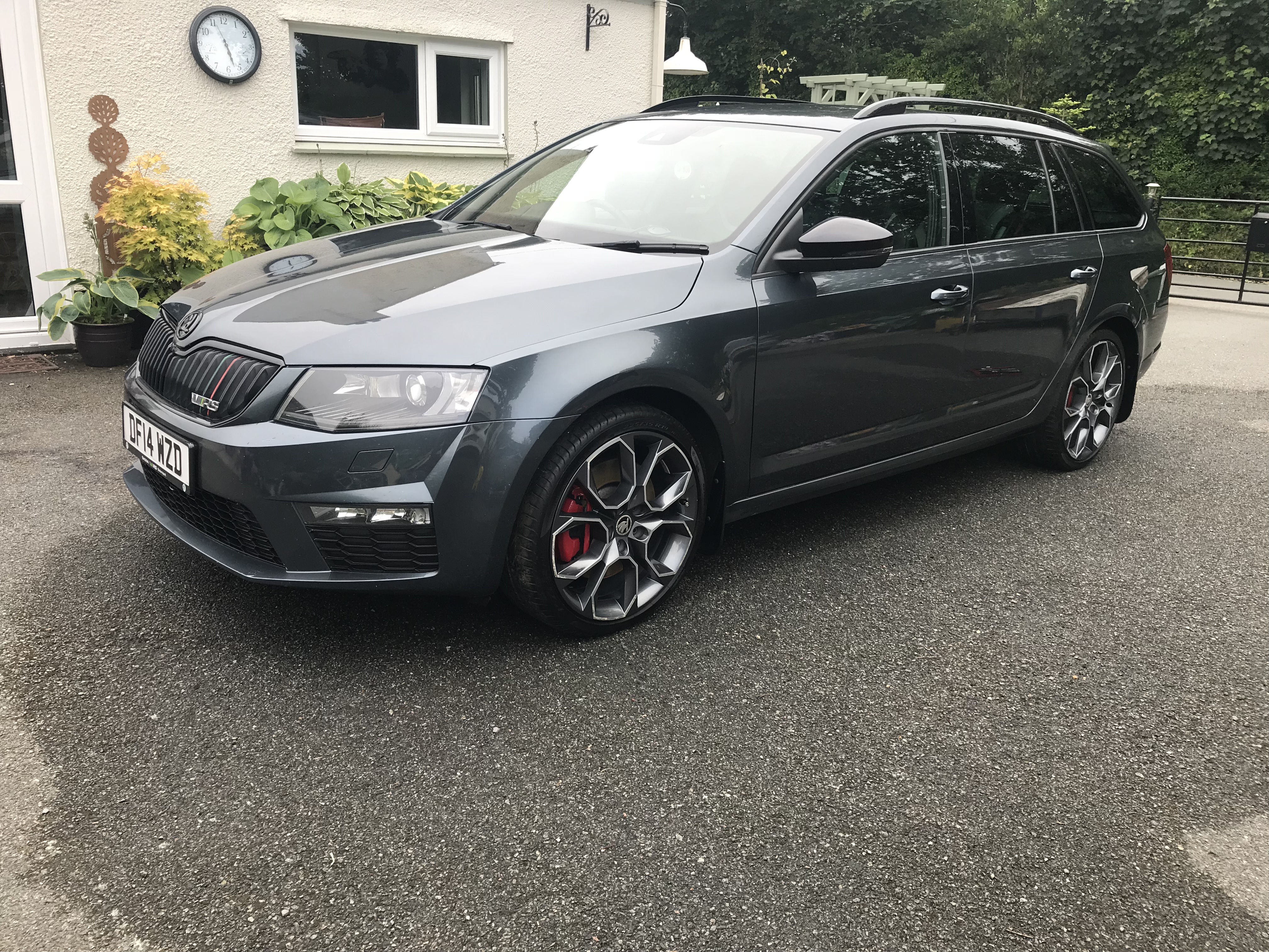

To give you an idea of how the 19’s look on the vRS with standard suspension (15mm lower than the rest of the Octy range)...
and how it looks on 40mm lower than standard...
@DavidOwens75 s/up/down - Seriously, the only thing that 19" wheels will definitely do is give you a harder ride. They may also give you poorer acceleration, braking and fuel economy, and issues with hydroplaning and/or in icy conditions. Wheel styling is entirely subjective, but I don't like the look of the wheels in the pics above.
