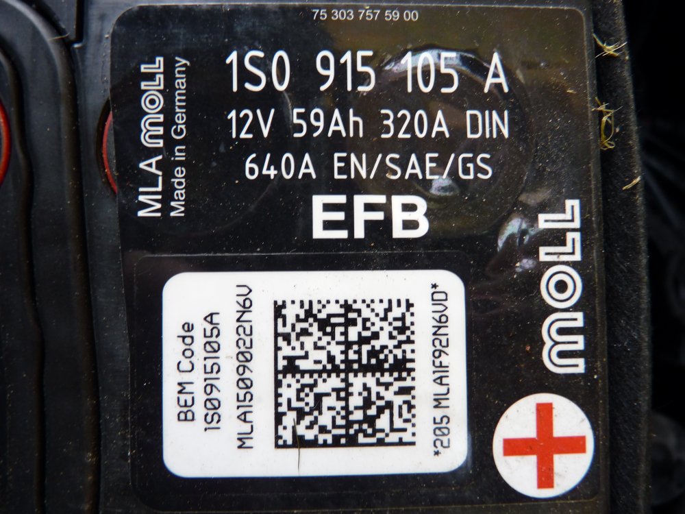

Hi,
Are there any fellow owners of a Yeti L&K 1.4Tsi with stop start that can confirm mine has been equipped from new with the correct battery?
It's a long story but and I want to put to rest a nagging thought!
I attach snap of battery label.
Much appreciate any help with this
Yes mine has an identical label.
This is the same spec as fitted to my 2016 Octavia SE Sport 1.4TSI.
Every supplier I have checked apart from a Skoda dealer gives the battery for my car as a 70AH AGM, Skoda customer services unwilling to say anything other than go to a Skoda retailer. You may find something similar with the Yeti
Thanks, seems like it is right then. Much appreciated
Thanks, yes the ones I looked up all had higher capacity too. Oh well...

One point - the EFB stands for "enhanced Flooded Battery" which is more like a standard lead-acid battery, vehicles fitted with automatic engine stop-start are quoted by Skoda as requiring an AGM battery. Practically speaking, apart from price, I'm not sure that there is a lot of difference between the two types and interestingly, my original MY16 Octavia battery (AGM) was replaced under warranty in its first year due to auto stop issues - the dealer fitted an EFB battery as the replacement.
There seems to be no real consistency as my car (2016 1.4 TSI) was fitted with an EFB from new, the dealer I contacted was clear that they would not even consider fitting anything other than another EFB as per original fitment. Perhaps everyone in the dealerships is not getting the same memo.
I agree that there appears to be inconsistent advice from dealers - however, Skoda is very clear in my handbook - "vehicles fitted with engine auto stop-start require to be fitted with a AGM battery"
They should have fitted an AGM battery !!!  I suspect they fitted an EFB as they are much cheaper
All the smaller cc tsi Skoda stop/start engines  seem to be fitted with an EFB battery
From https://www.yuasa.co.uk/info/technical/agm-efb-explained/ " EFB technology is now factory fitted to numerous entry level Start Stop vehicles"
