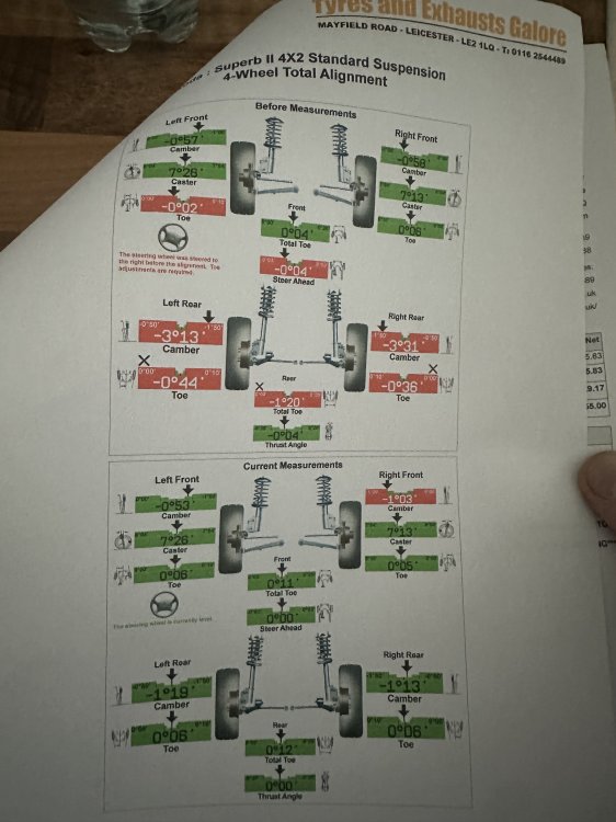

I would say that in your case there has not been any Camber adjustment done. At least on Octavia mk II and newer there are for sure rear camber adjustment possible. The front camber can also be to a very small extent adjusted by losening the subframe bolts and moving the subframe laterally. Probably the front lower wishbone balljoints have some adjustment too. Good thing that the thrust angle is straight. I would also opt for a neutral toe-in close to 0. In case the car is hard to keep in lane check/replace the rear control rods and wishbone bushes.

On 23/06/2018 at 13:11, TasMan said:
Seeking some advice on toe and camber settings following a 4 wheel alignment done this morning....
After getting a full set of new tyres I booked in for a 4 wheel alignment locally.
The rear passenger side tyre was badly worn on the inside so things were clearly out of adjustment, seems to be a common Superb Estate issue....
The garage was using a Hunter system and gave before and after prints as attached.  Anyway, I am not convinced on the new settings and questioned these at the time, but was told 'its a 4 wheel alignment and we only ever adjust the toe, and not the camber as its not adjustable...?!'  I got a second opinion elsewhere (Kwik Fit of all places....) and was advised everything should be 'green' suggesting camber is adustable.  I questioned the original garage again but was pretty much told they only advertise 'alignment' and not camber....  Am I wrong to expect the camber to be part of the deal on a 4 wheel alignment ?
Left Front and Rear camber appear out of tolerance, and worse than before alignment...should I be getting this re-done ....?
Thanks
Before
After

Suspension is complicated, even on a simple layout like the McPherson strut used on the front of these cars. Adjusting one element will have an impact on other measurements even if they're not touched. It can take a few goes around each adjustment to get everything sorted just right.
Camber is not fixed on any car, it varies as the wheel pivots on the kingpin axis, so adjusting toe is going to change the camber since it'll result in the wheel pivoting on the kingpin axis.
As an aside, while camber cannot be individually adjusted on each side on these cars, it can be centered. This involves loosening the subframe bolts and sliding the subframe left or right until the camber is equal on both sides. I've found that not many alignment shops will be interested in doing this job.
