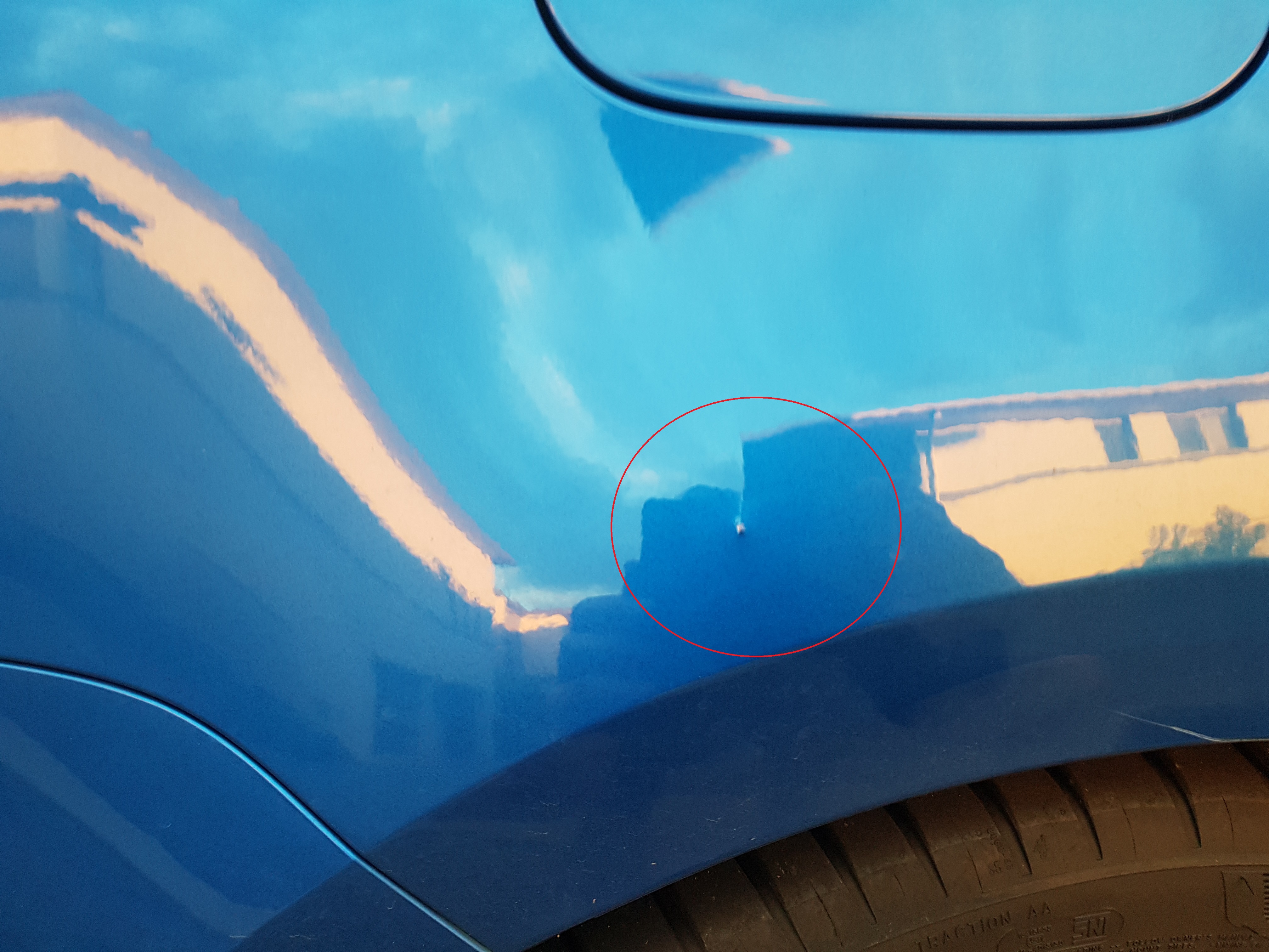

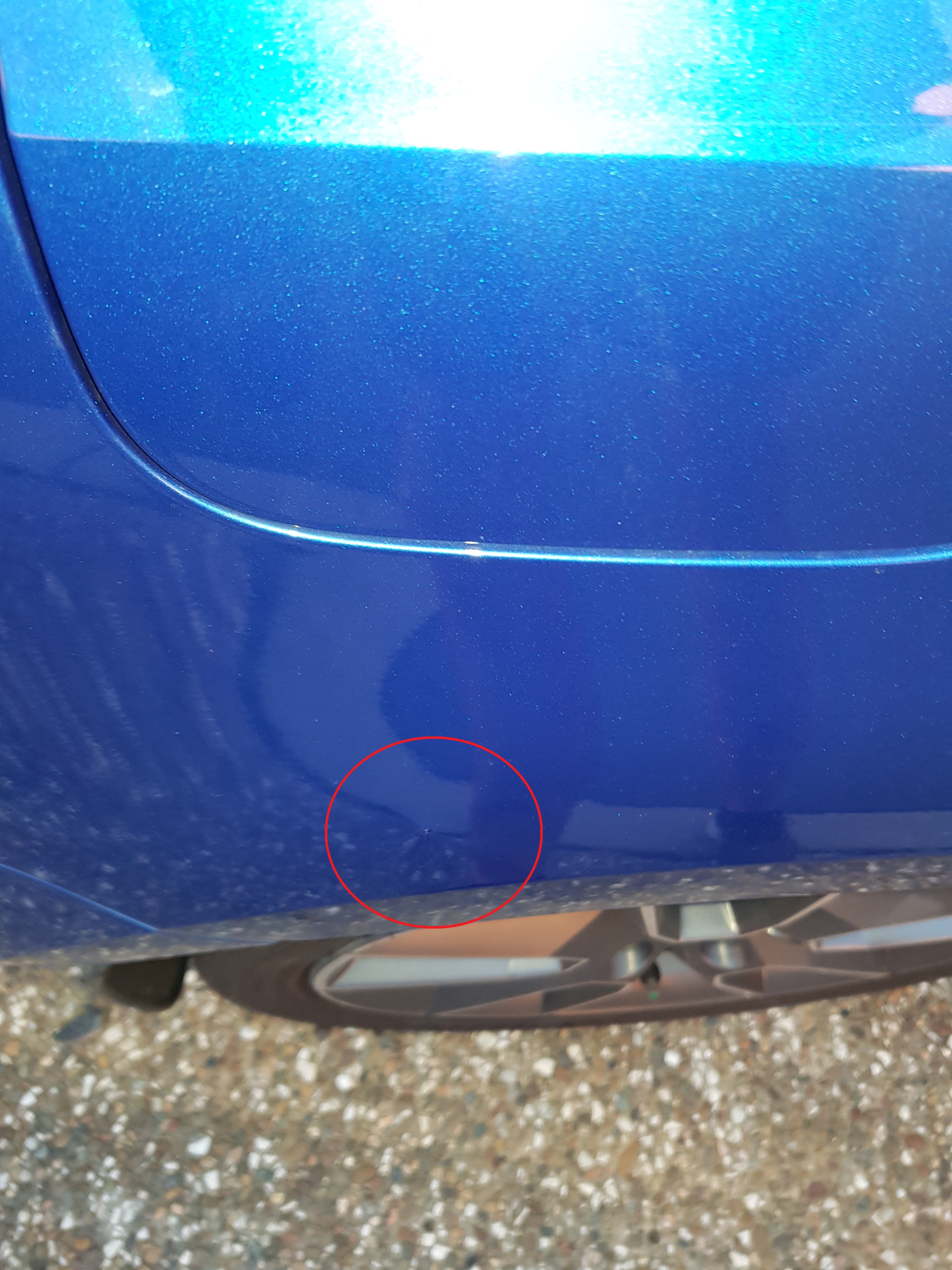

OK - odd one. Mk3 Octavia owners, can you check your cars please?

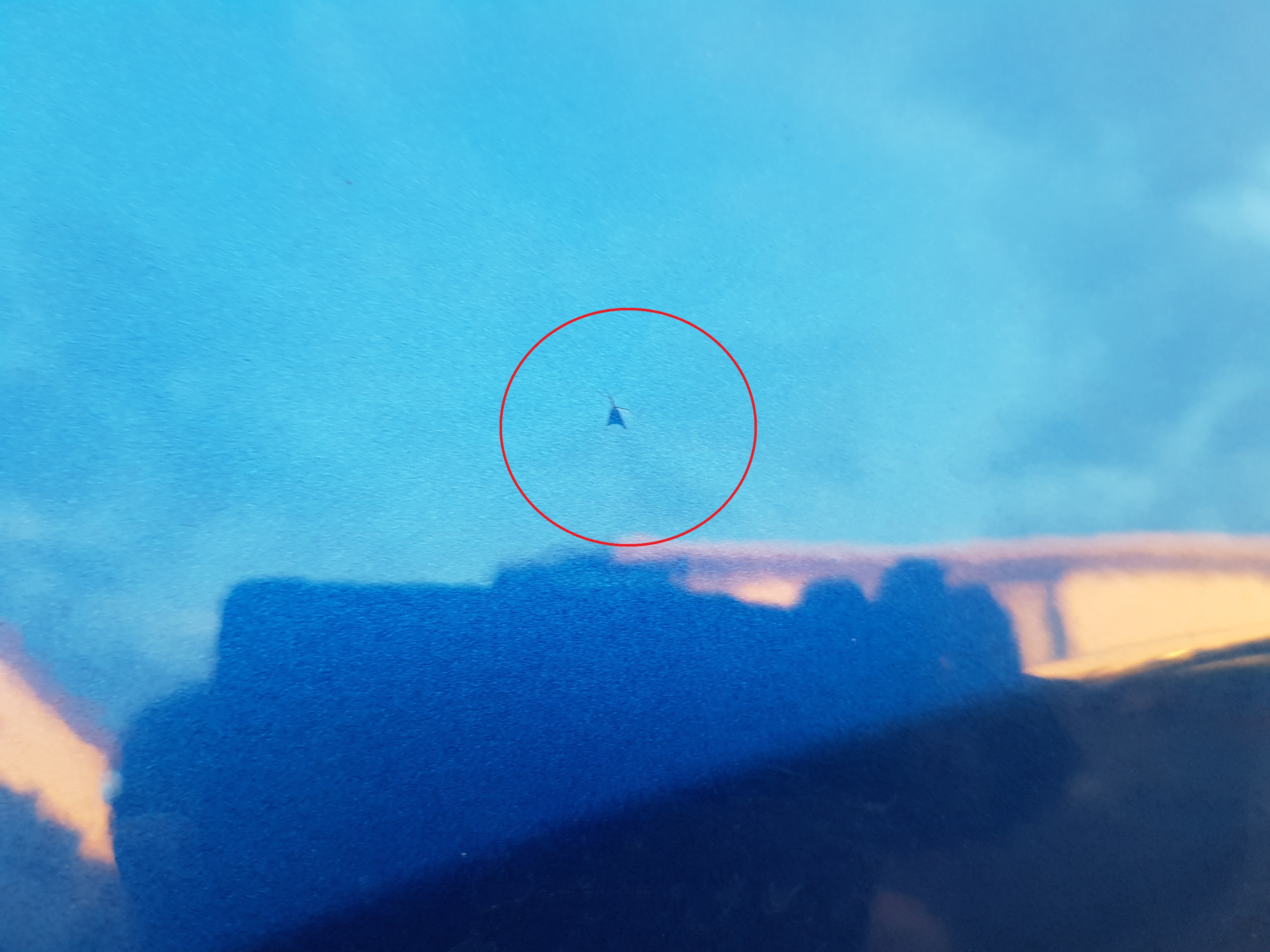

I've noticed a rust bubble forming under the paint, immediately underneath the fuel-filler flap which originally looked like a stone chip. Upon closer inspection, it's actually a screw from INSIDE the rear wheelarch, which holds the guard in place, that appears to have been overtightened from the factory, and the tip of the screw has started to poke through the bodywork & broken the paint.
It's very clear that this crack in the paint has occured from INSIDE pushing out, and not a simple stone chip.
If you stick your hand inside the wheel arch and feel around immediately under the fuel-filler flap, you'll notice the head of a large screw holding the inner guard in place... that's exactly where this rust bubble has formed.
Can't see anything on the passenger side, but the same screw head can be felt inside the arch.
Looks like an awkward warranty claim against Skoda for this one... any suggestions or comments?

How old is the car? If overtightened at factory then would have thought there would be an obvious bump from new?
This is not likely coming out from the factory like this. Probably someone replaced the screw and put longer then it is supposed to.
If you had it for a few years, prior to noticing, it sounds as if it has managed to penetrate more over time. Gonna be very difficult to prove you have not done anything to it, even down to knocking the wheel arch a bit. They MIGHT just inspect the screw for signs of being loosened/tightened, etc (Damage to the head or its coating), inspect it for length and uniformity against all the other ones as they will almost certainly have been manufactured/fitted from the same batch. Your best bet is if the car has the same symptom about to develop on say, the opposite side or on another screw along the liner. If it can be seen to be Skoda's own screws at fault, they have not been tampered with etc, you'll have a claim, otherwise, I think you will just have to try for a goodwill gesture or stump up the beer tokens and get it sorted yourself!
Might be helpful if you discover others with the same issue, specially if they came from the same production line, at the same or similar time.
Thanks all for responses so far.
Car is 18months old.
I also wondered why I haven't noticed since new, and all I can think of is body flex over time, which has caused the screw to move against the bodywork.
I've never had any work done on the car anywhere near the wheel arch linings, except new tyres about 2 months ago - but removing wheels to put tyres on would have no need to move the wheelarch linings.
Plus I was there watching while the car had them fitted, so there was definitely no messing with screws at that time.
So that's the point of asking if I'm the only unhappy person on the planet to be affected by this, or if I can find some other "victims", to balance my claim against Skoda.

I guess you'll only know when you disassemble the part & look at it (which Id suggest the garage should do so that they cant say you've done it yourself).
I cant believe it would be designed such that the point of a screw would be able to stick through the plastic even if overtightened so I'd imagine its got the wrong screw fitted & has been pressing against the bodywork the whole time.
At least the cause of the paint damage is obvious, and easily resolved,
and the only issue is the quality of the repairers paint match on a very small area of paint requiring an invisible touch up.
Just going by those photos, the repair will require filling and sanding therefore you'd be looking at least the whole panel being re-painted. Even the most skilled of painters wouldn't be able to spot or blend that specific area given it's prominent position. May be the slightest of possibilities (but not recommended) if it were a solid colour but metallic? no chance.

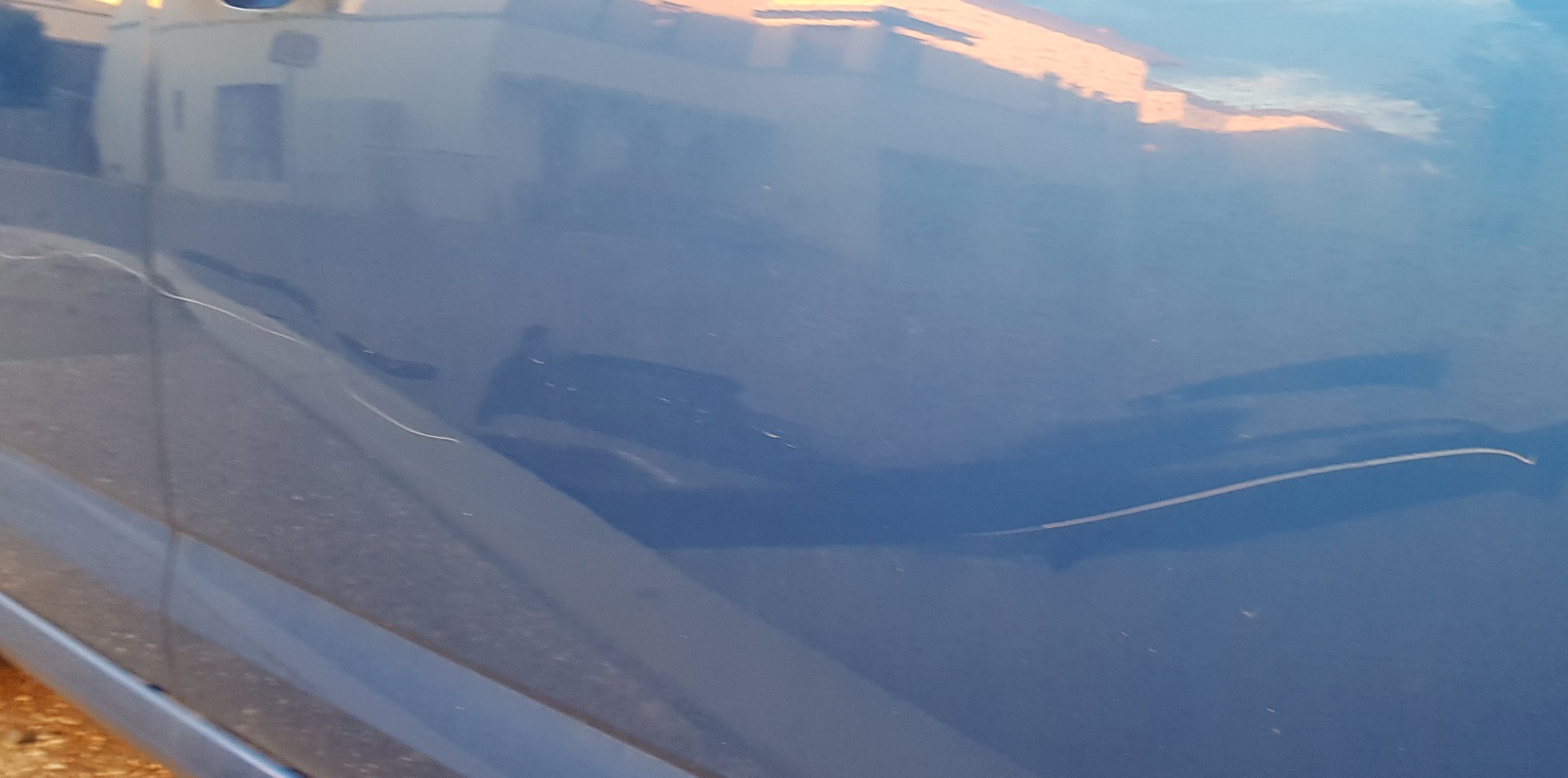

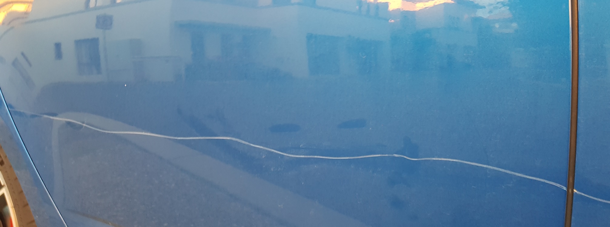

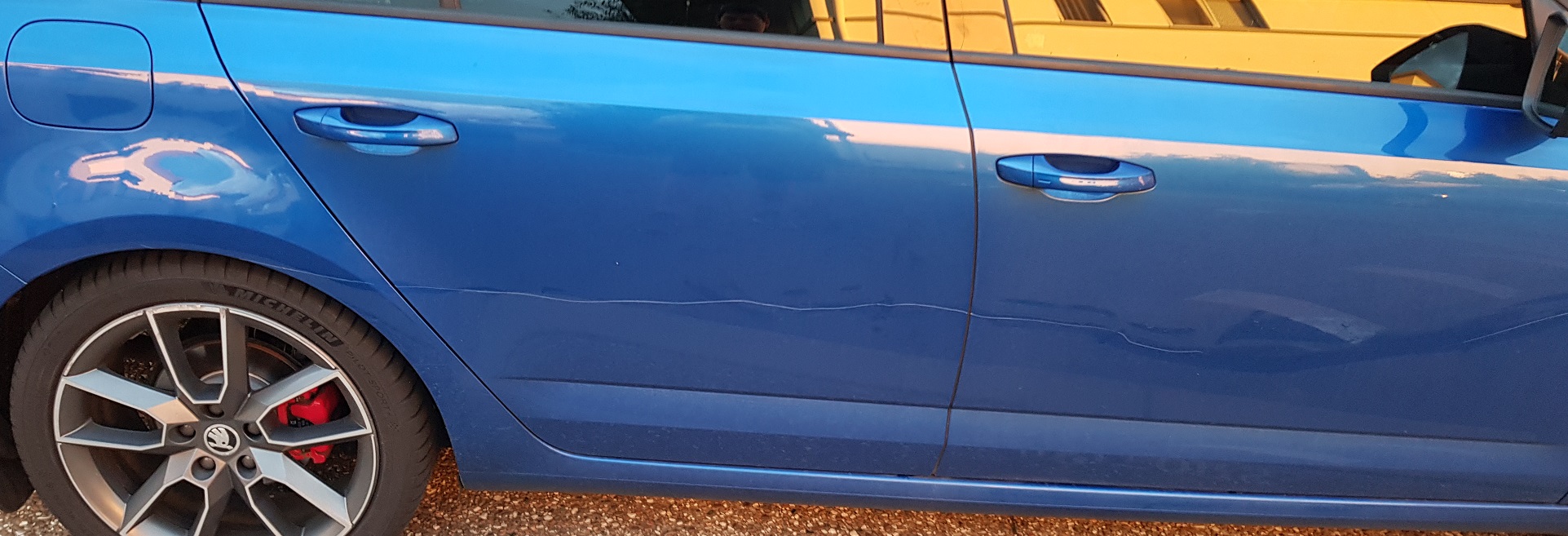

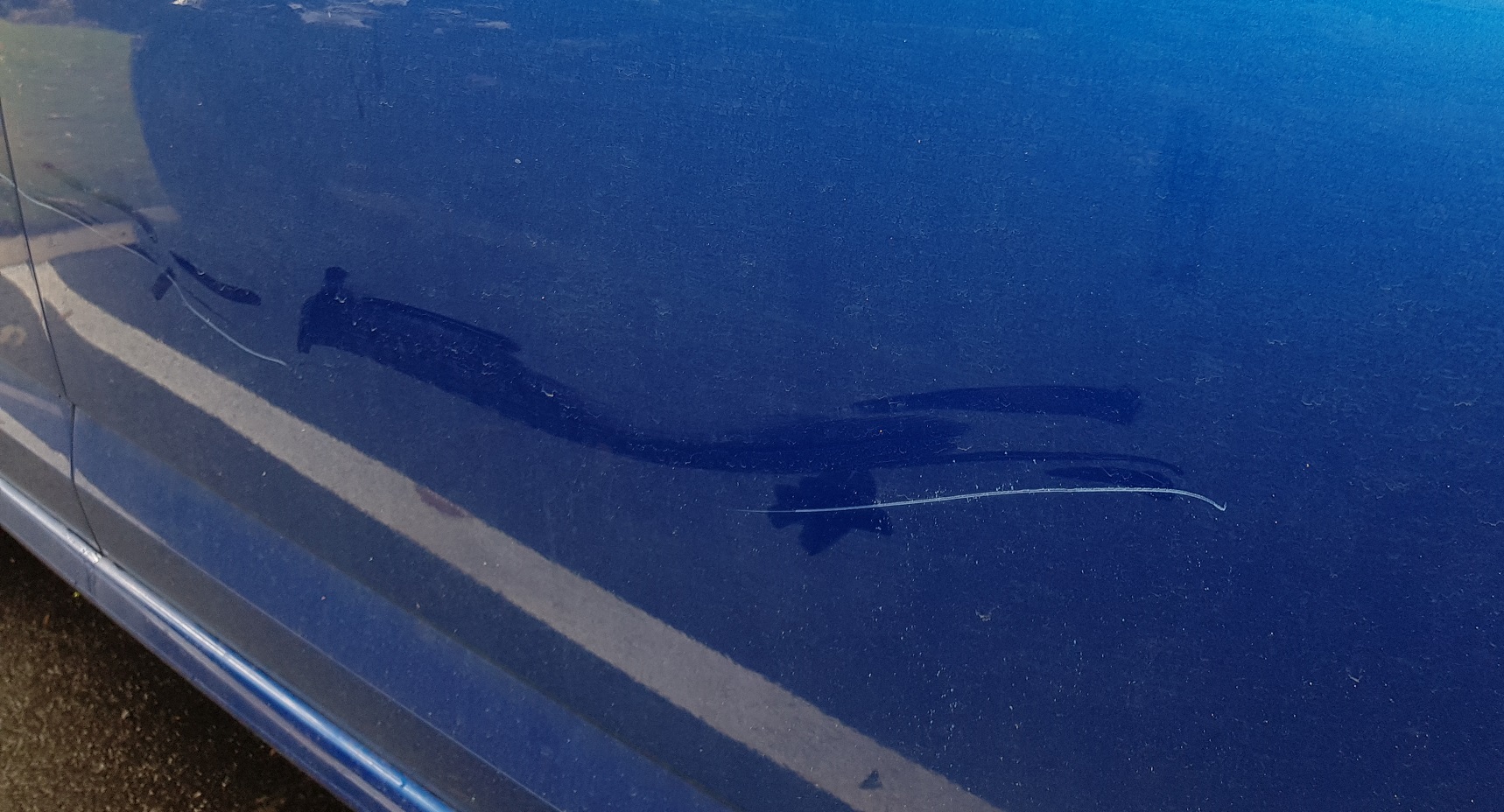

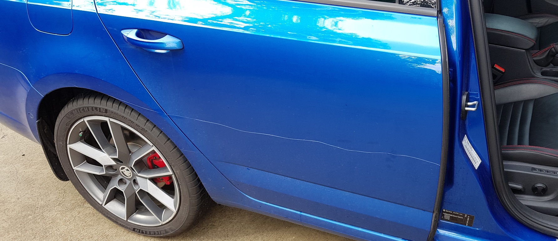

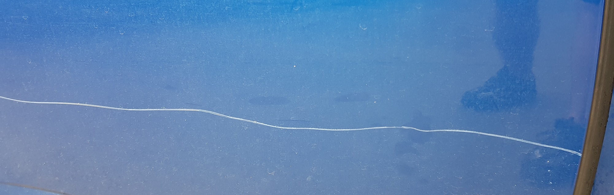

The damage is seen below.  Am I being unrealistic in my expectation, considering an entire side of the car needs painting, rather than just a tiny touch-up here and there?

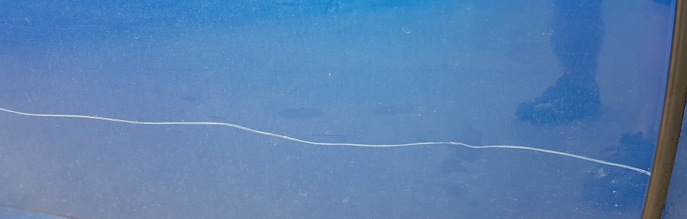

The scratches are quite deep, not just a light scrape down the paintwork, but deep enough that you can quite distinctly FEEL the scratch, and the "volcano" effect of the paint as you run your finger along it.
By that I mean, when I first saw it, I thought it was just some stringy road much that had flicked up on the door, and when I ran a finger over it, it was lumpy (convex), rather than a crater (concave) as the edges of the paint had sort of rippled upwards. Not sure how else to describe it.
I suspect that's a screwdriver job, not just simple car keys....?
Thoughts?

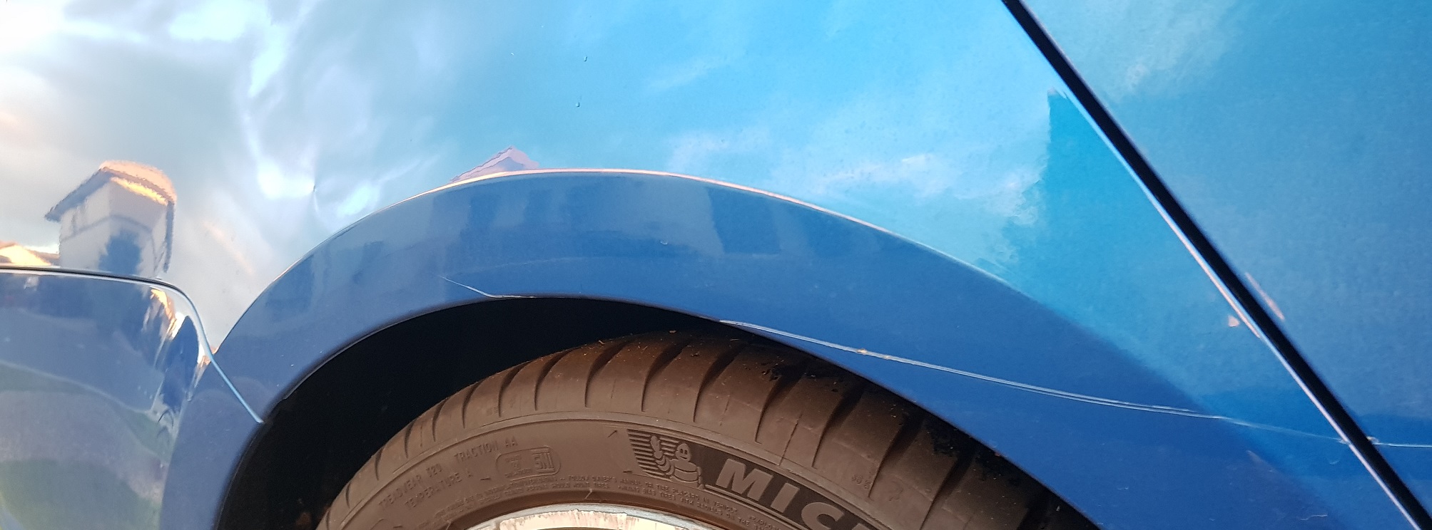

I meant to ask about the scratch on the rear wheel arch after the OP.
Looks like it was done as part pf the keying.
I can not see why the whole car should need respraying, it is the side that needs doing.
To Factory standard.

7 hours ago, spinifex said:
But my flatmate has noted that on a car less than 2 years old, he wouldn't settle for anything less than an entire respray of the whole car, to ensure absolute paint matching on ALL panels.
Having mismatched colours - even if only slightly - will definitely affect resale value when it comes to it, and considering the age of the car, do you all think this is a reasonable request to make?
In UK, at least, it would be a definite no to an entire respray, additionally the assessor would be very quick to note that the original damage was pre-existing. Insurance companies are keen to ensure that customers do not enjoy any 'betterment' at their expense.
