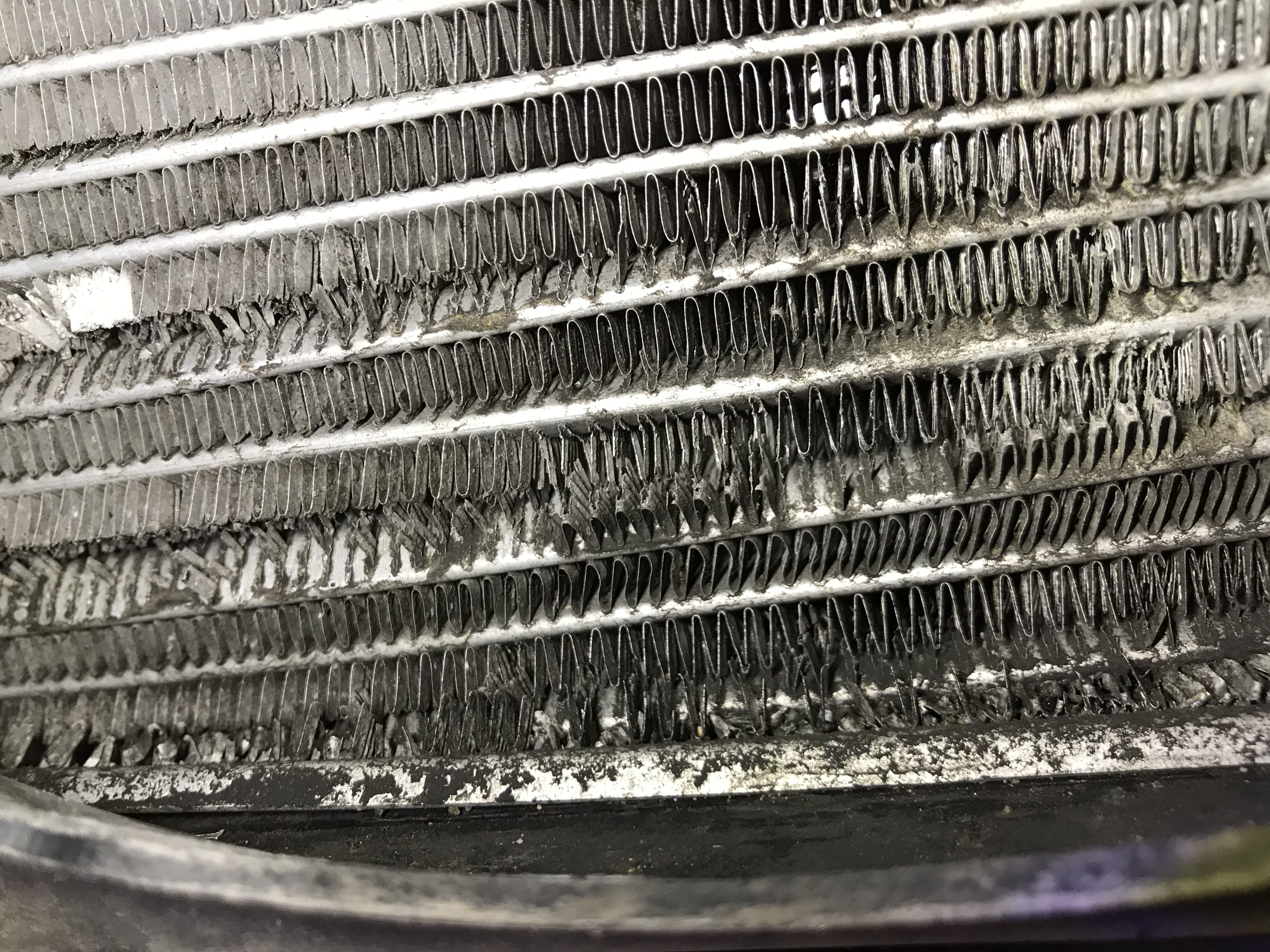

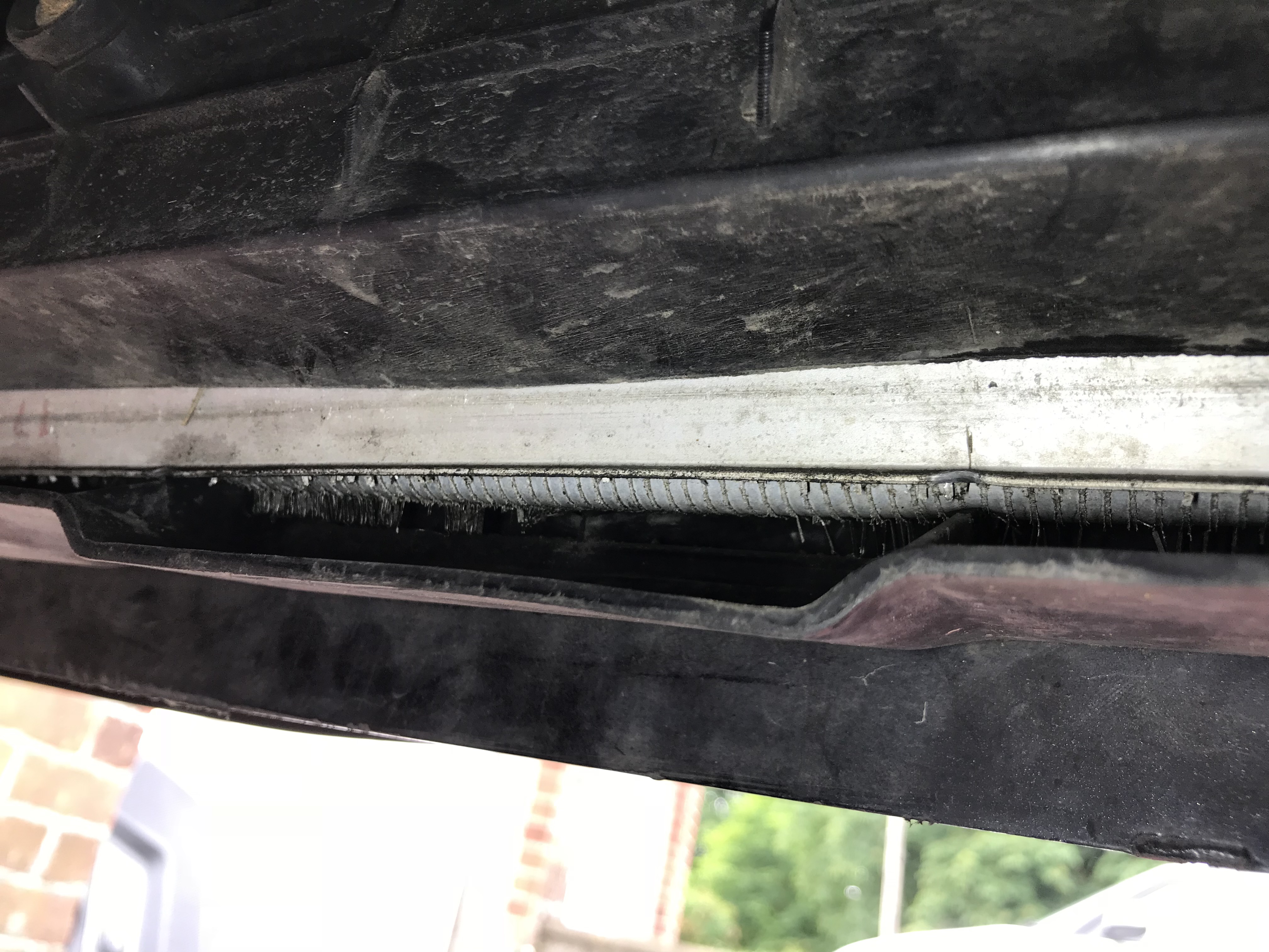

My cars radiator has started to leak badly, its coming from the middle and is dripping from the front side of the rad as i cant see it from the back.
Having inspected the radiator it seems its either had a crash at some point, or the radiator has just deformed. The bottom edge in the middle has been effectively folded back on itself
I cant believe its not leaked in the year ive owned the car as ive not hit anything to damage it
Im guessing new radiator is whole front end off job?
Any brands to avoid?
Advice appreciated
Yes front off, no, no brands to avoid, even cheap ones last ten years, so just get a cheap one.
