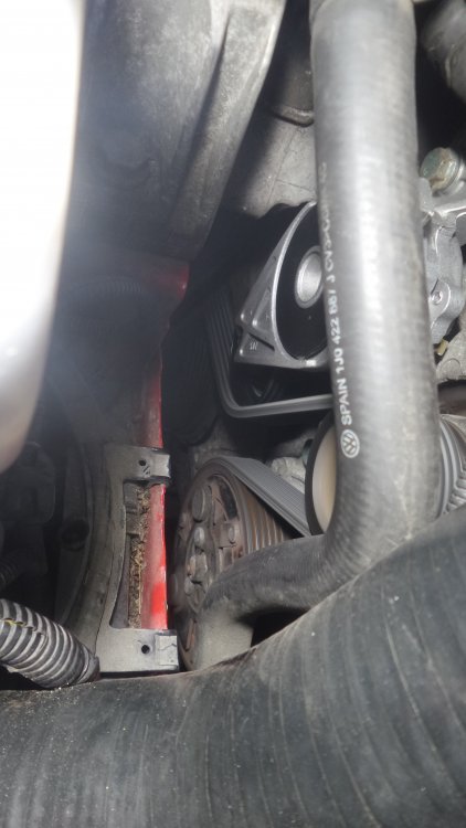

Yeah that's the one. I couldn't see on your pic.
Yeah its just out of shot but I cant say it may not of been in incorrect place when I took that photo.
