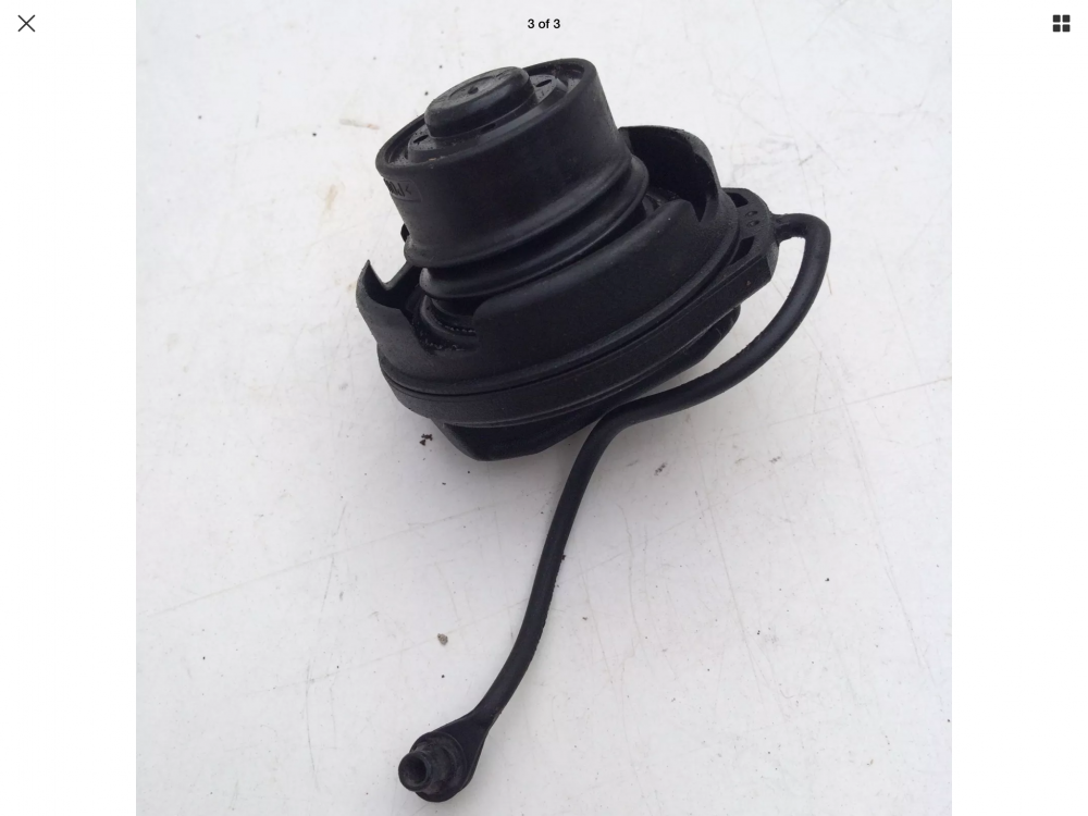

Hi there , can anyone help regarding if you can purchase the fuel cap cord that comes as part of the fuel cap as mine broke this morning ,picture below of piece I'm  talking about , no doubt it's a whole new cap :crying:.

Yep a whole new cap. I tried the dealer. The parts guy and I went through lots trying to find just the lead to no avail. Others may have had better success.
Thanks for reply Danny , seen a couple on eBay as used parts , how much was new one ?
I think the new one is around 45 GBP, I wanted to get one for my car, dropped the idea ... :D
Yeah I am not paying that , think I will try and make one myself with large/ long cable tie

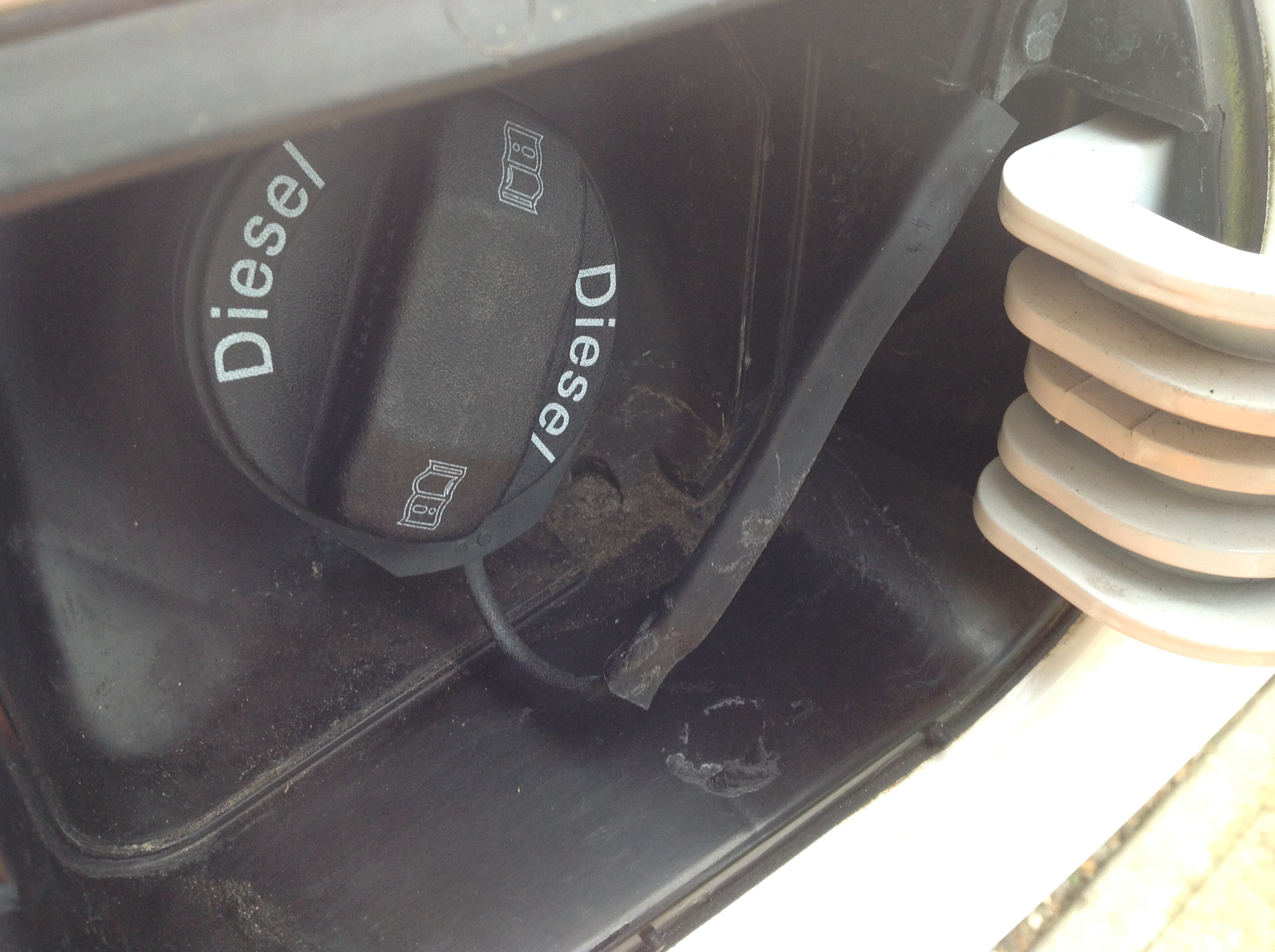

Fixed it now with some u shaped soft rubber , glued both broken parts together within u channel and seems to be working fine now.

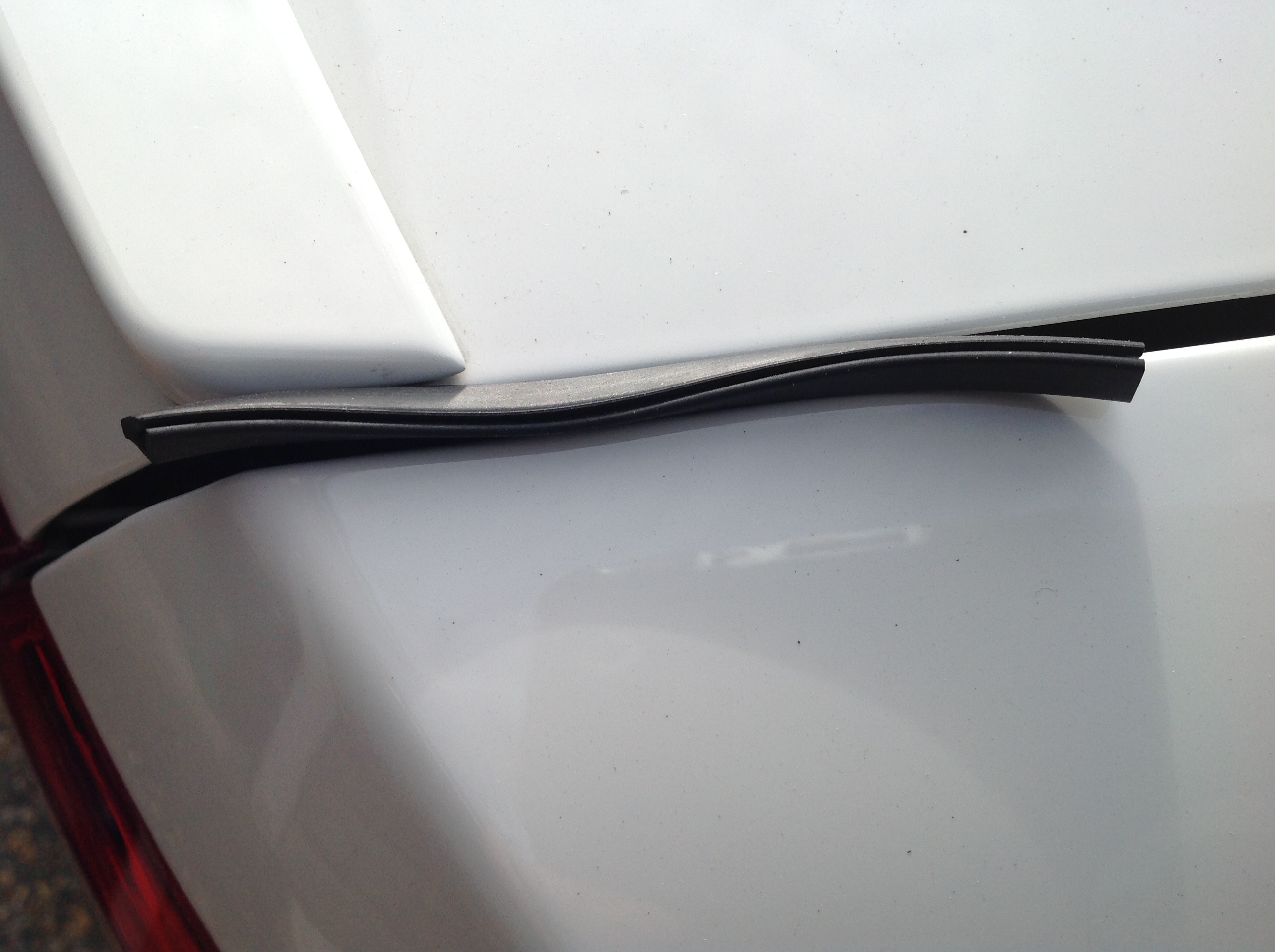

The fuel cap was received today, already installed, and it works. It even looks and feels like a genuine part (who knows, maybe it actually is). There is only one downside (relative) of the received new fuel cap - the screw/ridge part is a bit longer, meaning you'll have to turn 2-3 more until you tighten the cap to the point until top switch starts skipping (meaning you've reached the required sealing tightness) compared to the stock cap (well, at least in my case) ... I've also figured out why the rubber fuel line cord breaks close to its anchor point on the fuel tank inlet - the fuel tank door's hinge always shuts the cord with it (unless you yourself put the cord out of its way before closing it, shown clearly on the last photo), making it break sooner or later ... fault with the design, or possibly done intentional, so they can sell you an expensive fuel cap some years later...
All in all, for the price, I'm not complaining, it's not like I'm refueling the car every few days that a few extra turns create a bother ... I've tried checking whether or not it would be possible to put the cord from the new cap to the old one - not impossible, but a hassle, requiring cutting and gluing and keeping your fingers crossed that it would hold long enough afterwards (basically, on the level of @fabman's first aid shown a few post earlier). The received cap and cord comes with a plastic bolt (shown on photos #1 & #2), which is not needed, so I've removed it from the cord. The cord's hole easily goes over the fixed anchor point. Reminder, my car is a 3.6 FSI, whether or not the design of diesel-powered engines and the actual refueling intake has some impact on the design of the fuel cap, I don't know (meaning, this might not be a suitable solution for your actual car, so first visually check what your part looks like exactly and whether or not my choice would help you).
