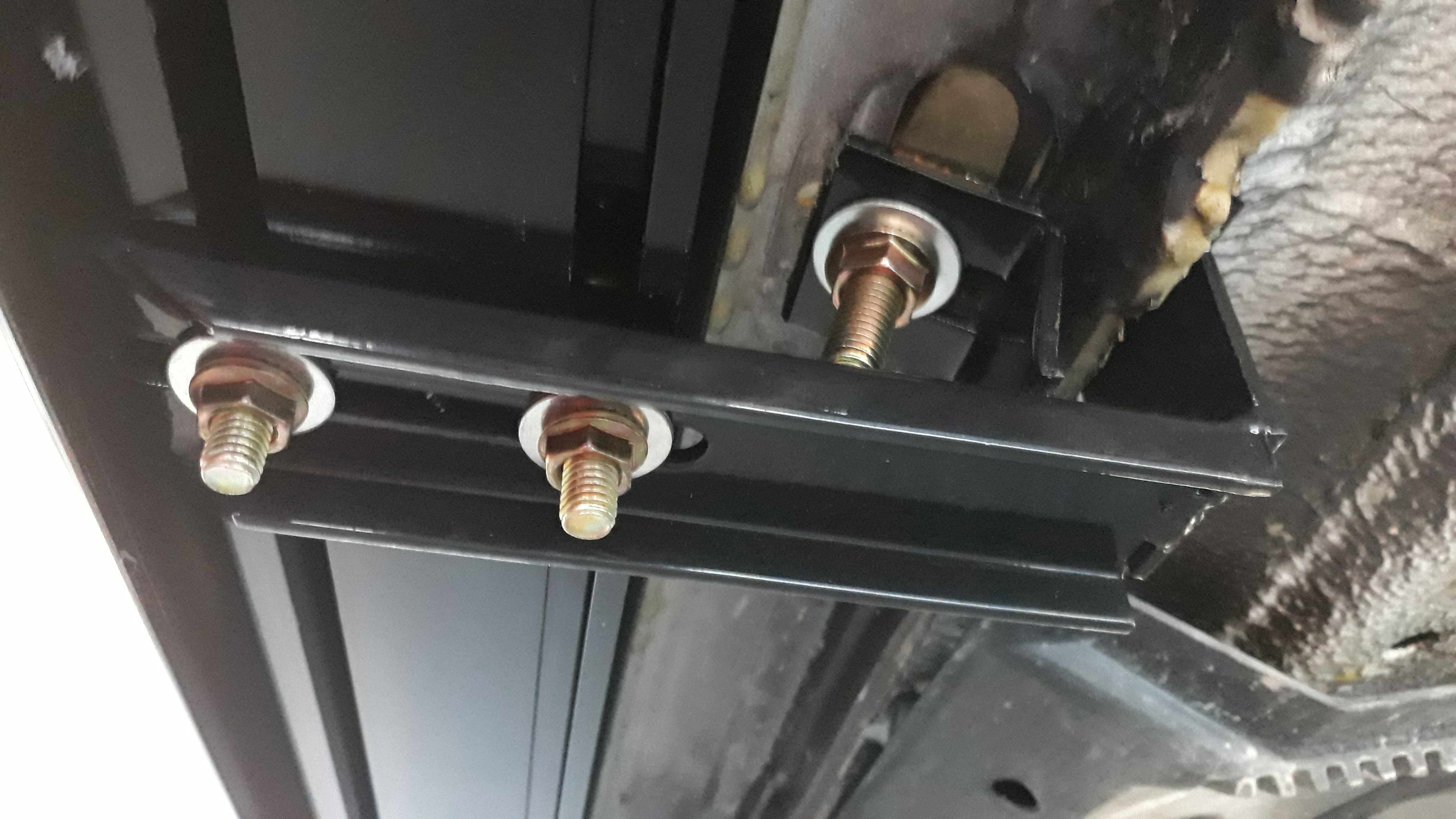

do you have any images from where/how they mount?

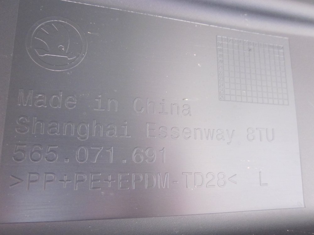

don't suppose u could put the part number on , would like to have a look at putting some onto mine. yours looks good there !!!

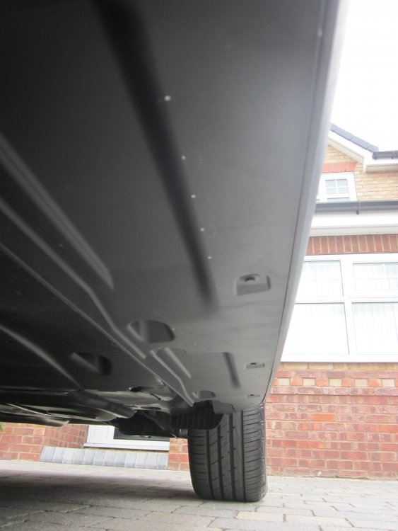

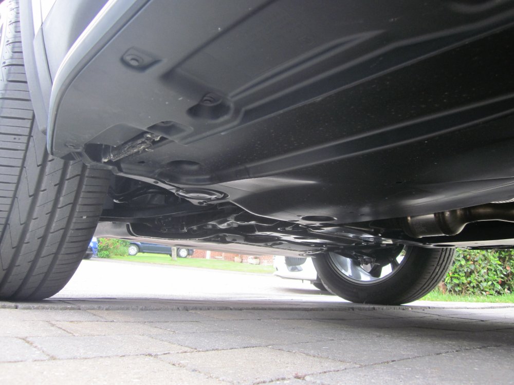

This stylish modification may also assist with preventing or reducing the mud ingress to the rear doors passed the rubber seals,  that has been reported by other owners. I personaly am very interested as they look to tidy up what I see is an unfinished area on the underside of the car that can be seen when you sit outside the vehicle... Thanks.

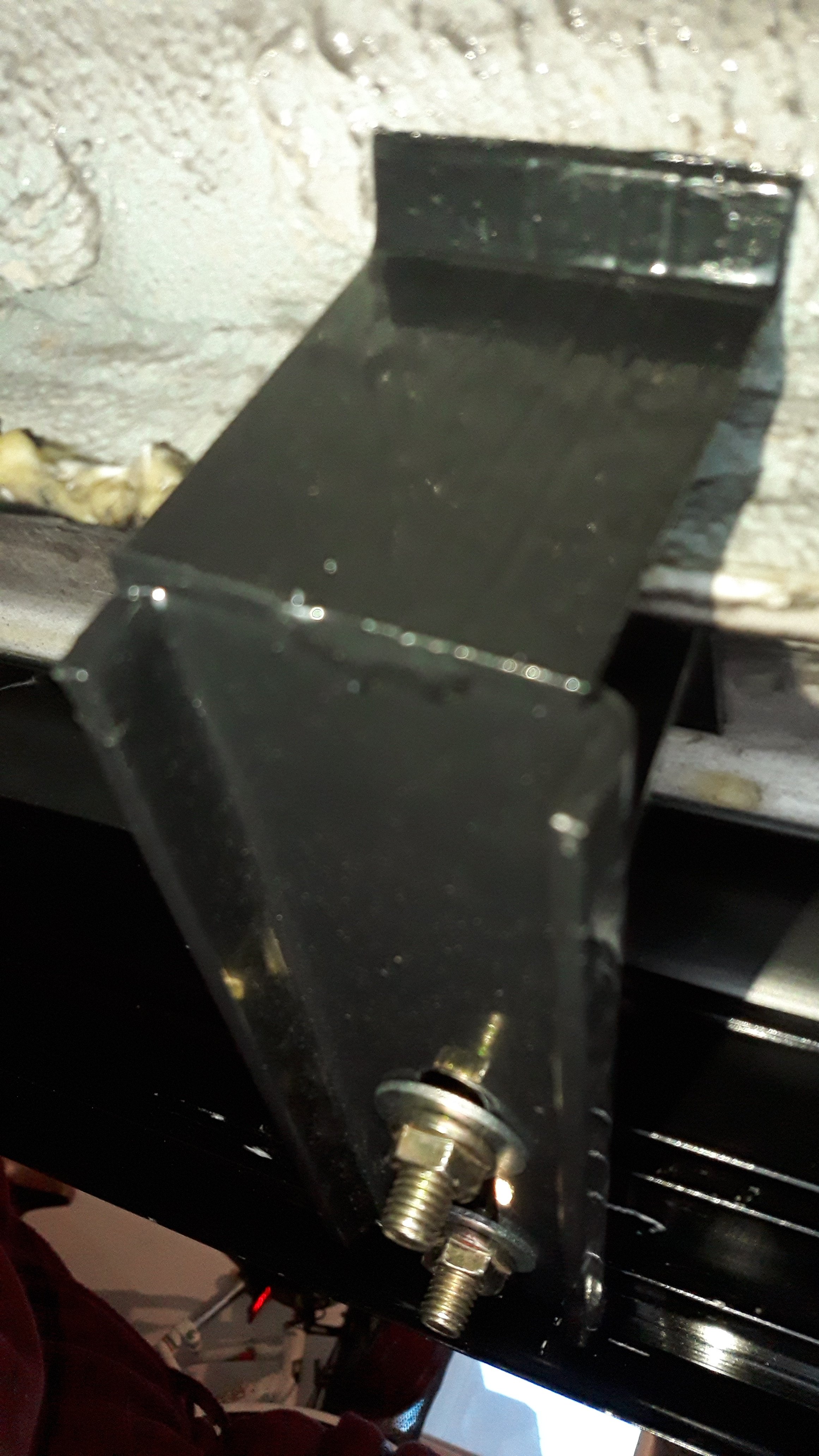

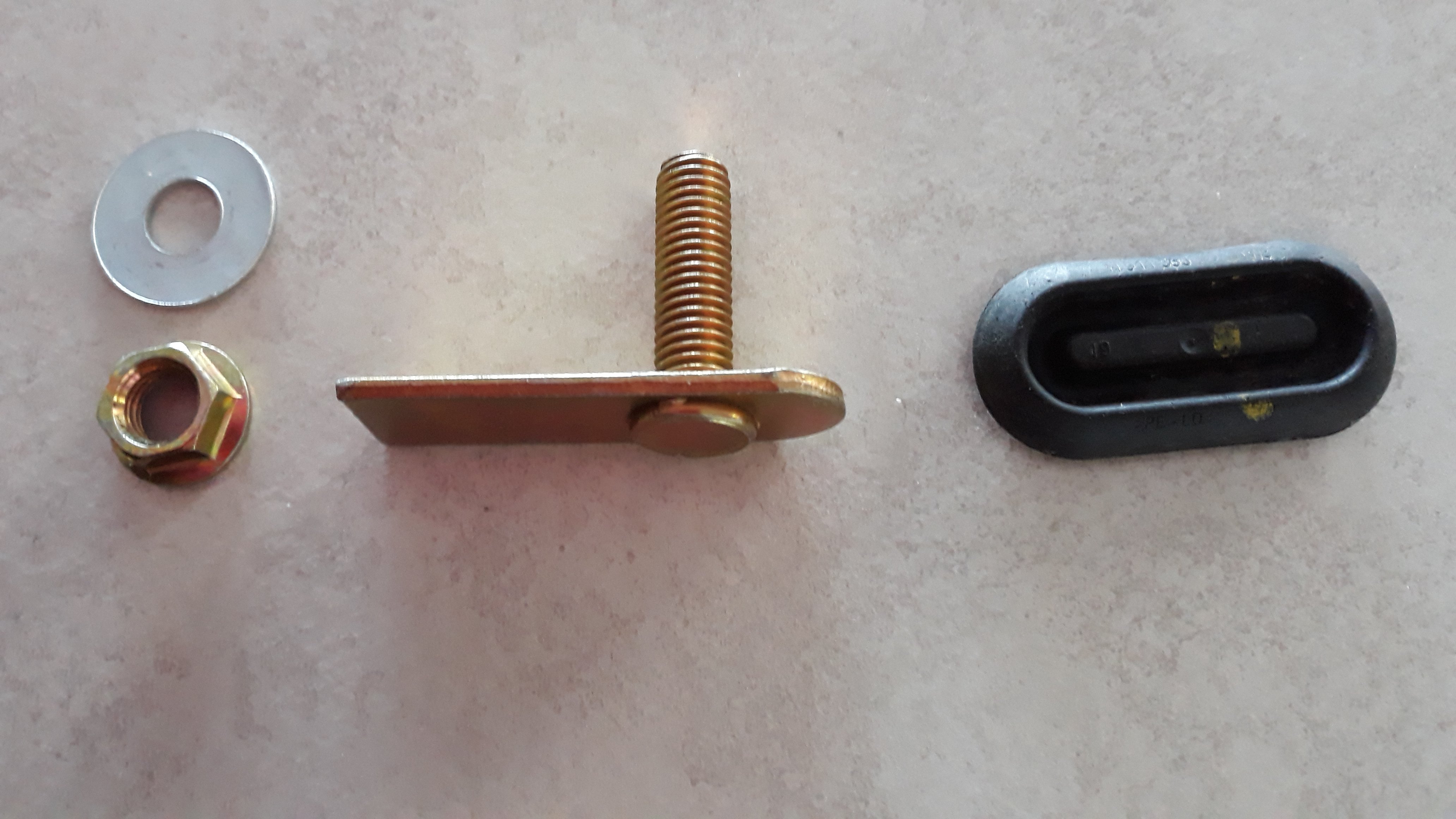

All eight mounts ( four each side are the same ). Remove the rubber bungs ( pictured) on the chassis under the door sills, insert the T-bar bolts and attach. the bar fits over the ridge and sits against the chassis. The two bolts to the left of the photo are holding on the side step. Seems all solid but I am not a panel beater or mechanic, just a home (car) handyman.
The mountings supplied are different to the ones pictured in the advert but all eight are the same. Hope this makes sense.
They are not Skoda OEM. Third party.
Oh I've posted the link if anyone else is interested... https://m.aliexpress.com/item/32858020634.html?trace=wwwdetail2mobilesitedetail&productId=32858020634&productSubject=New-Arrival-running-board-side-step-side-bar-foot-bar-Pedal-for-SKODA-KAROQ-2017-2018&spm=2114.search0104.8.21.eb272c4aAn2zWg&priceBeautifyAB=0
Thats it. There is a rubber strip that sits nicely against the chassis just under the door sill seal. Looks neat and tidy. Havent personally noted the rear door dirt problem but we dont have snow/ slush etc where we live and have only driven a couple of hundred kilometres.

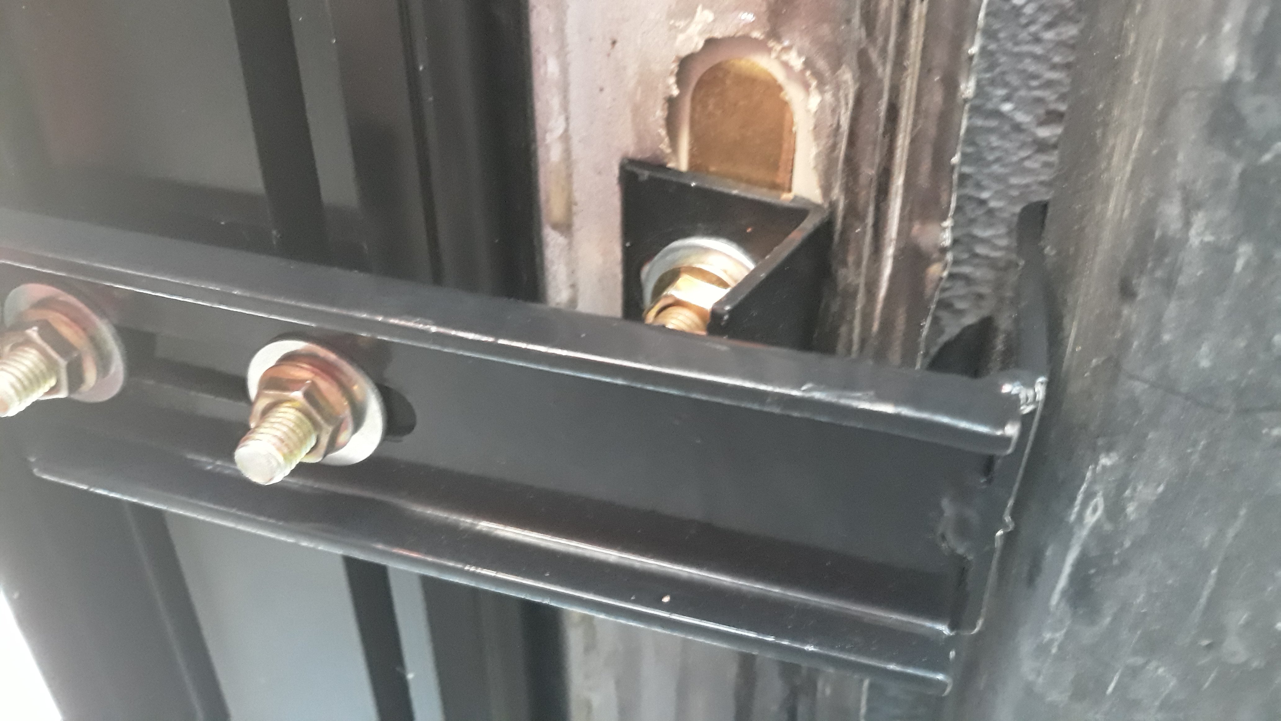

This photo shows the part of the mount that sits against the chassis behind the ridge you can see under the door sills.

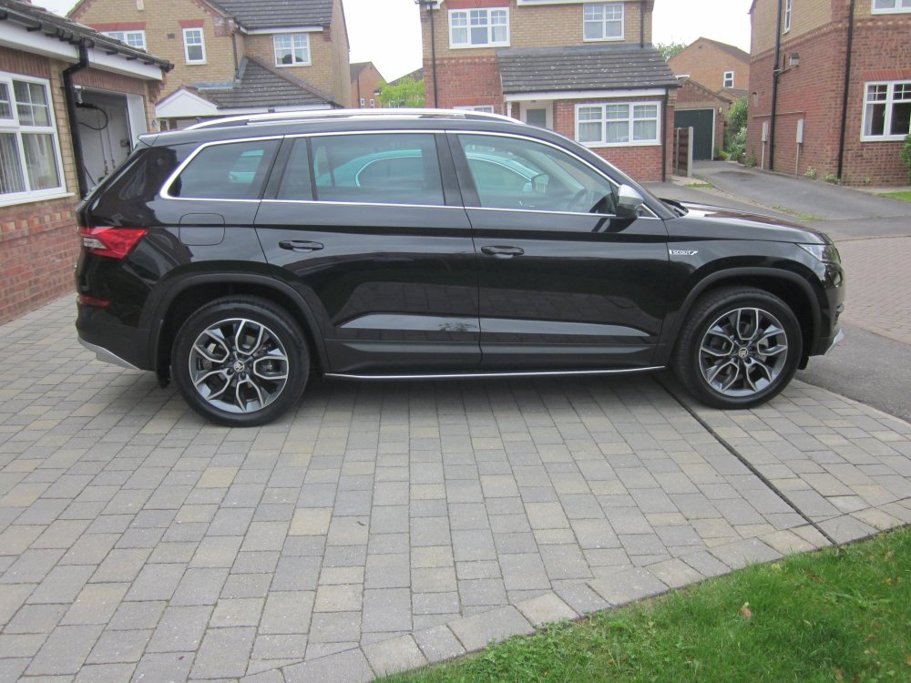

It's a shame Skoda didn't make the genuine running boards from the Kodiaq for the Karoq.
Their fitment on the Kodiaq is very clean...
