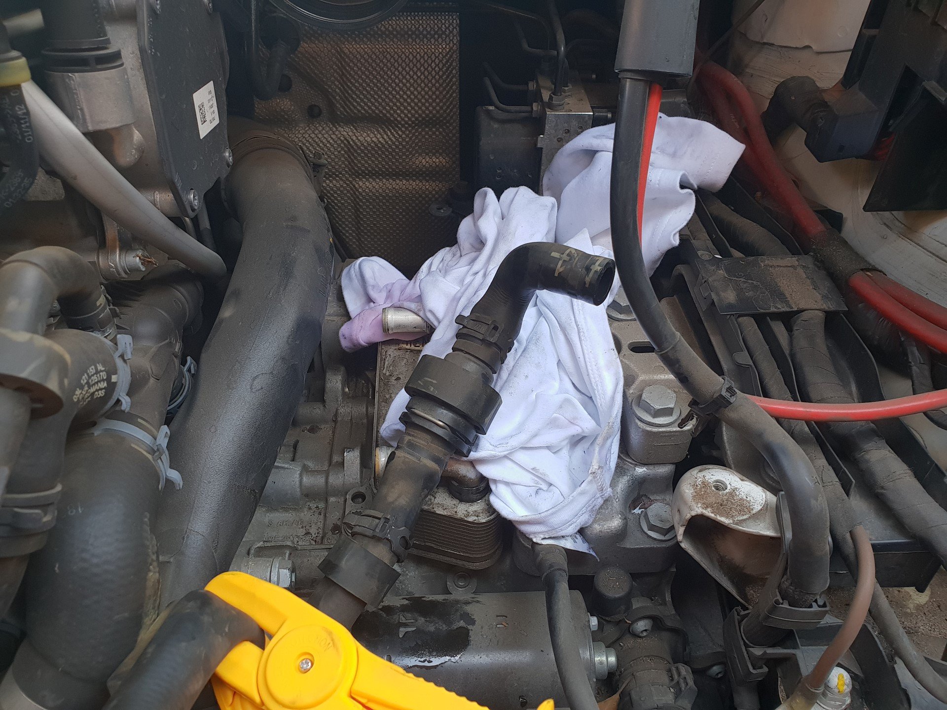

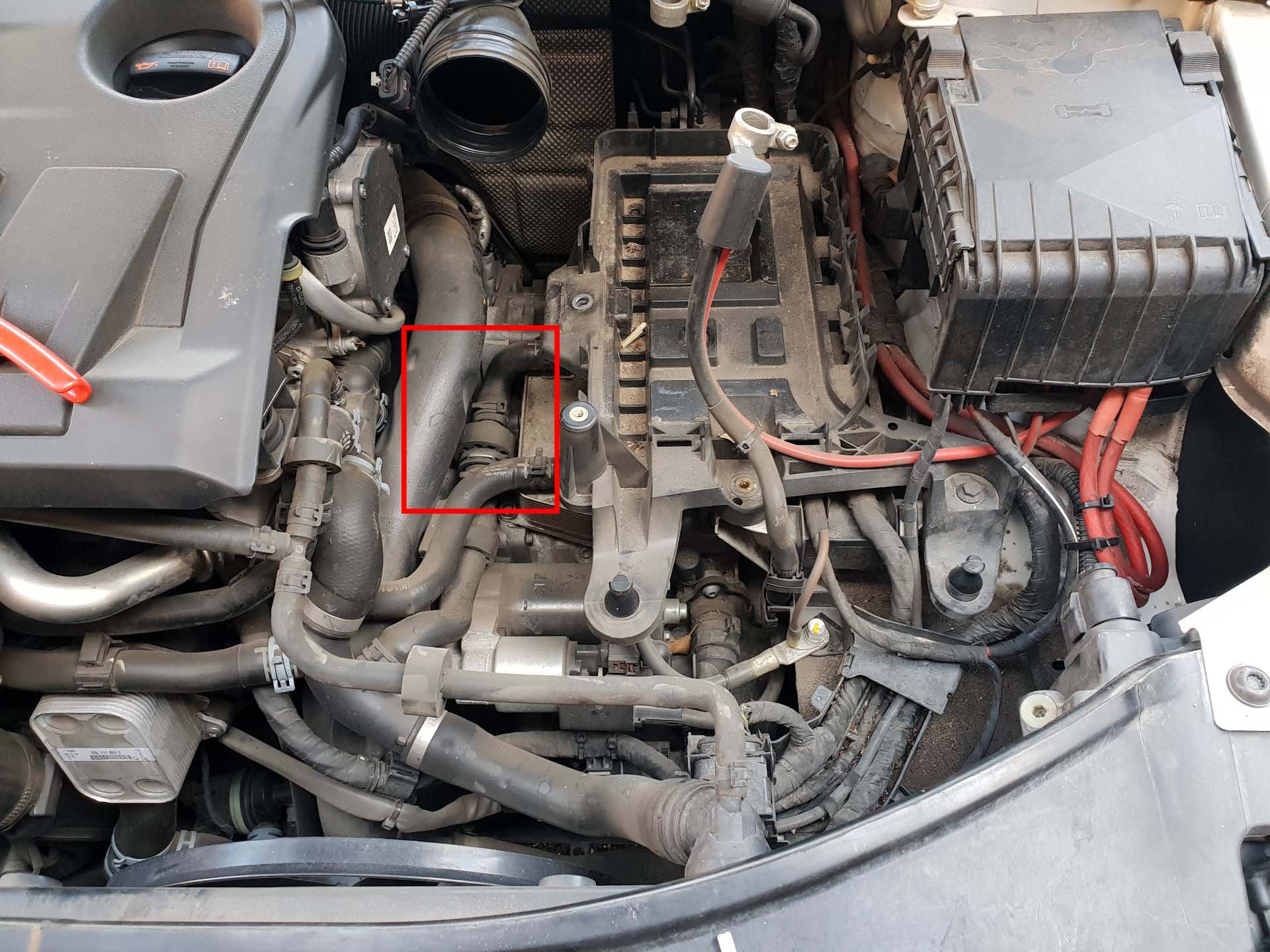

I finally got around to fitting mine, these pictures might help someone else who has to do it.  The car now gets up to 85-88 whereas before it wouldn't really get above 70 unless working hard.
Easy job:
- Didn't need to drain coolant, just clamped the hoses instead
- Remove battery
- Remove air box (disconnect MAF lead, disconnect vacuum hose, disconnect flexi tube to MAF)
-- Remove bottom air hose (from bottom of air box to the swirl chamber thingy (cold air intake).
--- This one was a PITA, I ended up removing the whole swirl chamber while still attached to the bottom air hose and the air box, then disassembling outside the car as the bottom air hose clips were quite strong
- Removed battery tray (not totally necessary but makes it a bit easier)
- Clamped water supply line (2nd picture, yellow thingo)
- Removed pipes from DSG cooler
- Lost maybe 100mL of coolant
- Remove thermostat and replace
- reassemble everything
- Idle up and see if it leaks
- Go for a drive, see if it leaks
- Carry around spare coolant all week just in case
