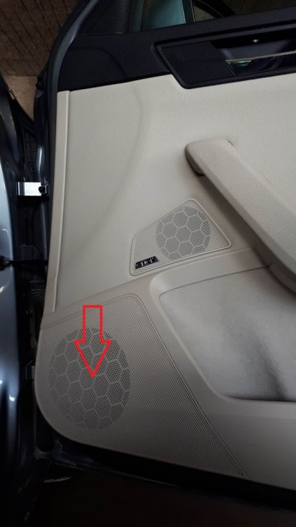

Does anybody had the problem with lower (large) speakers in the front doors. Yesterday I noticed that the lower (large) speaker in the front right door is not giving any sound - dead... What could be the reason for that? Maybe some wire is broken?! Does anybody tried to remove and then install back front right door panel? Would be thankful for any advice or instruction.

Verdict is that speaker is dead. Just 2,5 years... Maybe you know what is the part number for door panel plastic clips. There are various types of clips. I am looking for those which are around door panel.

Haven't heared about failed Canton speakers before so I think it is an isolated case of factory defect.
Actually the speaker is made by SONAVOX not Canton.
