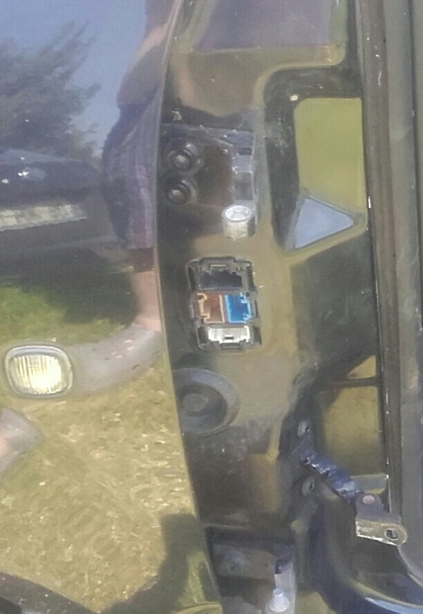

Aha! I knew this photo of the A post I took last week would come in handy. ........ Pity I forgot to take one of the wires on the door. ......
thats not the end im assuming op meant. The lock itself is a bit awkward but some wd40 and wiggle it in and out until the plastic tab unhooks and it will come off.
