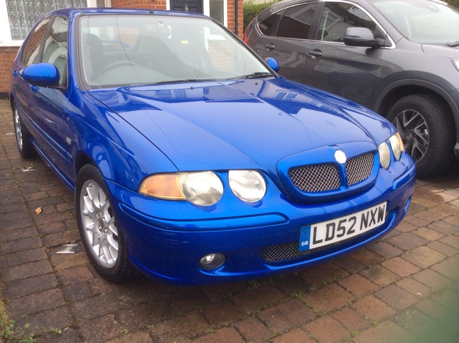

Some of you may remember what was and always will be the greatest car to ever turn a wheel upon this earth, the Brisk Rover. 160 VVC engine, LSD box and handling abilities that bent the laws of physics.
But alas, 6 years of seriously hard abuse from myself finally killed it so it was replaced by a BMW 318Ti Compact. Bit of rwd fun but it just wasn't as much fun as the Brisk Rover so a new project is under way.
I've been missing the Brisk Rover so much that I've decided it's time to build another one, albeit a slightly more rounded and up to date version.

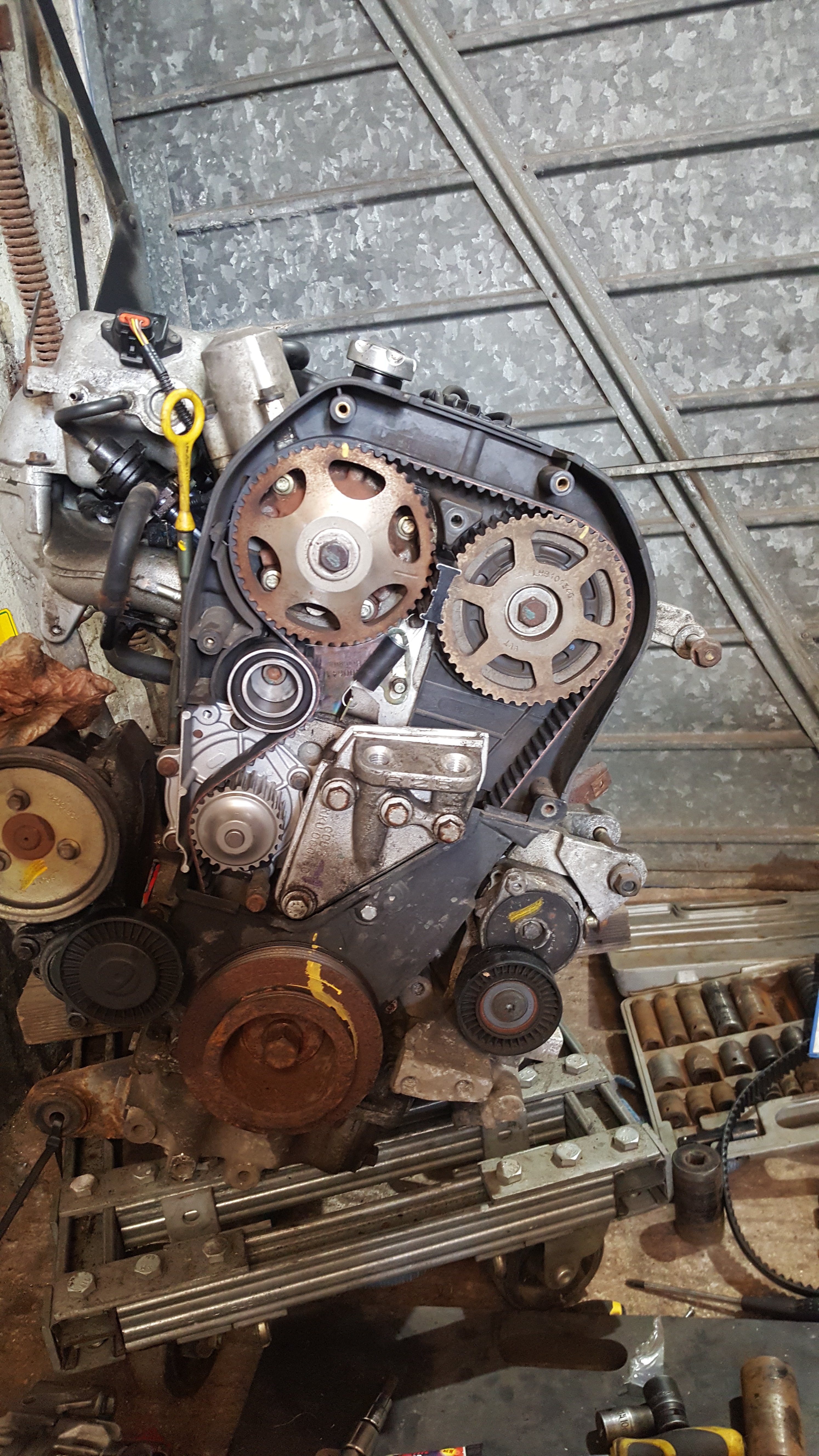

Phase 2: Whilst engine is out, do all the belts and replace any seals as necessary. It's already had the uprated multi layer steel head gasket installed so as it's showing no problems, I'm leaving that alone. I've got a sump baffle to go in and I've already done the belts, plugs (one of the old ones didn't match the other 3), rocker gasket, water pump and a camshaft oil seal.

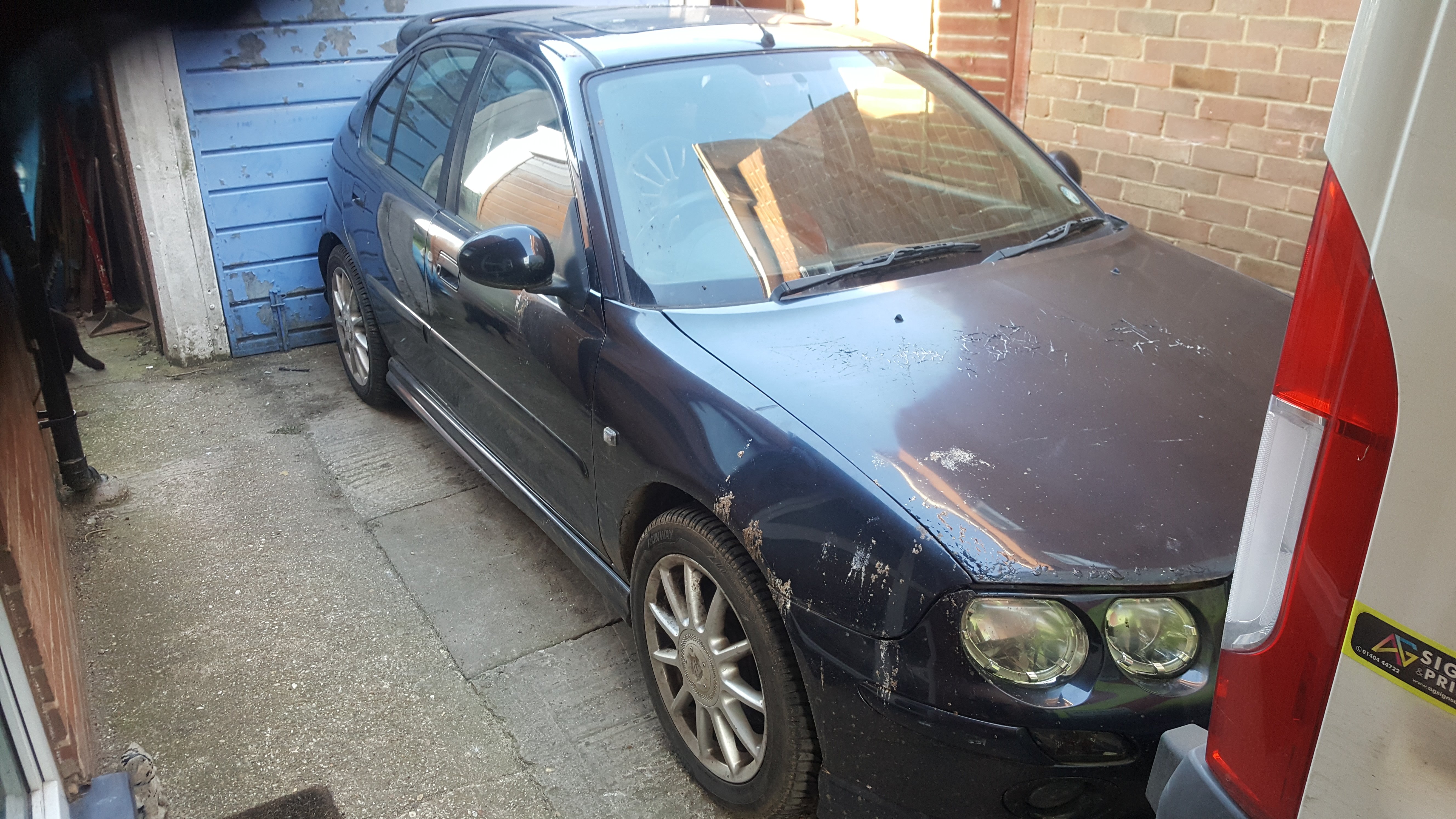

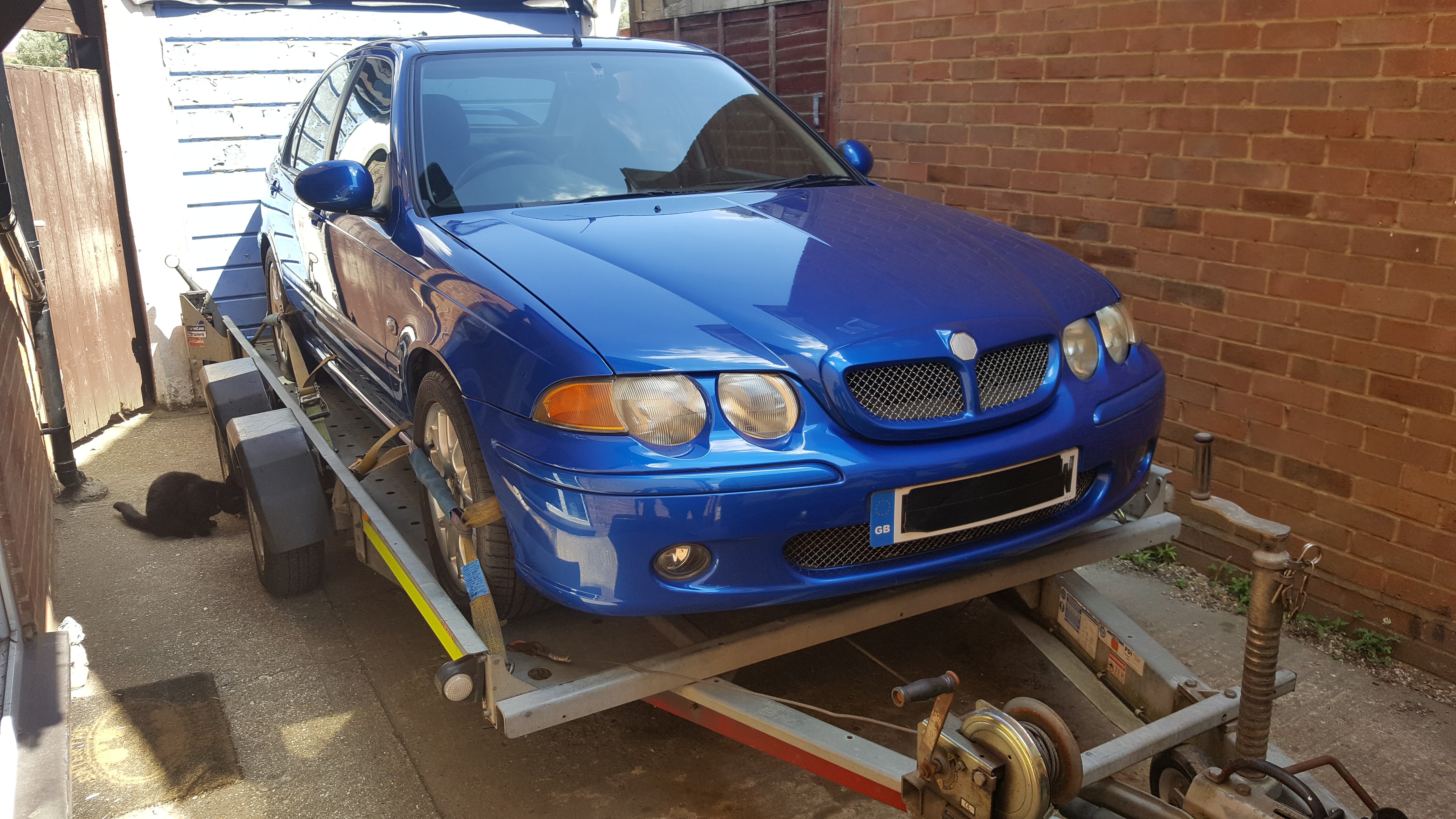

It's on my driveway. Work will commence this week but initial inspection reveals it's an absolute bargain at £200.
Obviously the head gasket on it's current engine is definitely gone, but the rest of the car is proper tidy. Couple of car park dings but the bodywork is very good. It's tidy underneath and even has 4 Dunlops with loads of tread and just over 3/4 a tank of fuel!
The guy that sold it was really genuine and I reckon is going to regret selling it. I'm really pleased though :D

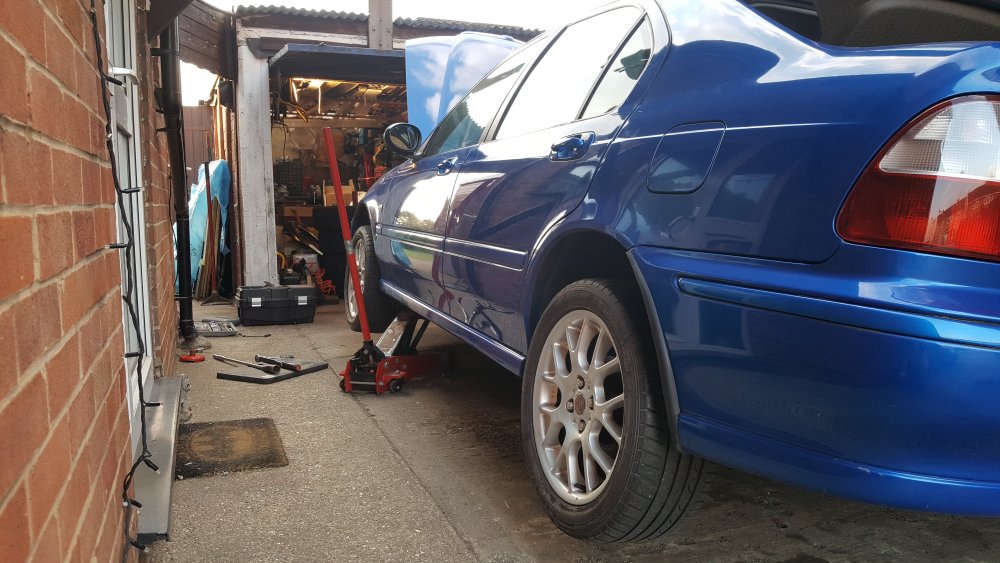

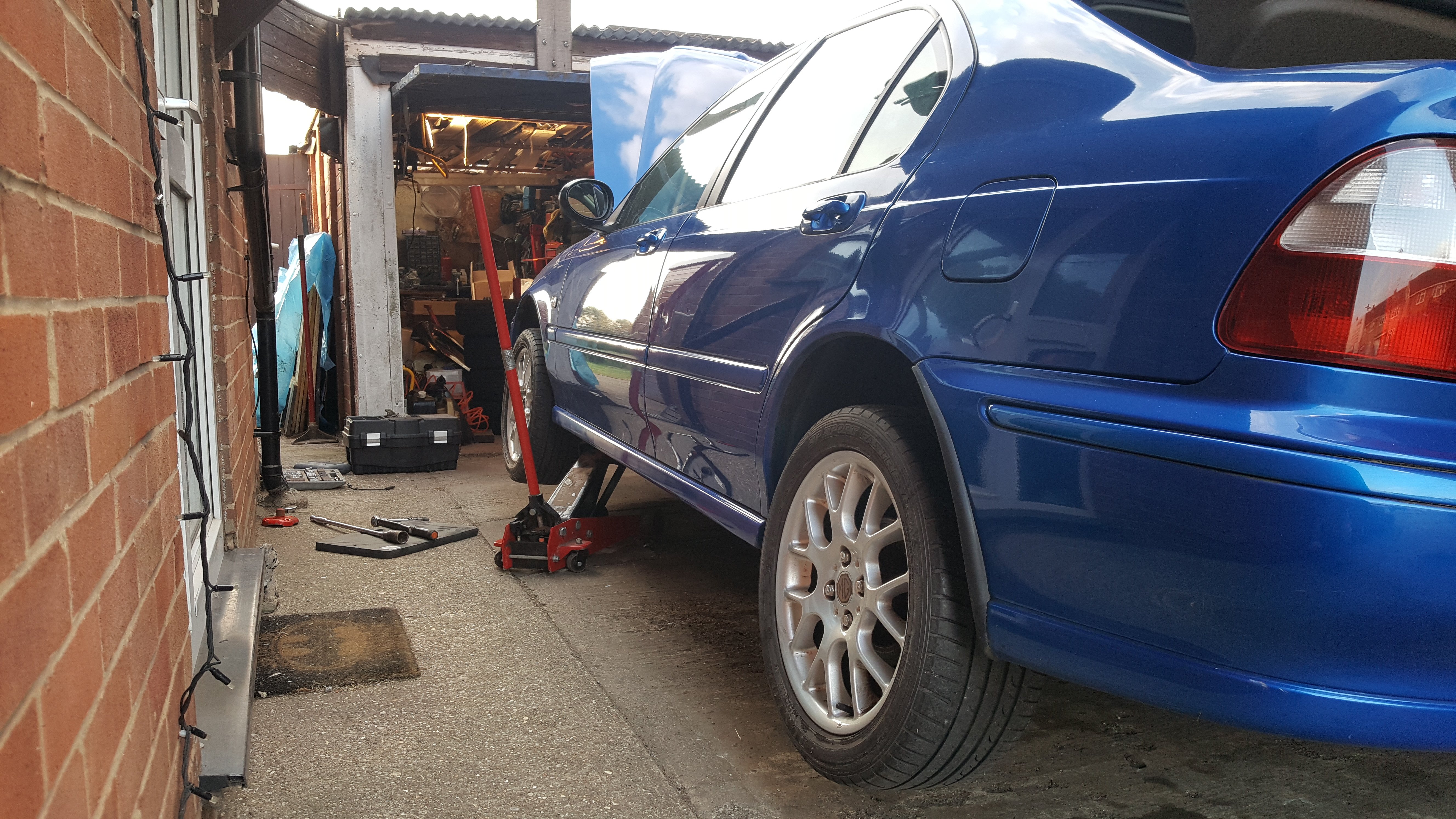

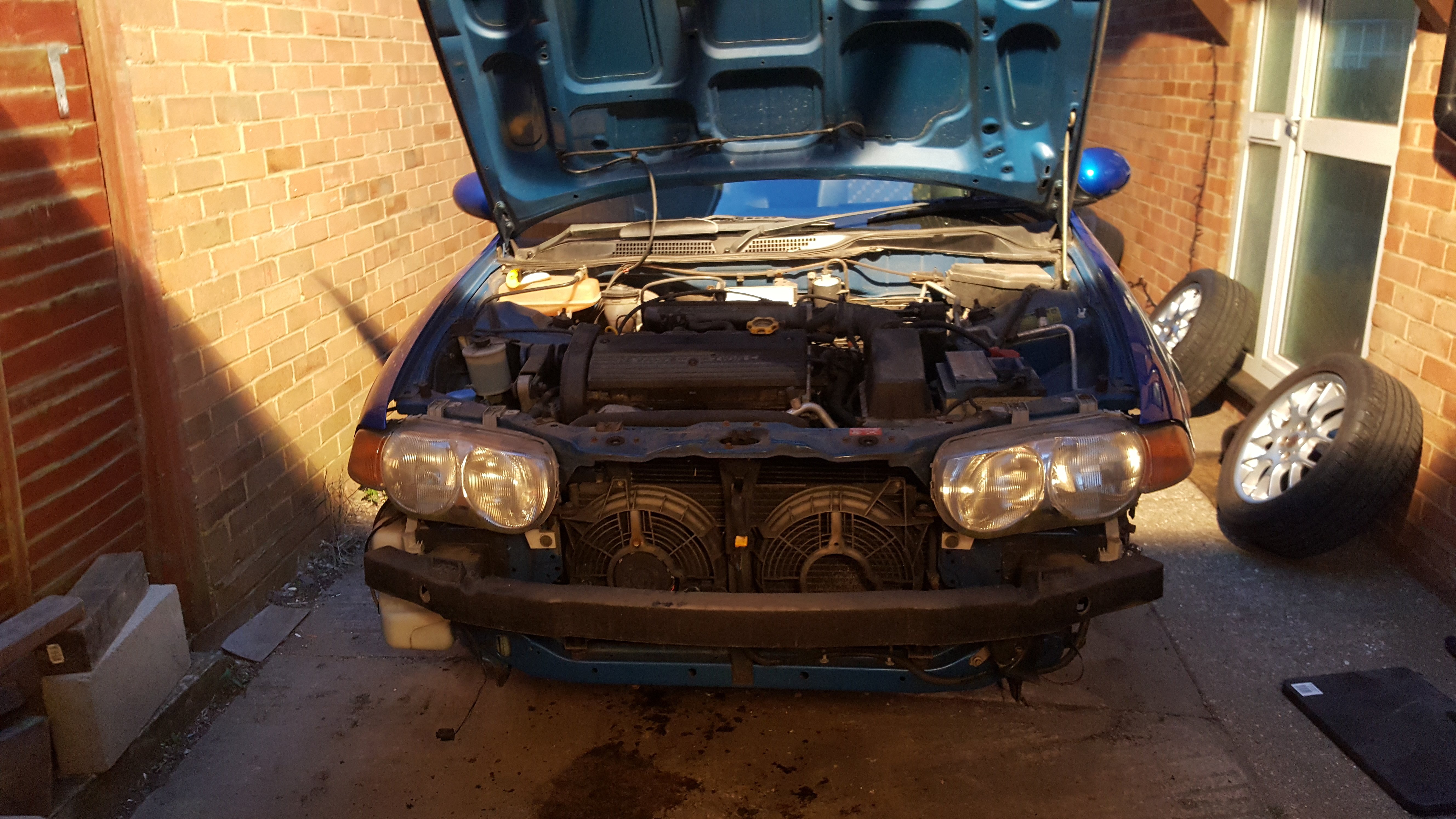

Anyway, I digress. The plan was to get the fluids drained and make a start on stripping out the engine bay in preparation for engine removal. I got the car up on stands. Jacking up revealed its a fairly well balanced car.
I got the oil (read oil as gooey sick like mess) drained out and while that was happening I realised I got it up on the axle stand about 1 inch too far forward so couldn't shut the garage door without scraping the front bumper. I decided the best course of action would be to remove the bumper as I'll need it off anyway at some point.

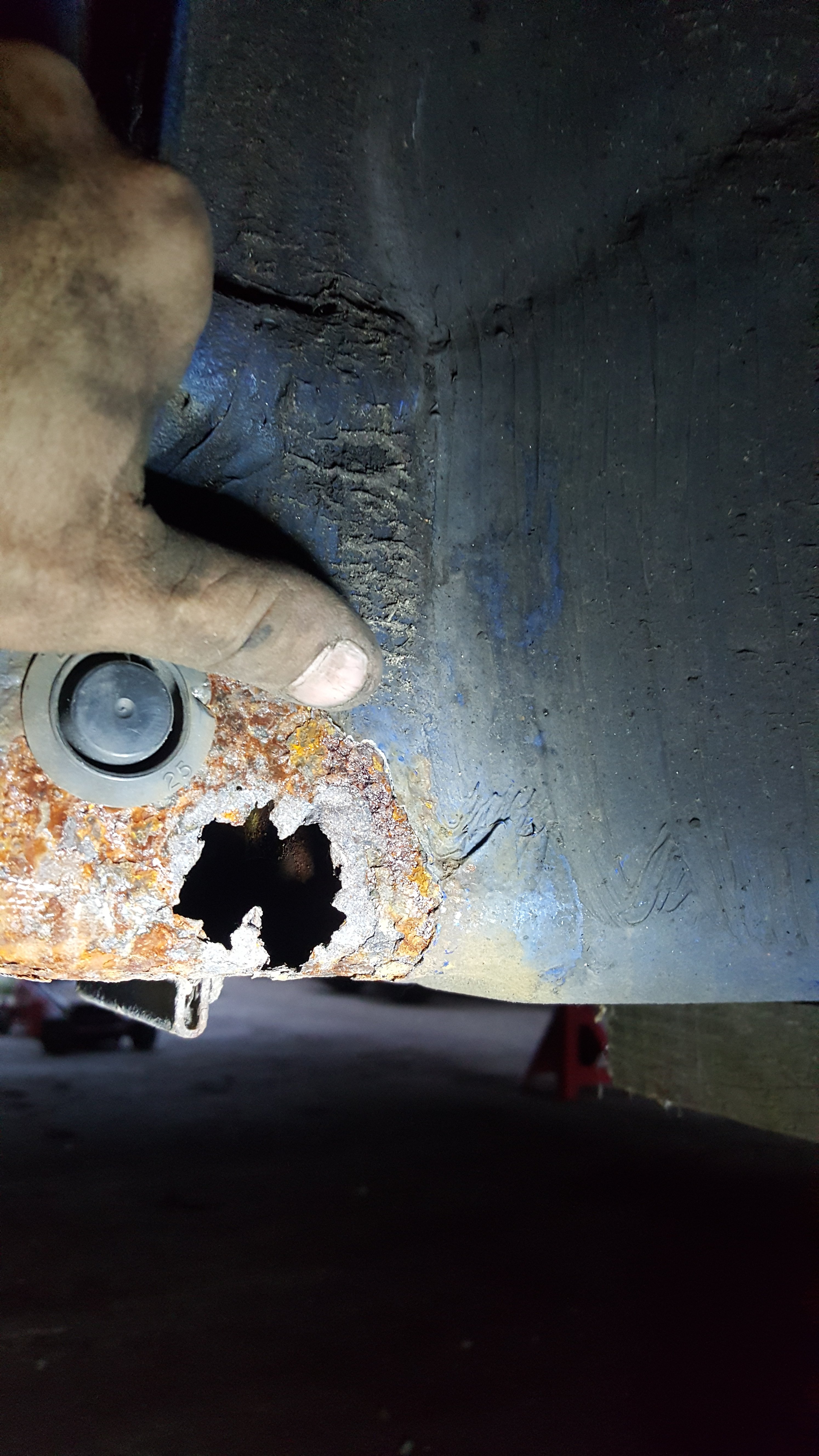

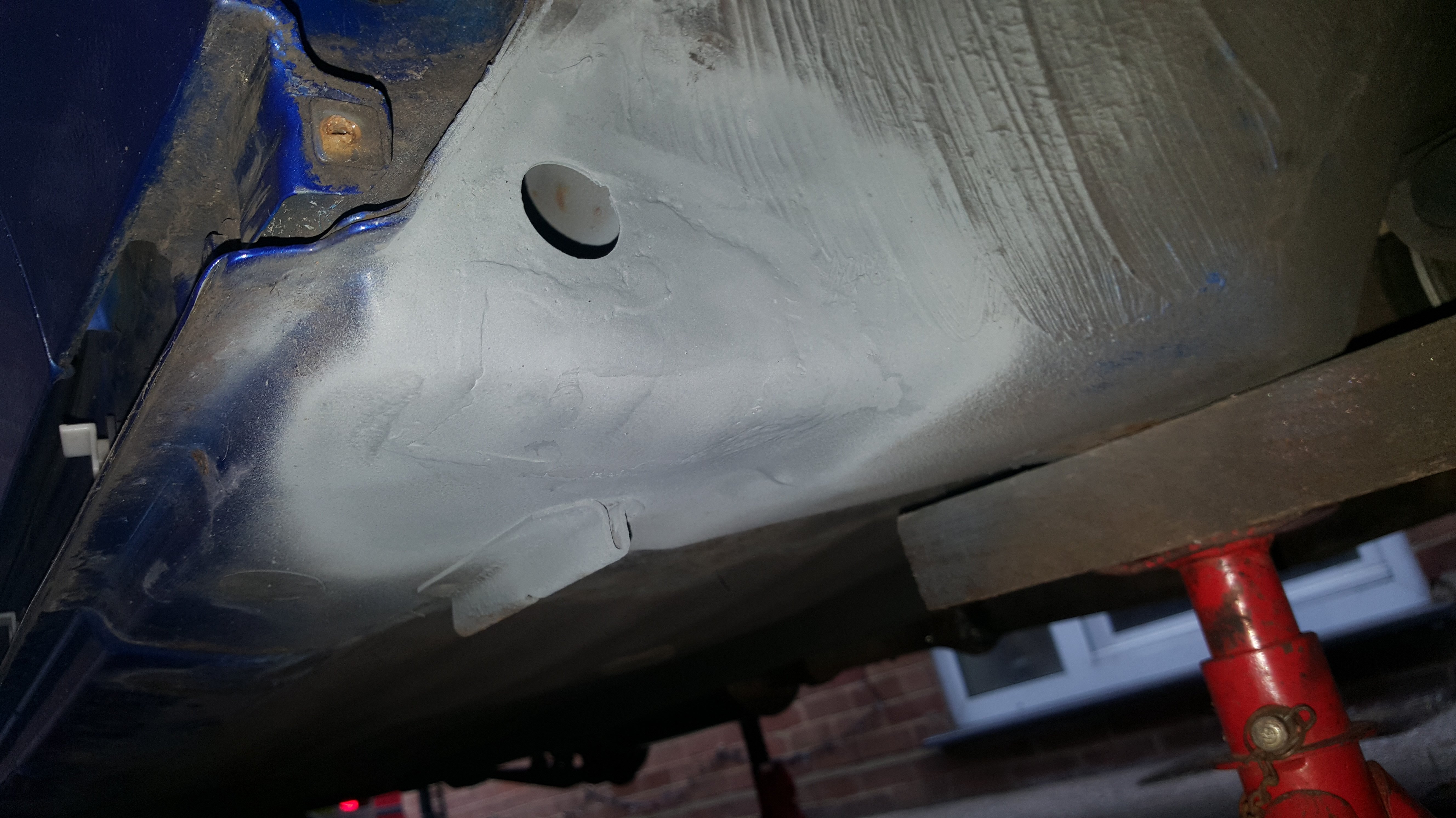

Whilst taking off the bumper, I had to remove the arch liners and while I was at that I figured it a good idea to get the sill covers off and Chechen the sill for any rot. It is a 16 year old Rover after all.
All solid apart from one small hole at the front of the sill on the drivers side. That's only gone as the screws that hold the arch liner to the sill cover are slightly overlong for the application and have been rubbing away the protective coating.
No bother, easy fix. Just needs a small patch welding on and there's plenty of solid stuff around it so I've  booked my brother to come and sort it. He'll do a much neater job than I will.

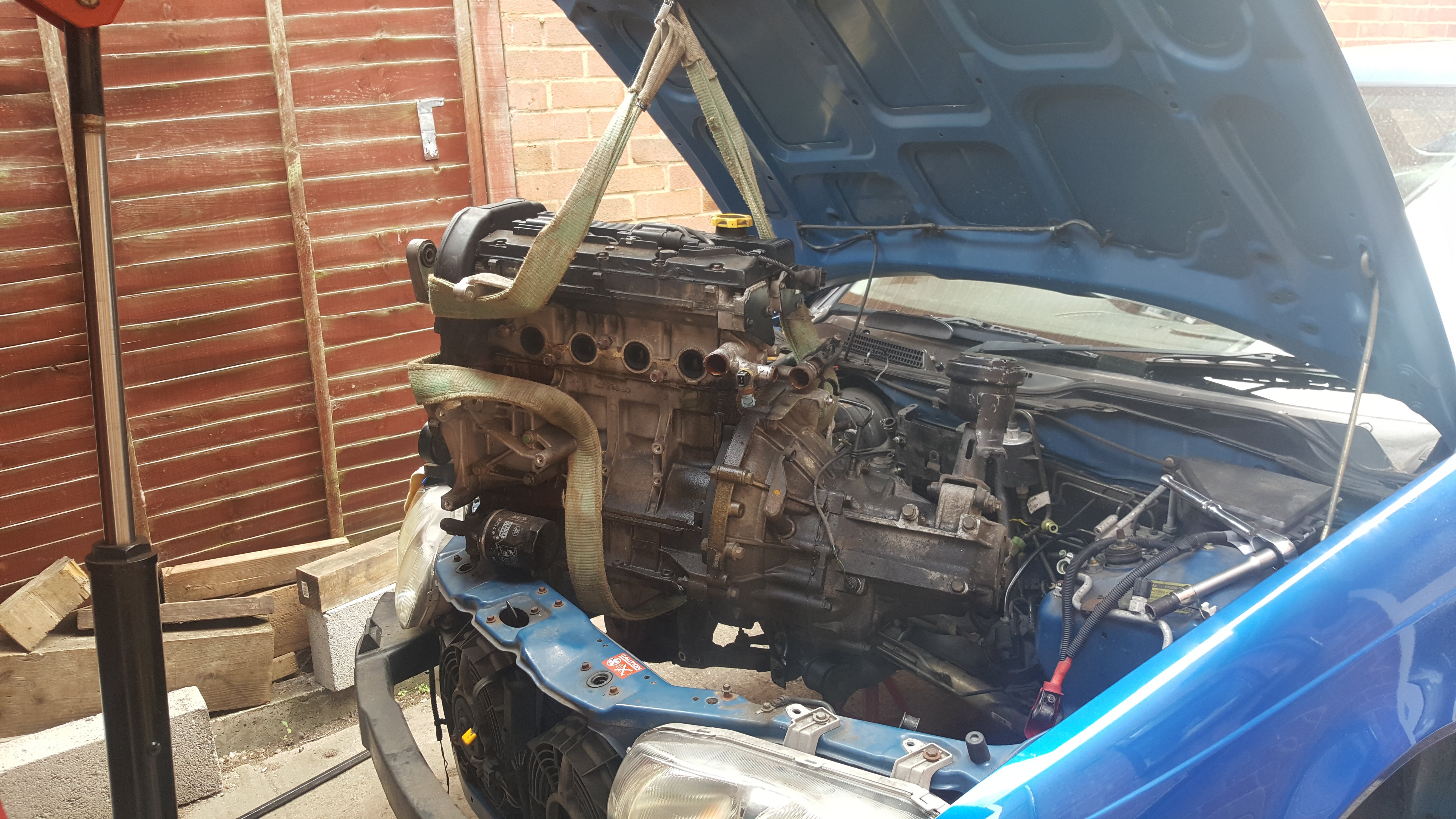

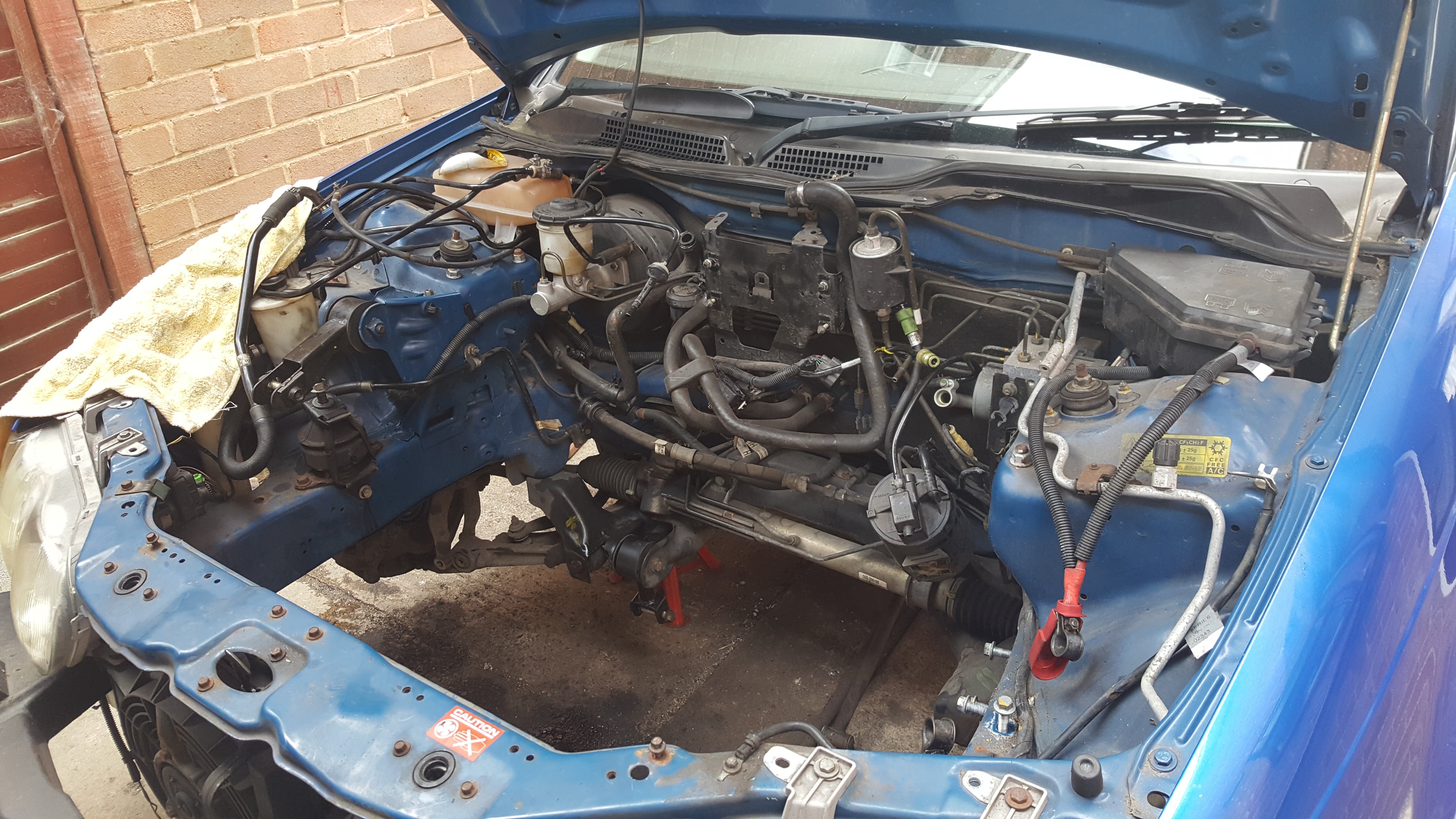

Progress, old engine out :biggrin:

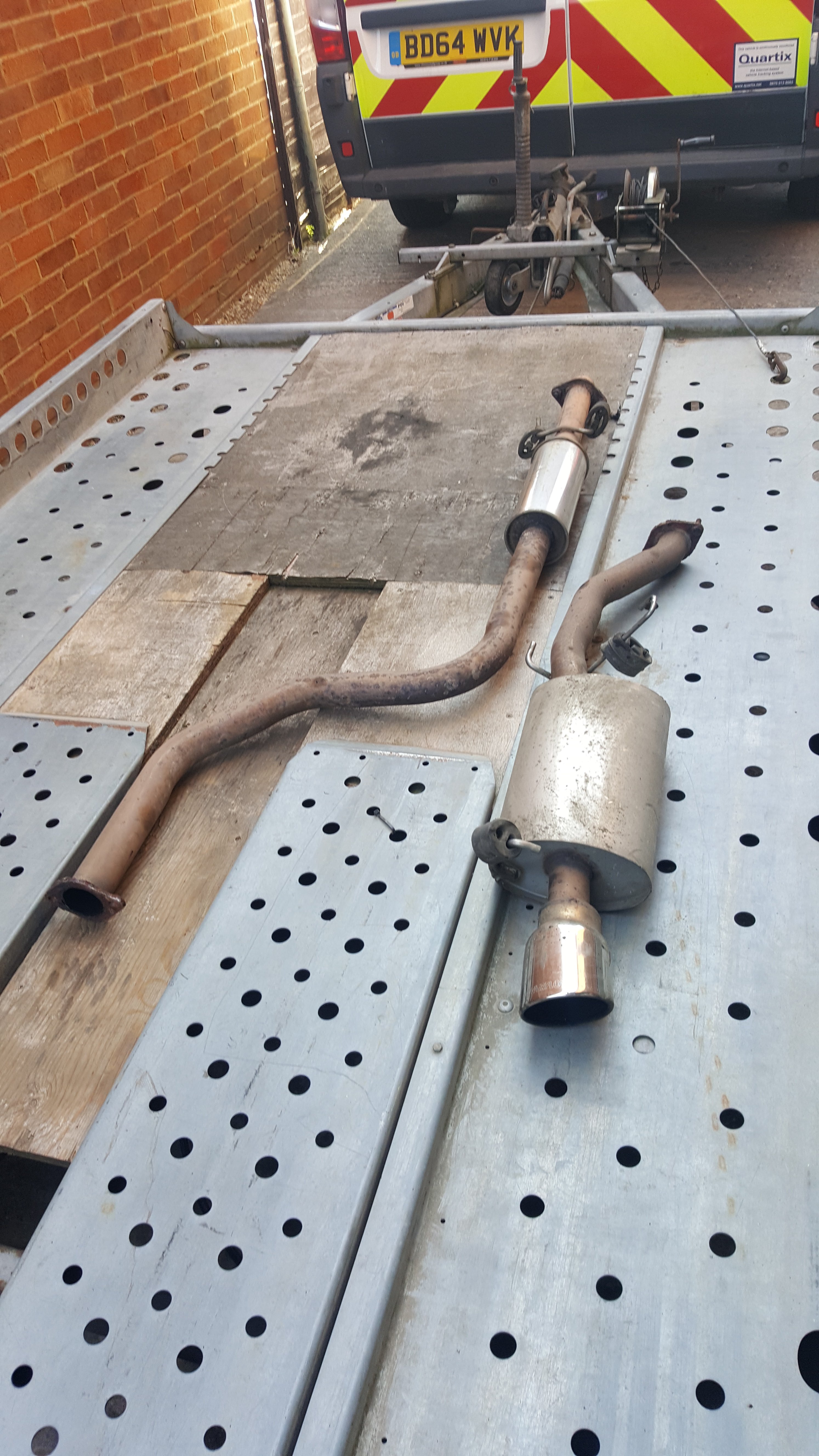

I've compared all the exhaust parts and I think the ZR downpipe and cat may be ever so slightly too short to reach the mid section. If that's the case, I'll just make up a short link pipe.

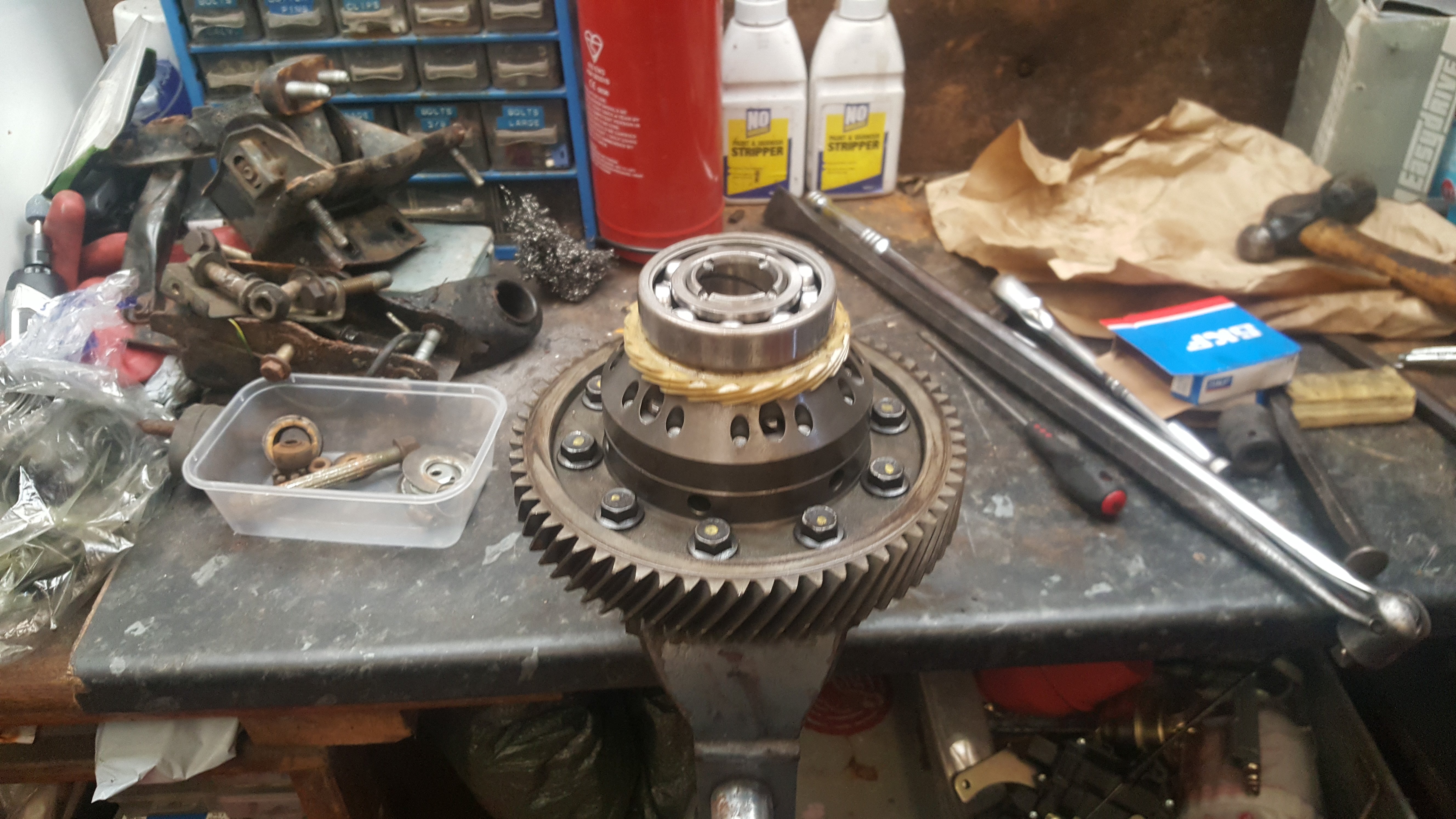

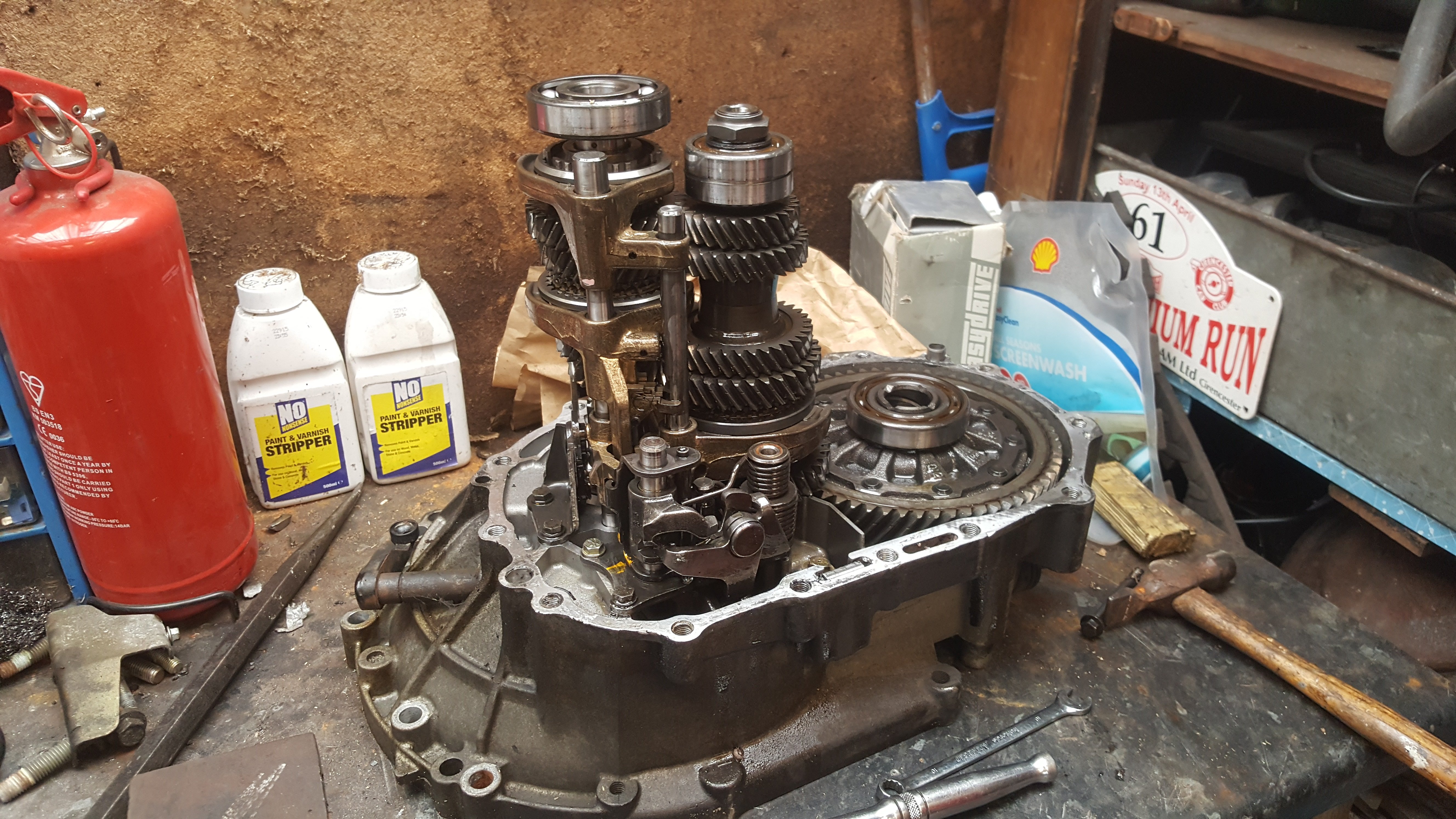

First job was install my Quaife atb diff into the gearbox.  I used the box from the ZS as it's got 30000 less miles on it than the ZR box and the gear sets are the same anyway. I did however, use the final drive from the ZR as it's 4.2 opposed to the ZS' 3.9 so I'll get the slightly better acceleration.
Once the box was back together, it was on to the last job on the engine before it would be ready to go in.

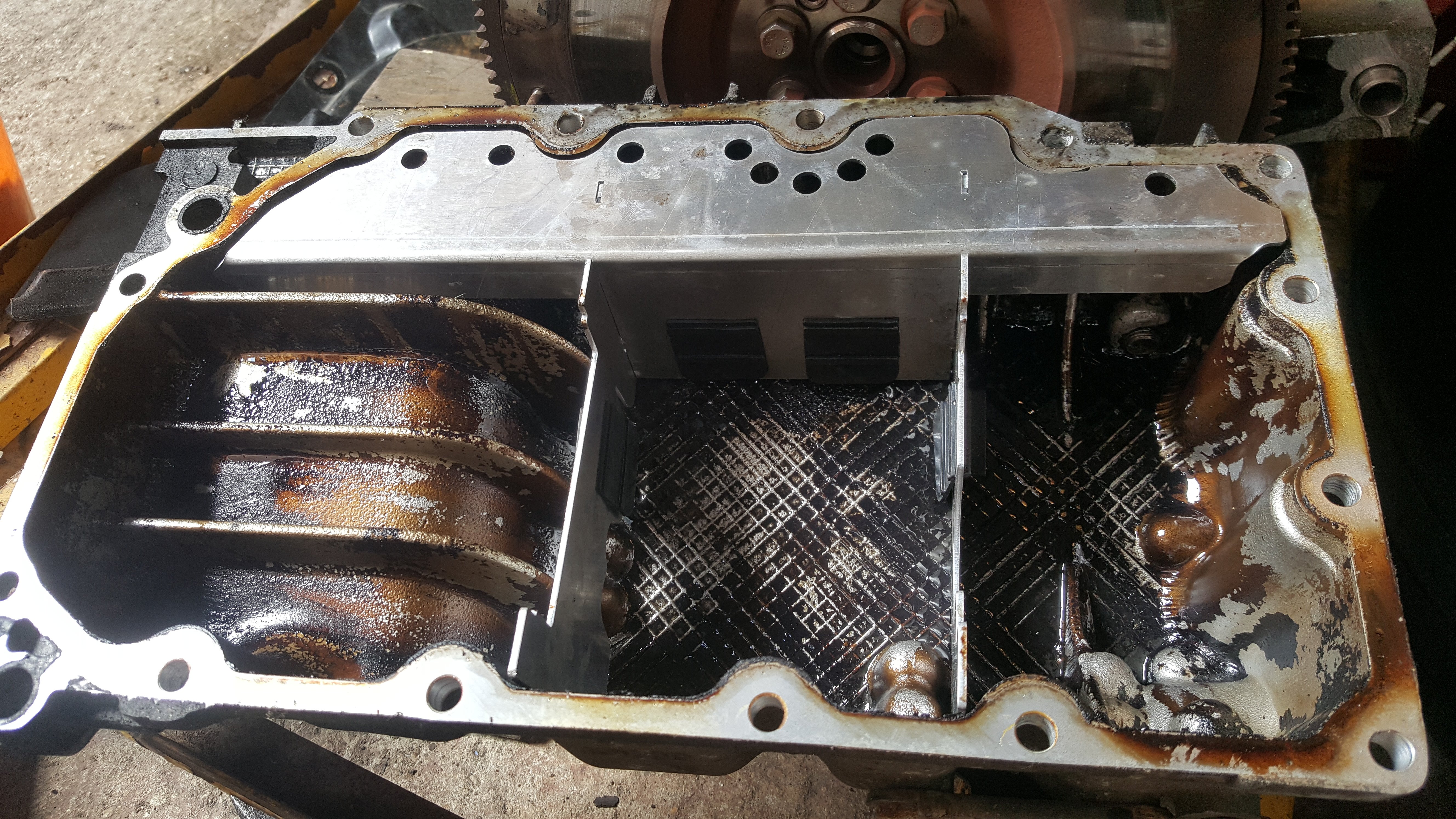

I needed to install my sump baffle. I've bought a slightly better one that I had in the original Brisk Rover, this one also has little flaps to help keep the oil around the pick up.
Once the sump was reinstalled, I bolted the box back on, swapped the ZS mounting onto the ZR engine and got the engine crane out. It all dropped into the bay nicely and is all mounted up.

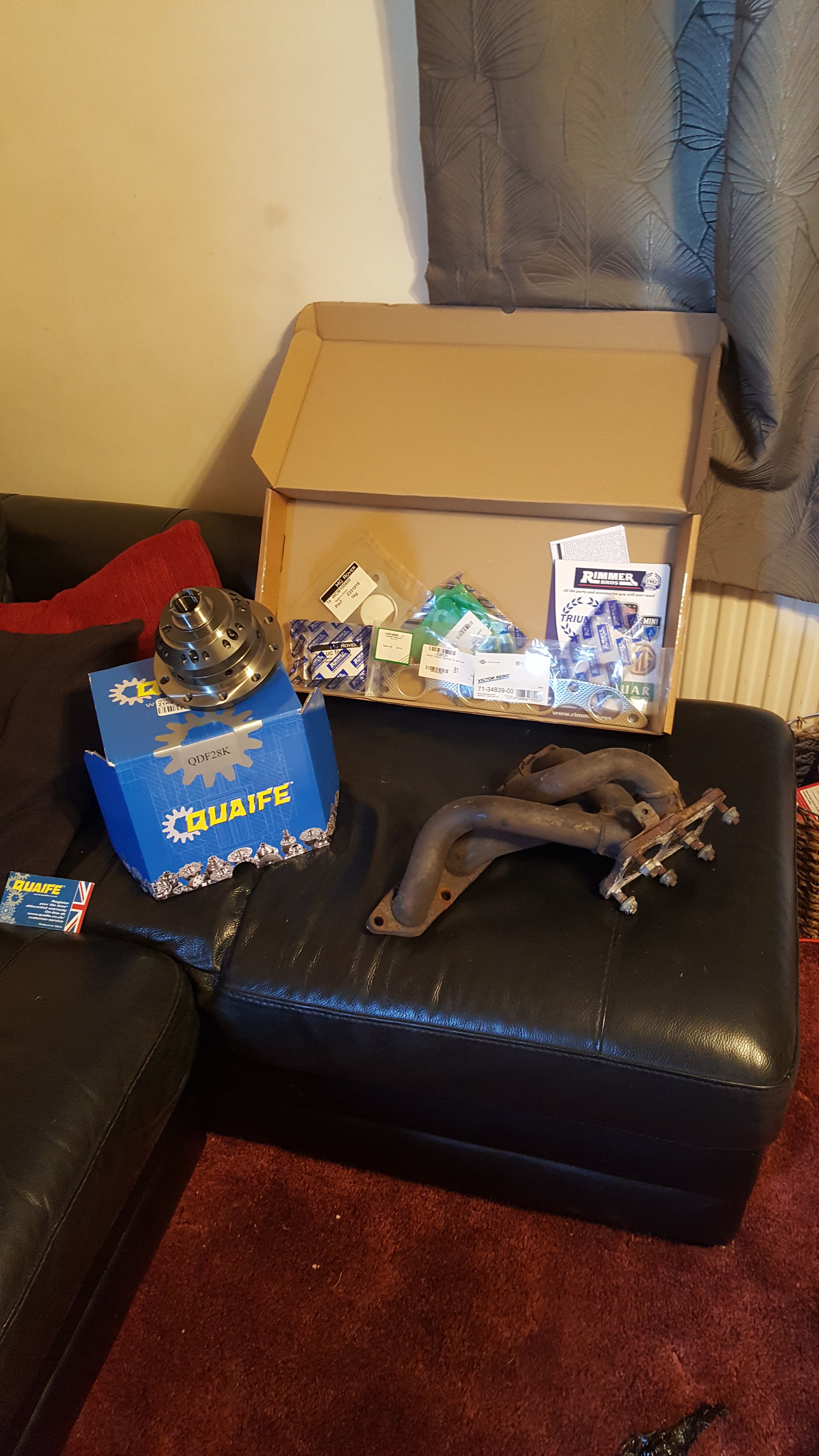

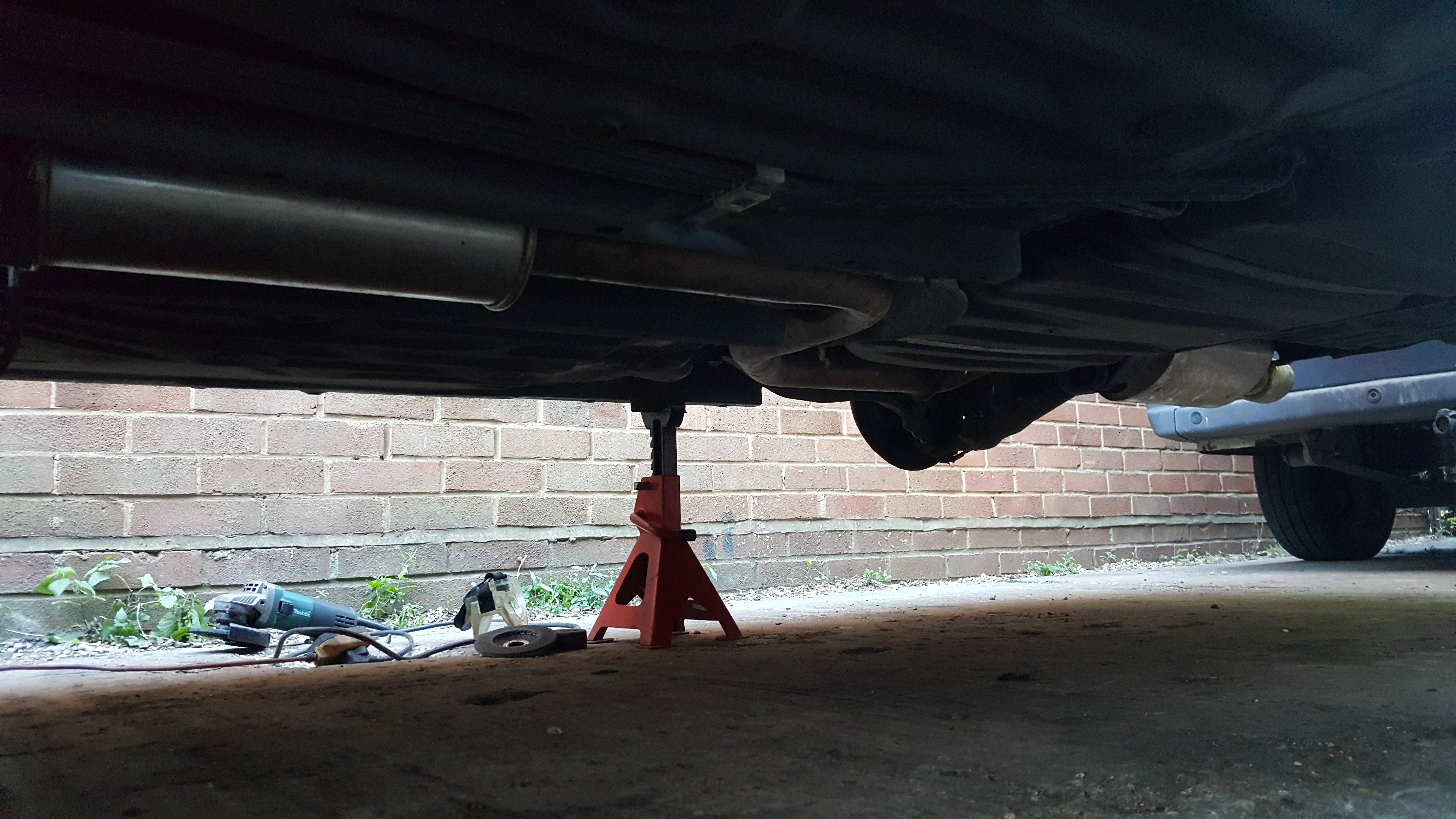

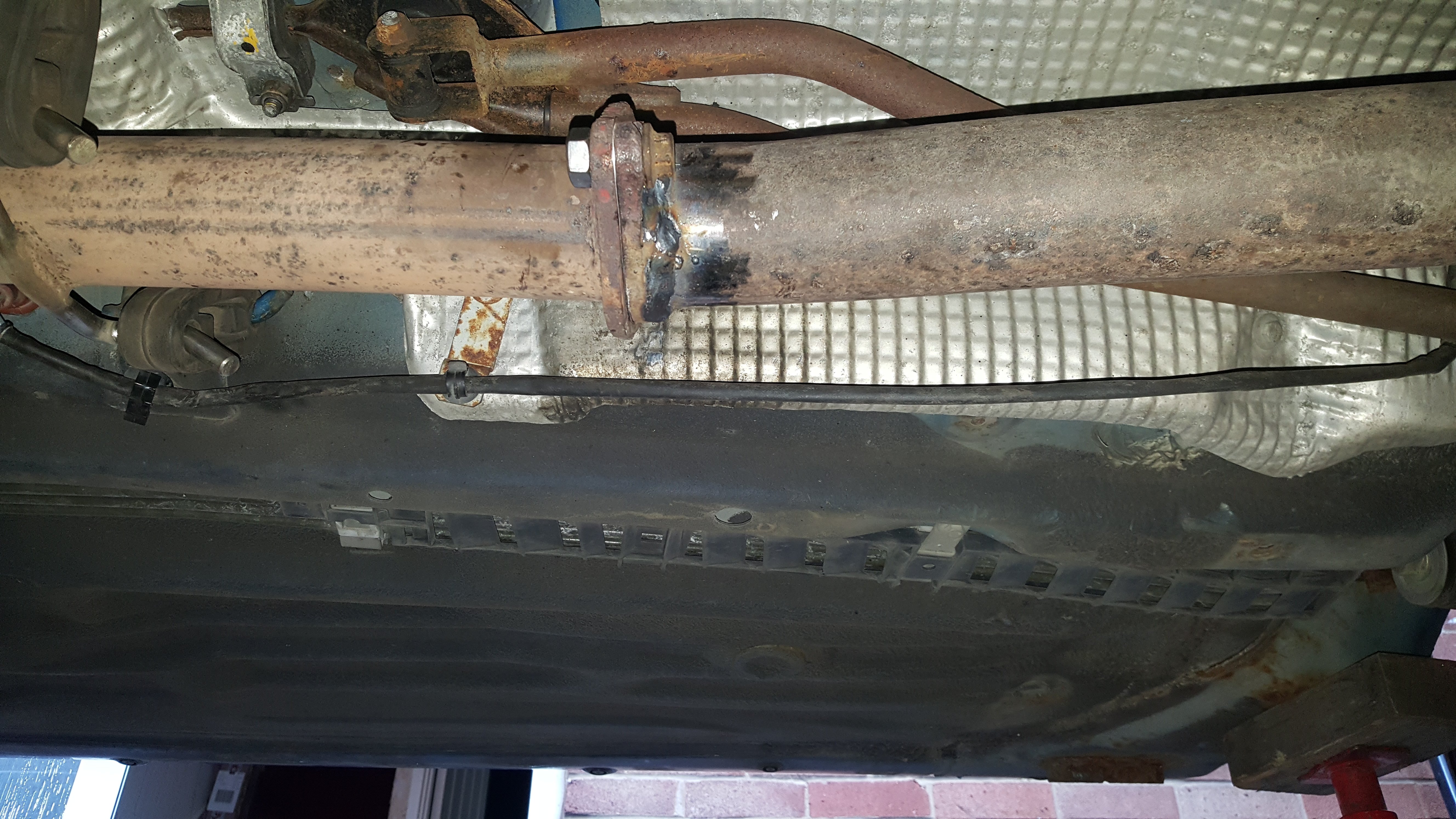

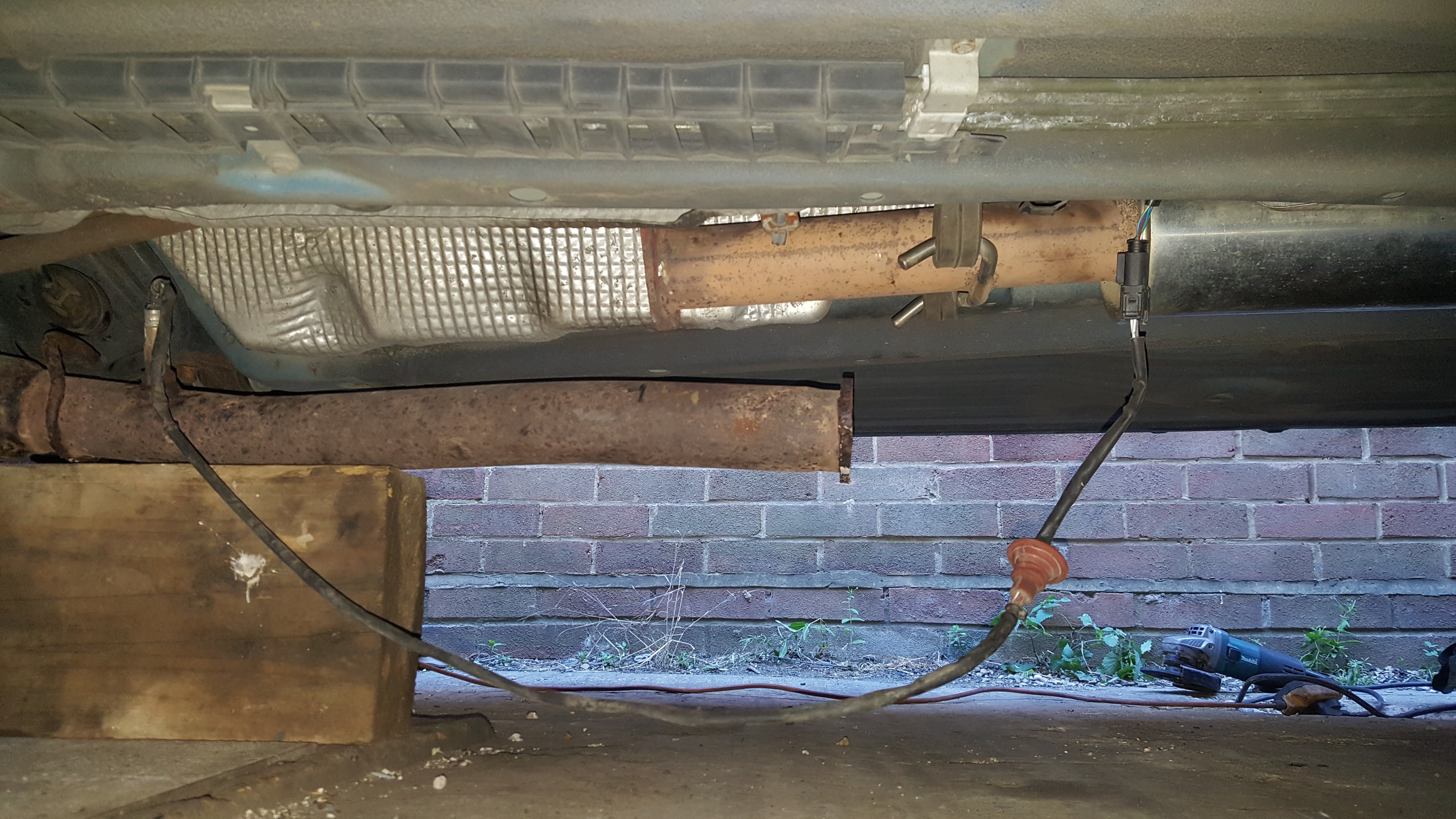

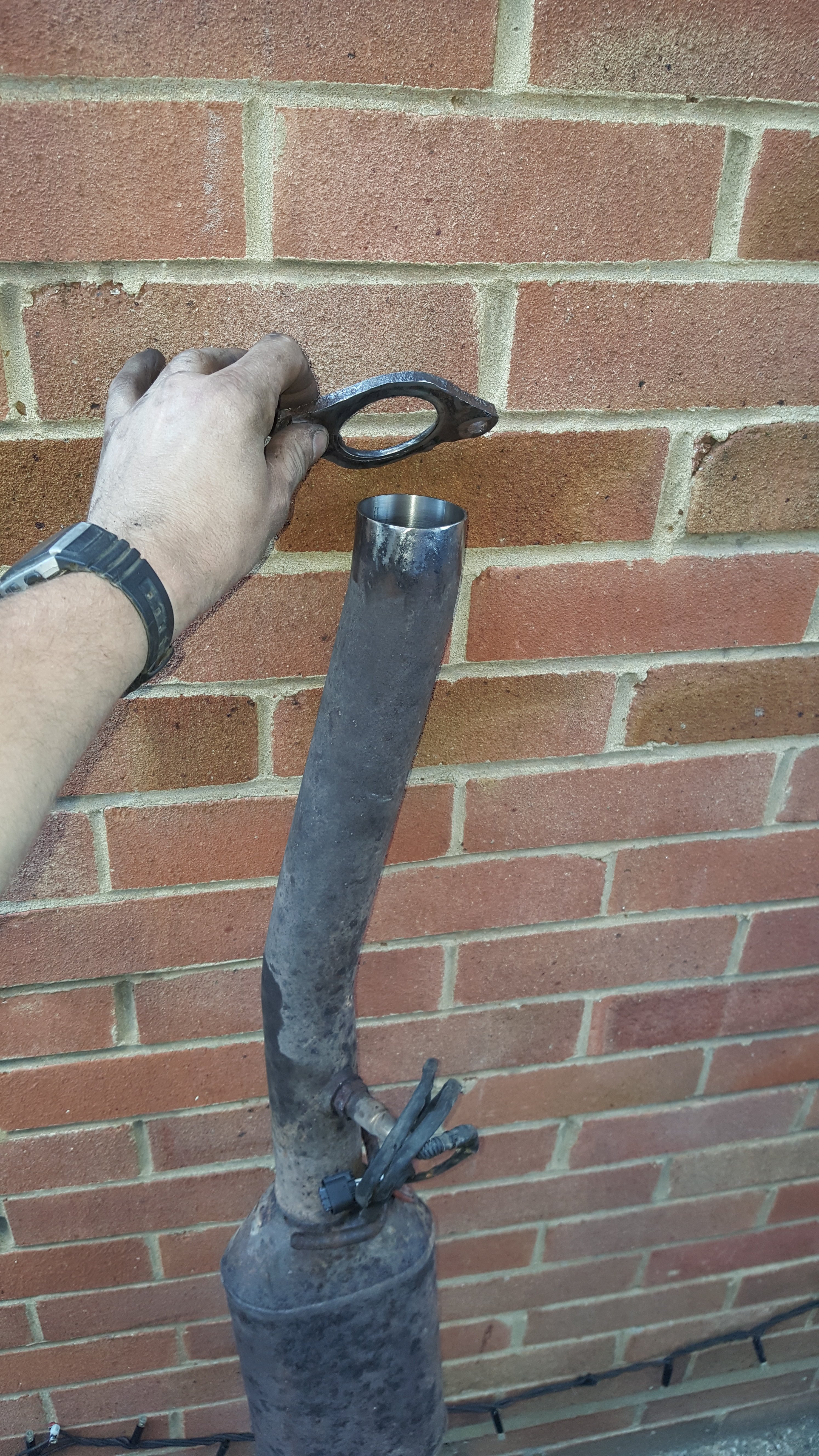

Fitted the Powerflow cat back with no issues.
But when I came to fit the downpipe and cat from the ZR, which I thought would be too short, it actually turned out to be too long.
No matter, that actually makes things a bit easier.

Well, i never said my welding would be pretty, definitely more function over style, but the exhaustis now sorted.

Whilst away on holiday, the welding fairy paid a visit and sorted out that little hole on the end of the sill.

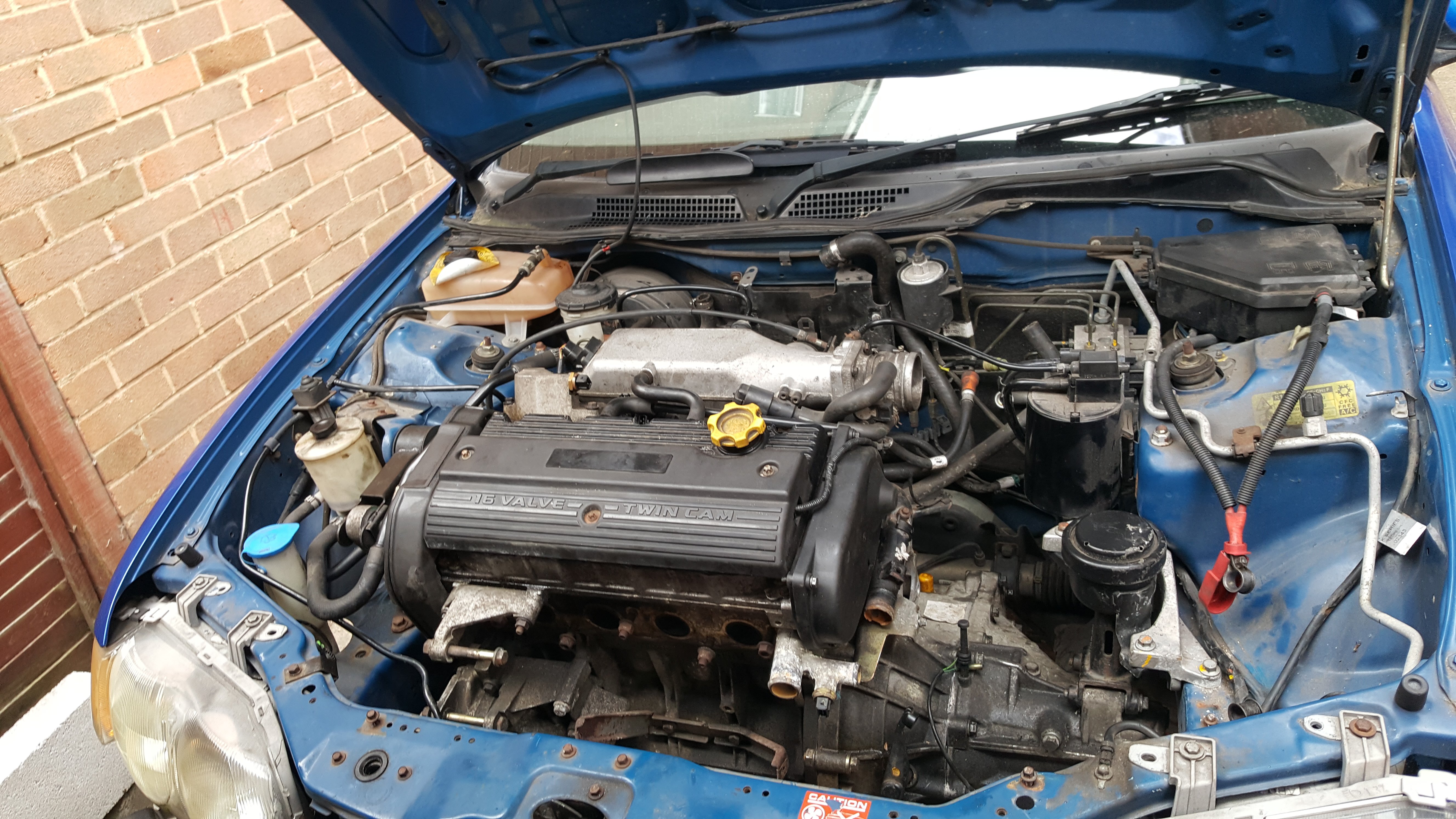

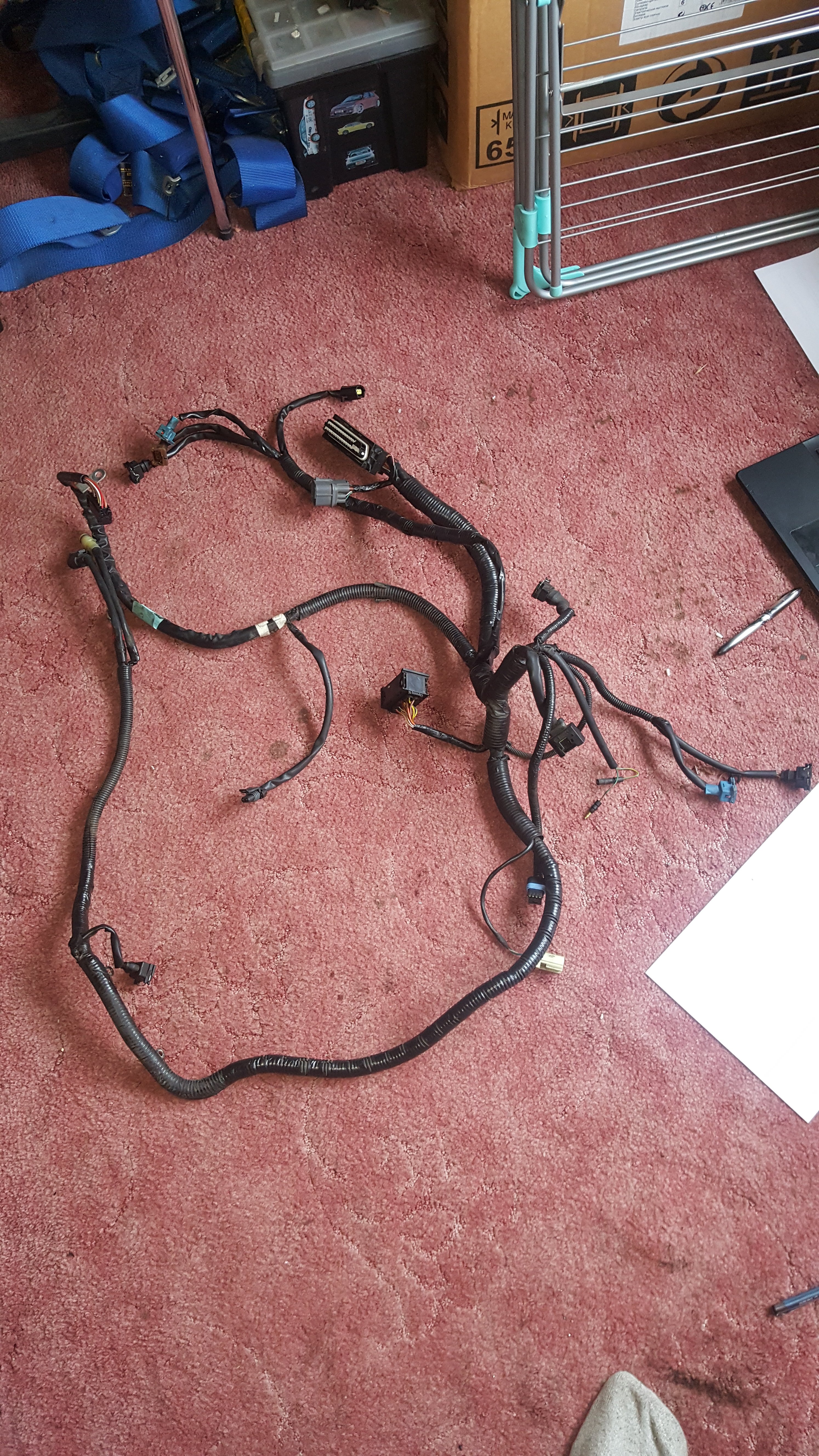

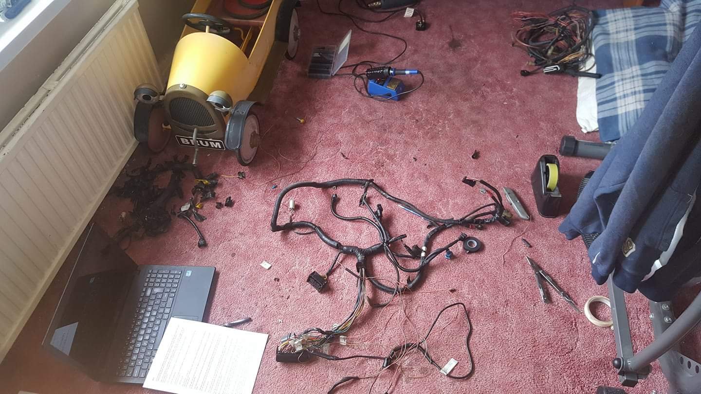

First job for me today was make the necessary engine loom edits.
A fairly straight forward exercise in the end. Basically just needed to take the 3 plugs for the vvc mechanism and the plug for the camshaft sensor from the ZR loom and add them into the 120 loom. I followed a guide I found on a Rover site and did a better job. Instead of cutting and soldering every wire it was easier to just remove and replace the pins in the ecu plug. This meant there was only 2 wires which actually needed splicing and soldering.
Once everything was attached, it just needed the sleeves and tape replacing to neaten it all up.
With the loom sorted, I was keen to see if it works so I plugged it all in to the engine, filled the engine with oil. Before I could give it a try, I need to swap the alarm/immobiliser box for the one matched to the ecu. That was a ball ache as it means the centre console fascia had to come out to get access to it. I  the old Brisk Rover, this box is much easier to get to underneath the dash above the pedals. I've slightly moved this one so that I can now get to it without having to take half the interior apart.
So with this done it was time to turn the key.
Looks like I got my loom right as it fired straight up :D
Didn't run it for long as I haven't reattached any of the cooling system yet. The tappy noise is just the hydraulic tappets which should settle down once it gets a bit of running. That Powerflow exhaust sounds nice though.
