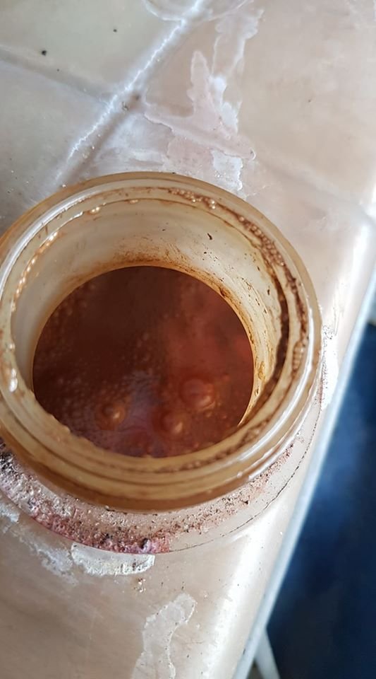

So with the manky coolant in the header tank, I thought it was going to be head gasket time but fortunately it turned out to be just a bit of dislodged muck from somewhere deep in the cooling system. A good drain, flush with a dishwasher tablet and refill has sorted it with no futher problems. Gearbox issue was sorted fairly easily too by cobbling together a good box by using good bits from 3 boxes with different problems.
With competitive motorsport still on hold due to the 'rona, the car has barely turned a wheel. I ported a spare exhaust manifold I had so hopefully a bit of improved flow. I've also sorted out the old tired bushes on the rear arms. A fresh set pressed in and the whole thing feels a lot more stable. Not surprising as one bush was completely no longer attached.
