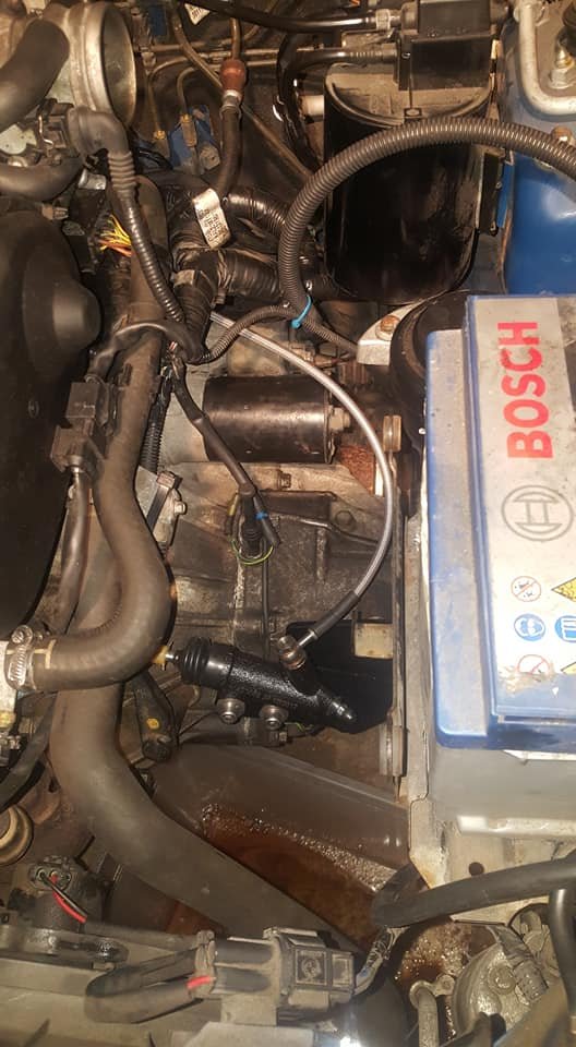

Been a while so I'd better do an update. Been a bit busy with this that and the other.

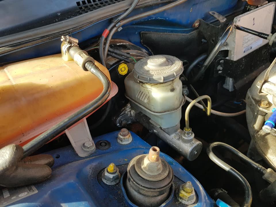

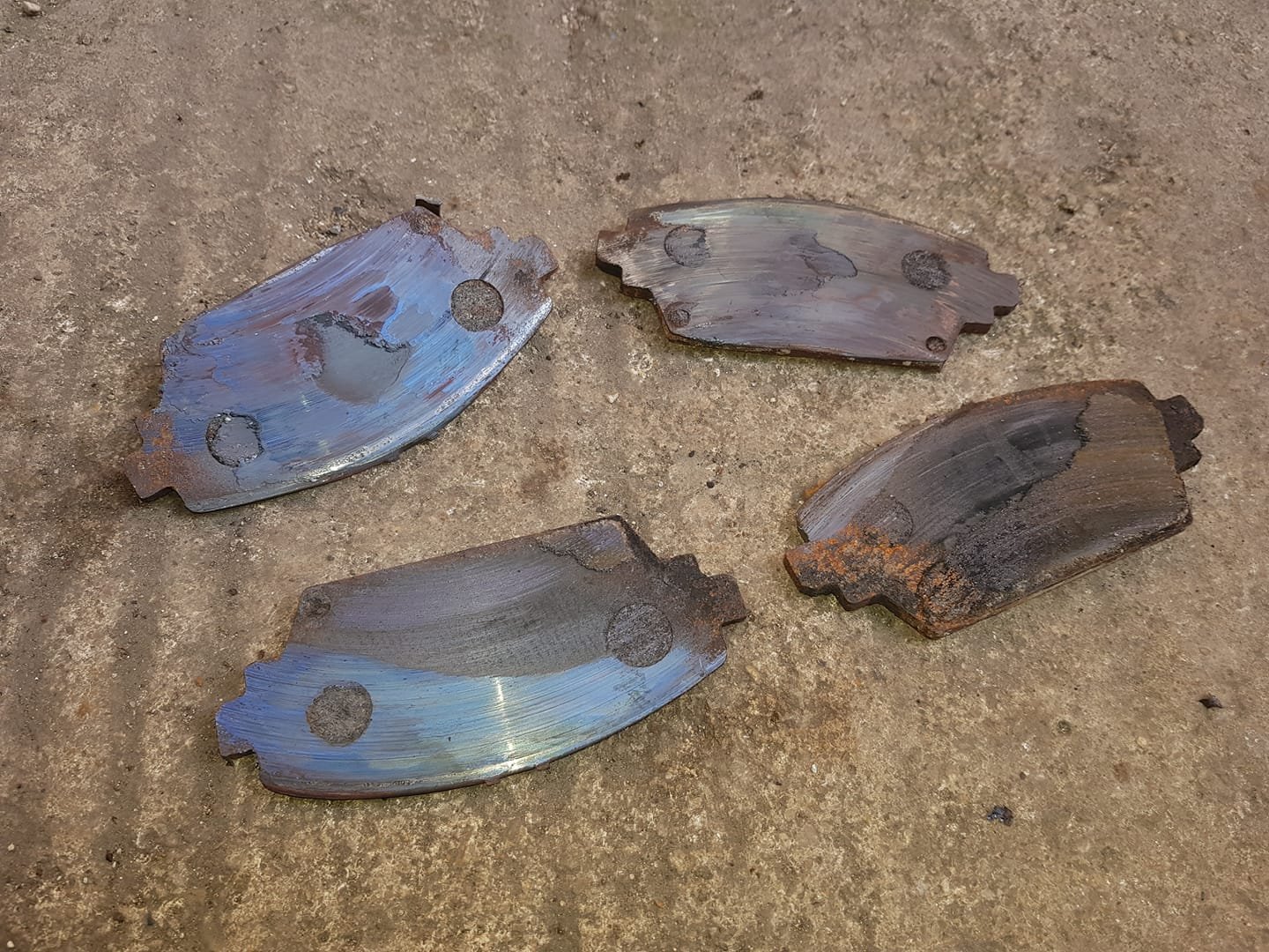

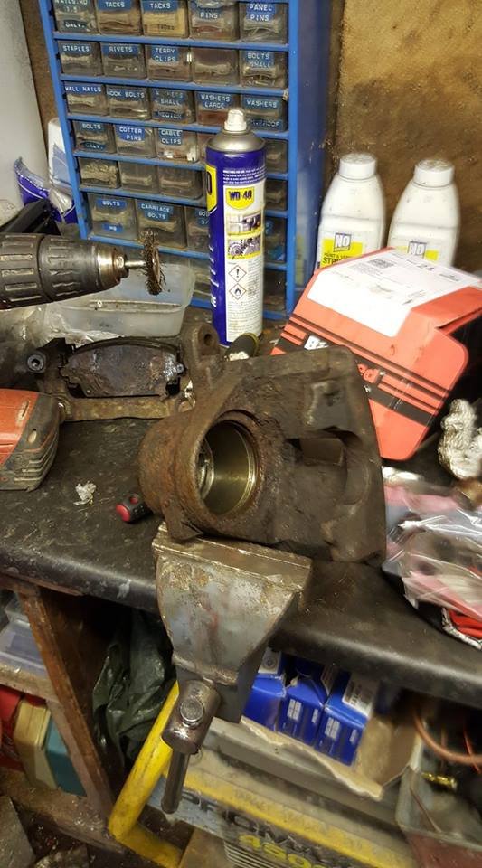

Since last time, I'd been having a bit of a mare with the brakes. I put all the larger 160 stuff on, bled the system a lot but just couldn't get a decent pedal feel. They worked, but the pedal was so long and never felt as hard as it should. I narrowed it down to the front calipers by clamping the brake hoses. Upon stripping the calipers, I found the pistons to be heavily corroded so a rebuild was in order.
New seals and pistons solved the soft pedal problem but the pedal was still longer than I would like. I eventually found that there is an adjuster between the brake pedal and the servo so it was a case of turn that until the brakes were just starting to apply themselves and then back it off slightly. Yay, working brakes!

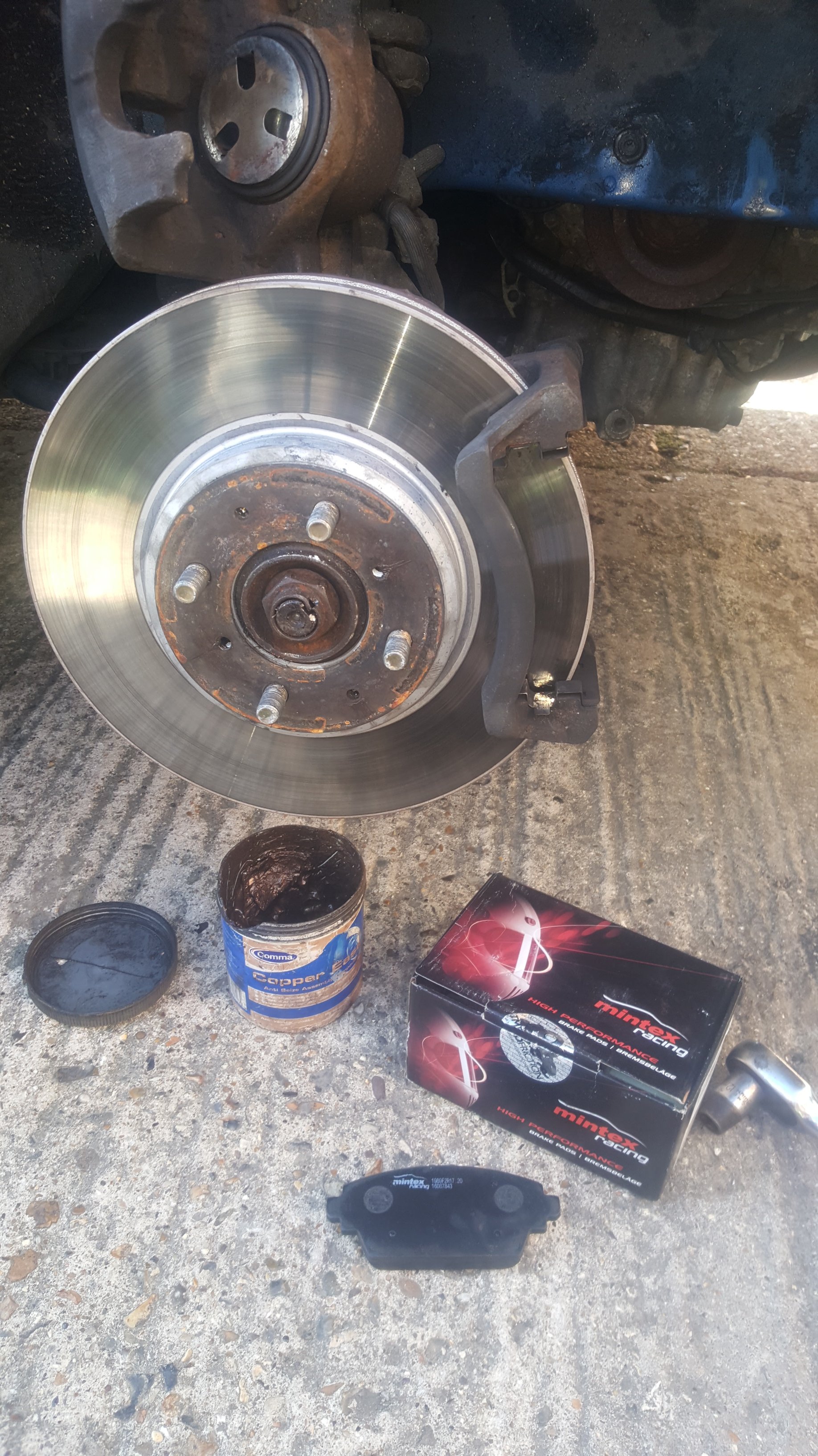

Just a small job on it today. With a track day coming up at Snetterton in a couple of weeks I thought it best to throw in a set a decent pads. I usually like to use Tarox Corsa. 401 but they're very expensive for my application and will take about a month to get them made and then shipped in from Italy so I've opted for some Mintex racing pads. Still not cheap, but available off the shelf.
They're feeling pretty good, biting nicely straight away so should be pretty good when they're fully up to temperature.

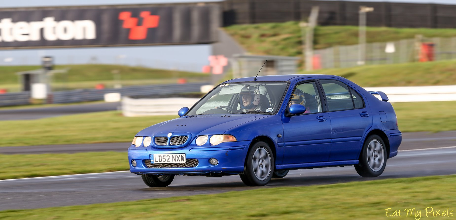

Track day at Snetterton went well, car performed perfectly all day and was great fun to drive. Not the fastest car out on track but it was out handling lots of things through the corners so was more than capable of keeping pace.

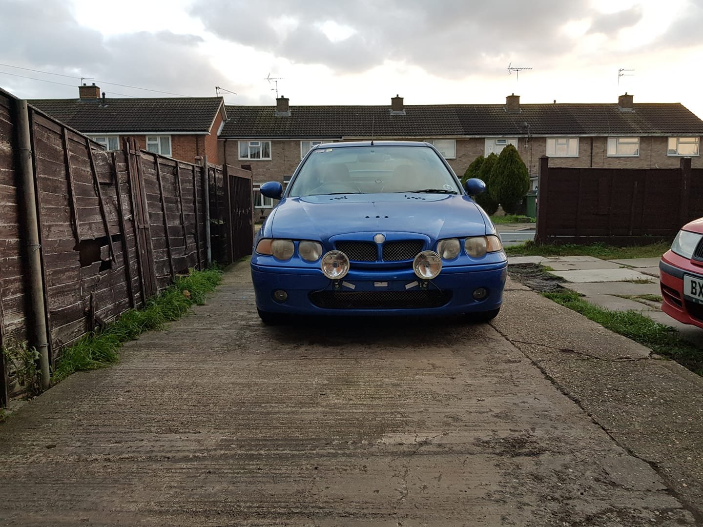

With that sorted, I turned my attention to a necessary upgrade for lighting up the lanes on night events

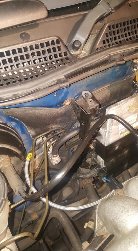

There's not a great deal behind the bumper to attach to apart from a plastic crash bar. It is quite thick though so I've managed to drill right through and affix the brackets with some long M12 bolts and big spreader washers. They seem surprisingly sturdy so I may even get away without needing steady bars but I'll make that decision once I get a chance to test them. I'll even be able to get the number plate back in place between the two light brackets, I'll just need to cut it down slightly and lose the GB badge off it.
Currently part way through the wiring but had to down tools for the night as it was dark, cold and it took a lot longer than expected to get the wires through into the cabin for the switch. Ended up having to remove the glove box and then unbolt all the heater gubbins to move it just enough to get a hand in and grab my poking rod and then pull the wires in.
I'll continue in the morning once the sun returns and I can see what I'm doing properly.

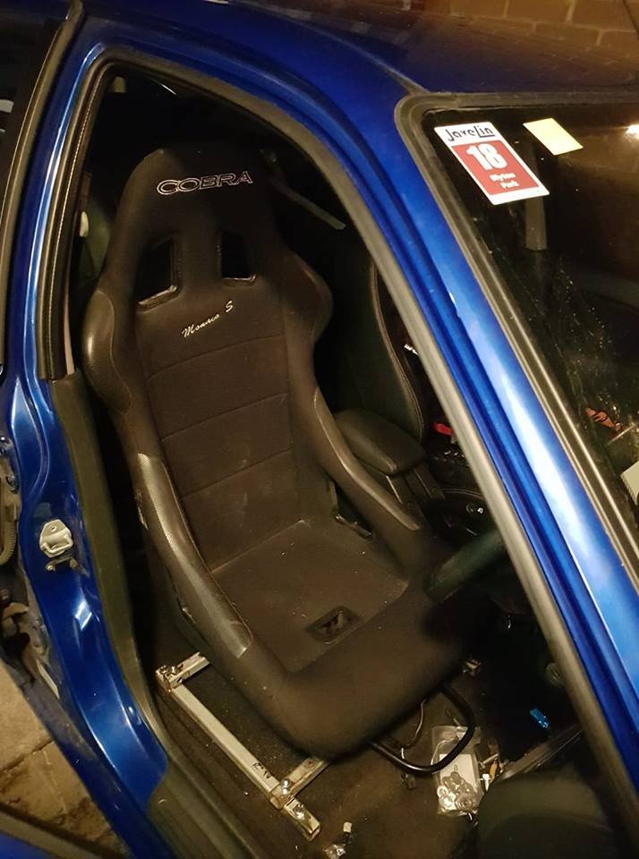

After that track day, I found some time and turned my attention to fitting the bucket seats and harnesses that have been taking up space in my half built dining room. Frames fabricated and all bolted together and in it all went. Drivers side is on a sliding mount so my munchkin of a girlfriend can still reach the pedals when she drives it and the passenger side fixed in one position.
buckets.thumb.jpg.fcb8f4c95188c364d266f8fa470a423b.jpgharnesses.thumb.jpg.de43bcd56e26b268a2c45c7ebd1516b9.jpg
Much nicer being held in the car so you can focus more on the driving rather than not falling out of the standard seats.

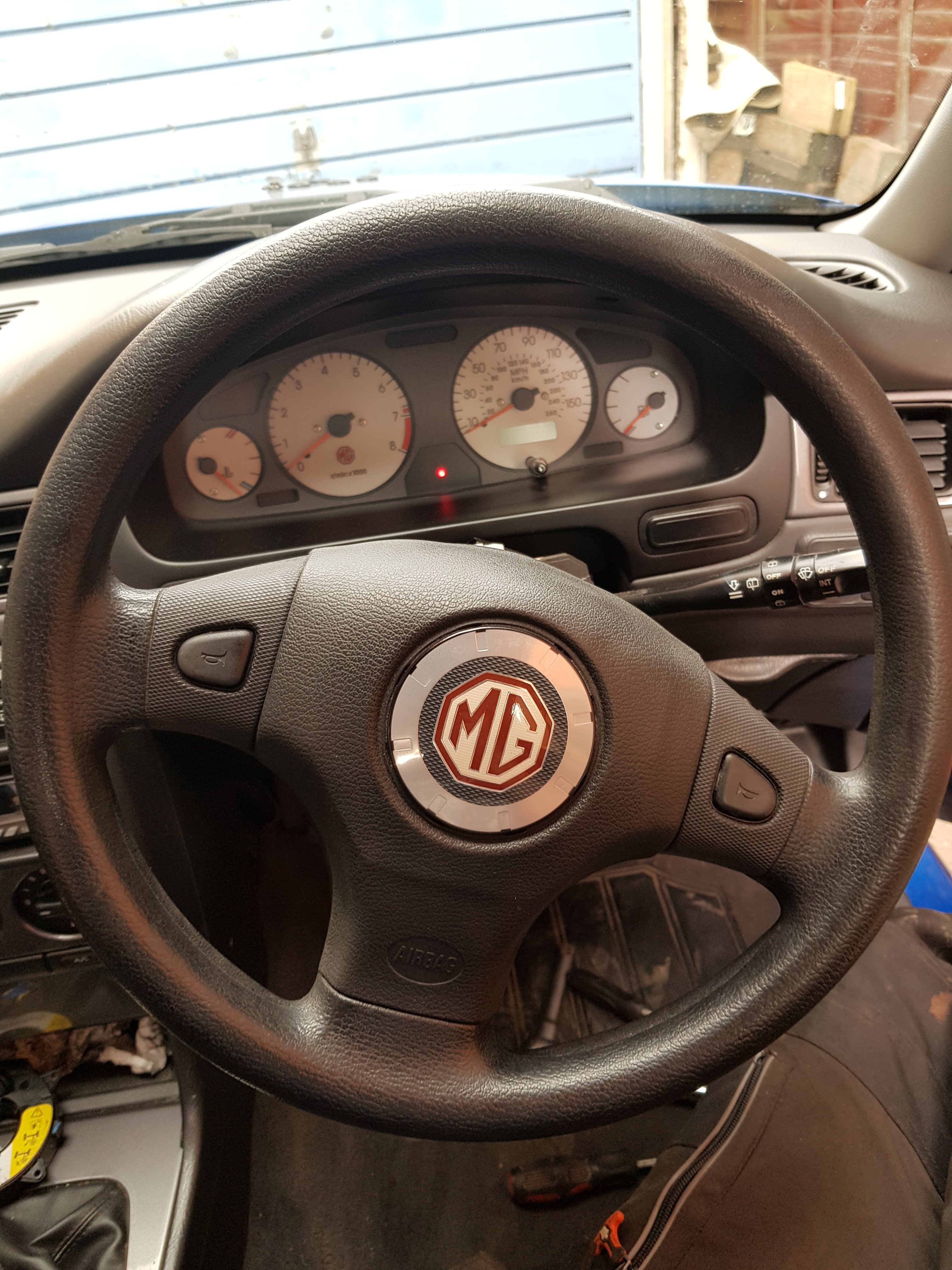

First up was fit my new steering rack to get rid of the comedy turning circle. Got a refurbished rack from a Rover 45, which whilst it adds a turn going from lock to lock, it gives more lock, taking a metre off the turning circle which is ultimately more important to me.
Whilst putting it all back together, it turned out that the squib ring behind the wheel wasn't centred so the extra turn broke it. No matter, quick trip to the scrap yard the next morning for a replacement. Whilst I was there,  I managed to pick up a tidy leather wheel as an upgrade for the plastic one the car came with.
Feels much nicer and not having to do 3 point turns to getting into parking spaces is a massive improvement.

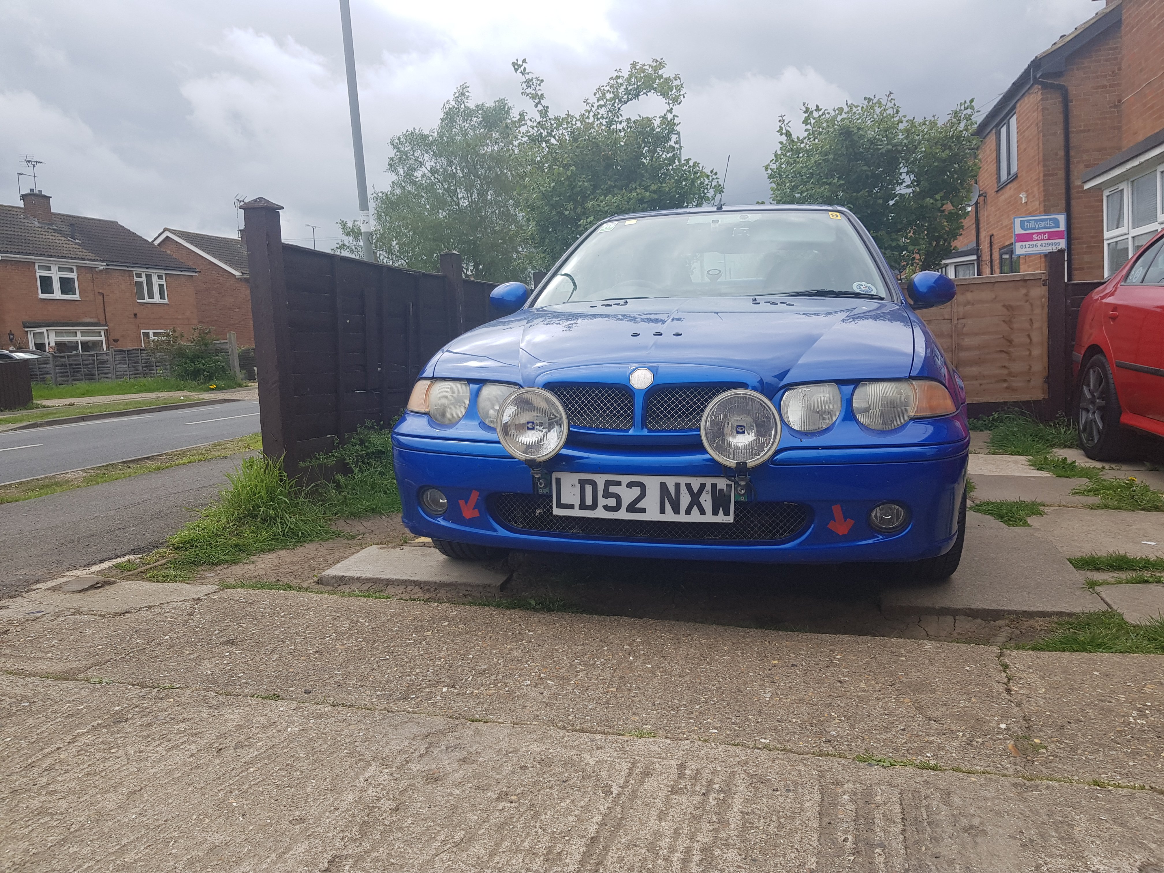

Another little job this week was fit my bigger spot lights. Managed to pick up a cheap set of Hella 1000 lamps off eBay and I'd forgotten how much better than the smaller Comet 500s they are. I've just got to try not to break them.

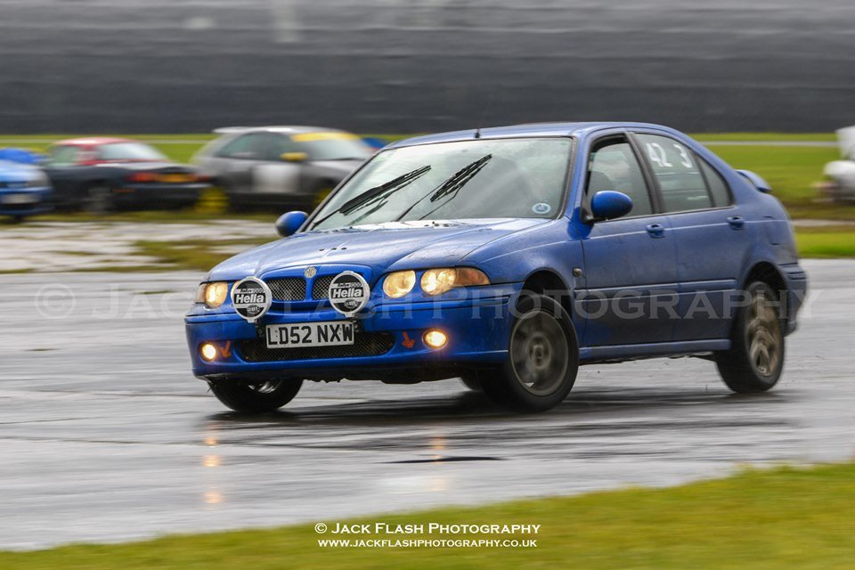

The first autosolo got off to a bad start when being in the first group out on the first test meant damp runs with limited grip and then the throttle cable snapped at the end of the second run. A quick bodge with an electrical crimp connector and some cable ties saw us still in the game but an overshoot on the third run left me 9 seconds off the class lead.
It was dry for the second test so I was able to pull back all that lost time and I was just 0.7 seconds off the class lead. Test 3 then put me 2 seconds clear and I held that through the final test to take the class win.

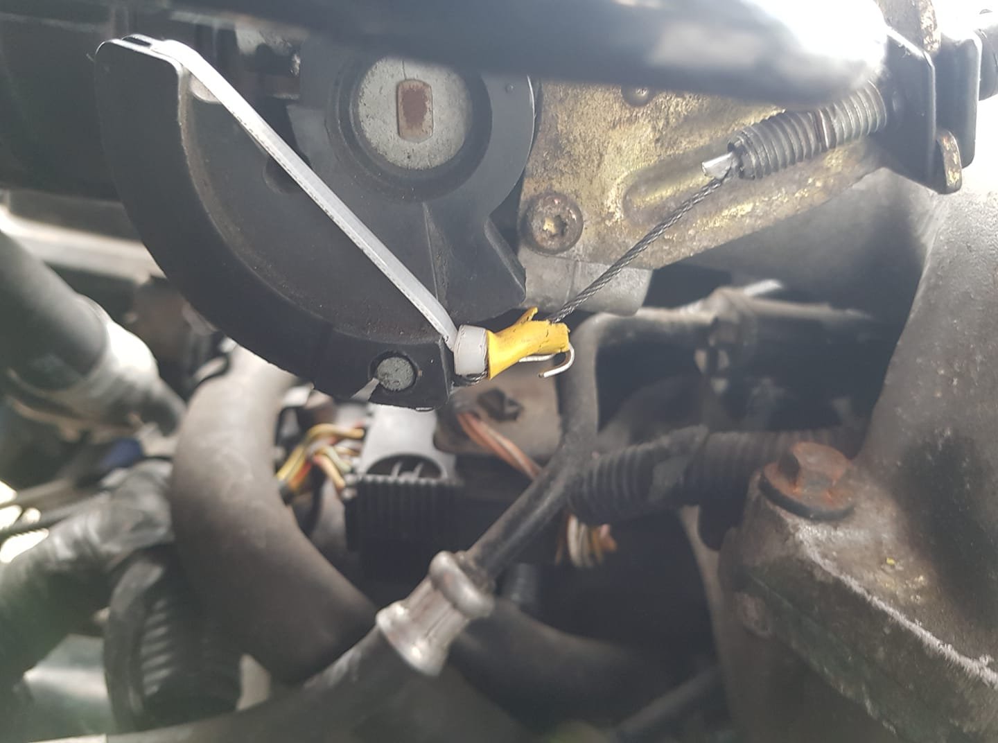

Anyway, the cable bodge held for the rest of the day and got us home.

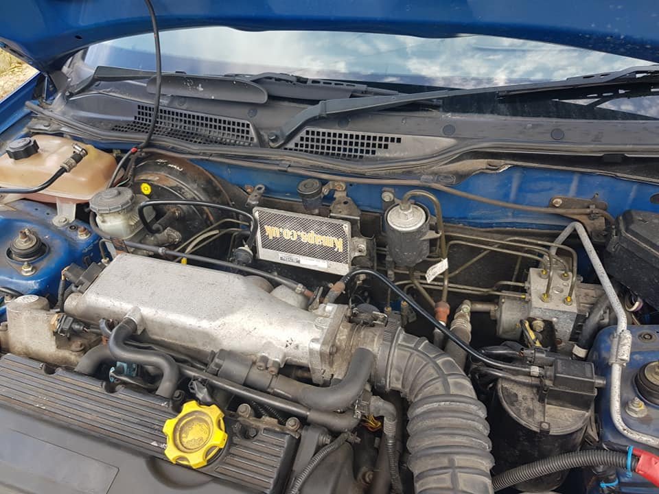

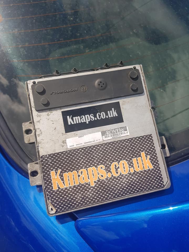

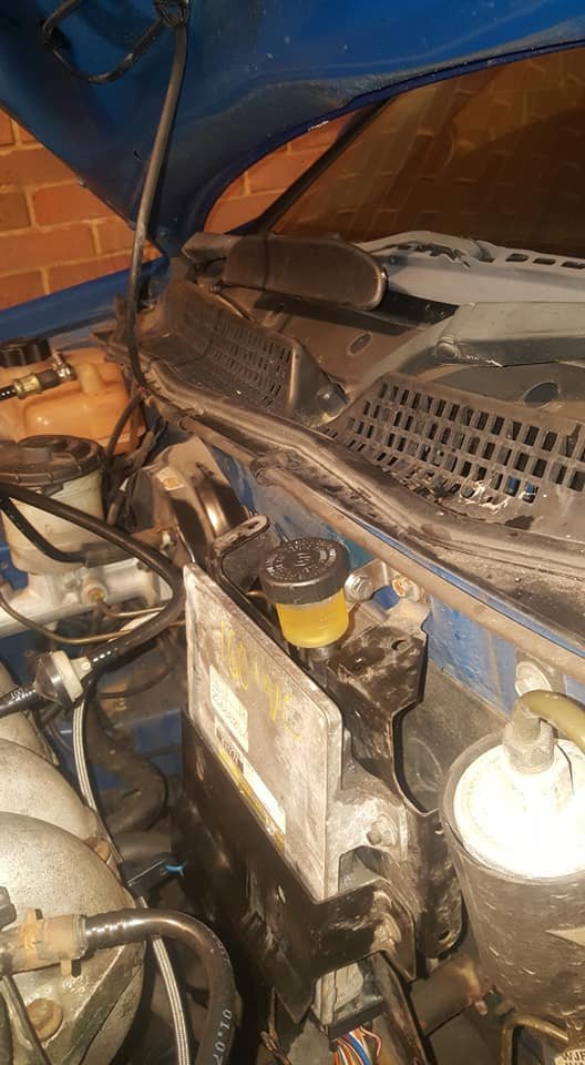

I was going to send my ECU off to Kmaps at some point for a remap but one popped up on Facebook marketplace already done so I was able to save myself a fair few pennies. As it's already unlocked, so no need to get it coded to my alarm/immobiliser, a simple plug and play.
Supposedly a few more bhp but I'll have to wait until the next time it goes on the rollers to confirm that. There's definitely a very noticable increase in low down torque and the raised rev limit from 7250 to 7500rpm should come in handy on Autosolos where I'm finding quite a lot of the time I have to decide whether it's worth going into second or just bounce it off the limiter in first for a bit. This map also has the added "pops and crackles" option so it makes cool noises when you lift off over about 3500rpm 😎
