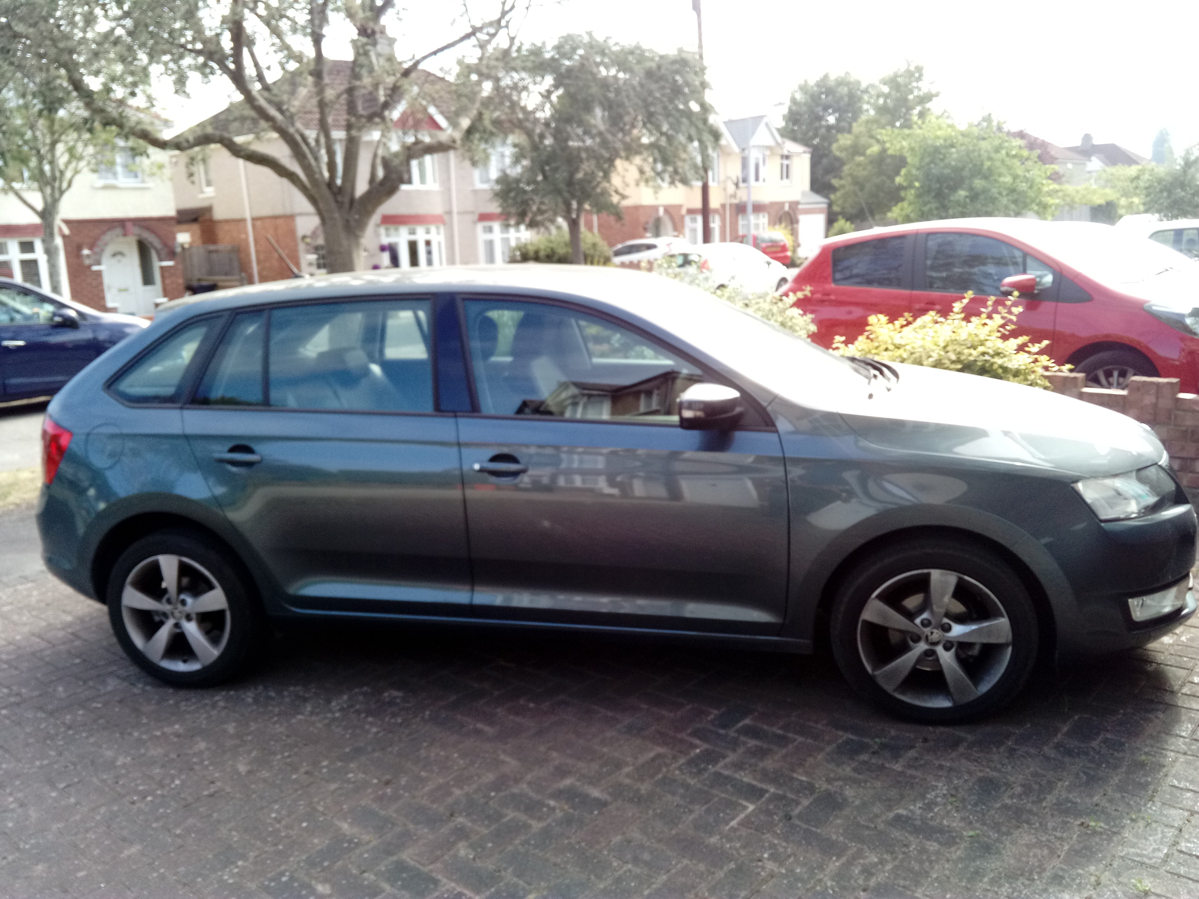

Not sure if it’s the picture but Rapid seems to sit high.
Davy
I am thinking that too, especially the rear. I don't mind it actually as long as it's not an issue
The 4x4 stance is standard on the Rapid and they are higher at the back, If you're in Russia its jacked up another 15mm or 20mm higher.
