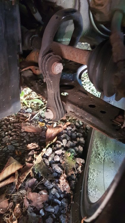

I had a new front antiroll bar fitted to my motor, and I always, and still do think the car is not correct as there seems to be bit of wobble on the front end.
When i had the work done about 7 months ago I had new front wishbones, FARB, gaters, track rod ends along with trackrods and also new bushes for wishbones.
I went to check my droplinks today as I was just curious how they were installed and they go from the end of the FARB then bolted the the wishbone. i thought this was a bit strange as iv never seen droplinks connected to a wish bone before.
I have attaced a photo.
Would someone be kind enough to let me know there thoughts
Kind regards
Drew
Most odd. The vRSs had a drop link that connects from the bar to the strut. That looks like a lower model setup?
I thought as Much.
The thing is I stupidly didn't check when I had it fitted and I ordered it from  a web site and it said it fitted my car.
Looks like im going to have to get a new FARB, or used one.
It almost looks like he has put it on the wrong way aroung
It is fitted correctly. Just the wrong sort it seems.
Cheers fella.
So which model is it for.
I guess that will explain the roll of the car that seems worse "great".
Thanks Mankee

Mmmm.. what you some how ended up with there is half a mk1 diesel front suspension setup..
Yeah im gutted.
I wont be going to that garage again.
They got all the parts for a non vrs, probably because they were a lot cheaper than actual vrs bits. May not have known or cared that the setup is completely different. .
Id probably go with the fact they didt care.
Now my next question is my car is due for MOT. would this fail it do you think. im guessing it would be down to how knowledgeable the MOT guy is and knowing if he know its the incorrect set up?

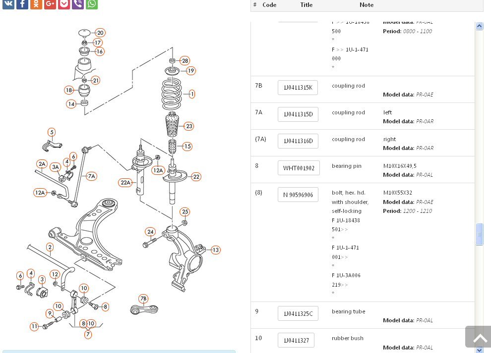

Thats an ARB from a fwd mk4 golf and drop links to match.
VRS arb doesnt have the hoops over the driveshaft and drop links from the strut itself directly to the end of the arb.
No reason why this wouldnt work perfectly well though, its how 90% of mk4 golf platformed cars are set up
iirc VRS factory wishbones dont have the threaded hole for this type of set up (I could be wrong)
When I fitted Audi TT wishbones they then did have them
Its not incorrect, its just a different way of doing it. Shouldn't have any issue with MOT
