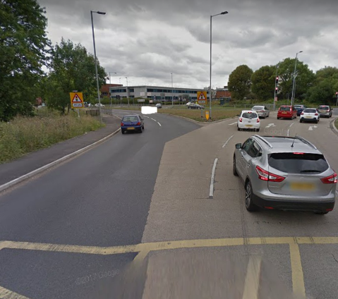

FA has stepped in once though and I didn't have a clue why at first.......  I was turning left at a roundabout in lane 1 exiting into lane 1, the car in lane 2 came with me and nudged ahead, in the photo below I was roughly where the blue car is and the other car near the white mark.
At that point the warning went off and I nearly headbutted the steering wheel with how hard the car slammed on.
It was only after the event I realised that I was accelerating and the FA probably thought I was going to T-bone the car in lane 2.
OK, it was a false alarm but worked very effectively none the less
