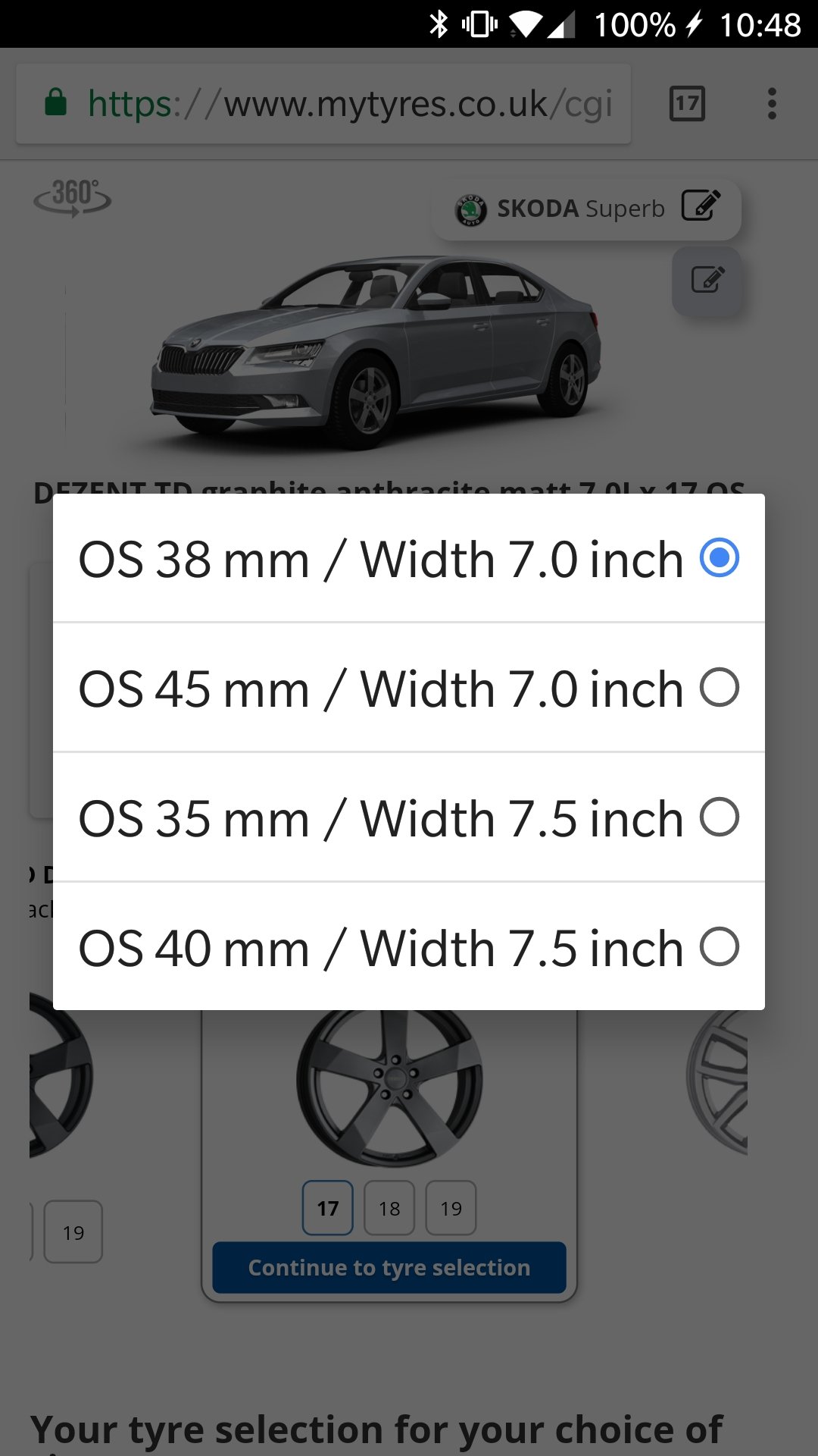

Can someone kindly just confirm which OS i need. I have a 220 sportline. Just looking at which wheel and tyre to get for when time comes for winter tyres.
Thx
If go down to 17s o/s between 39-44 fine.. See www.wheel-size.com. If buying chains (Alpine) get 9mm smaller link for clearance. & 6.5jx 17 o/s 41 pref.

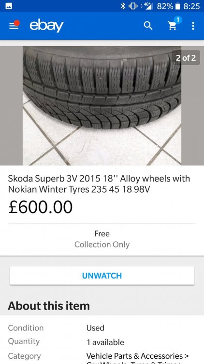

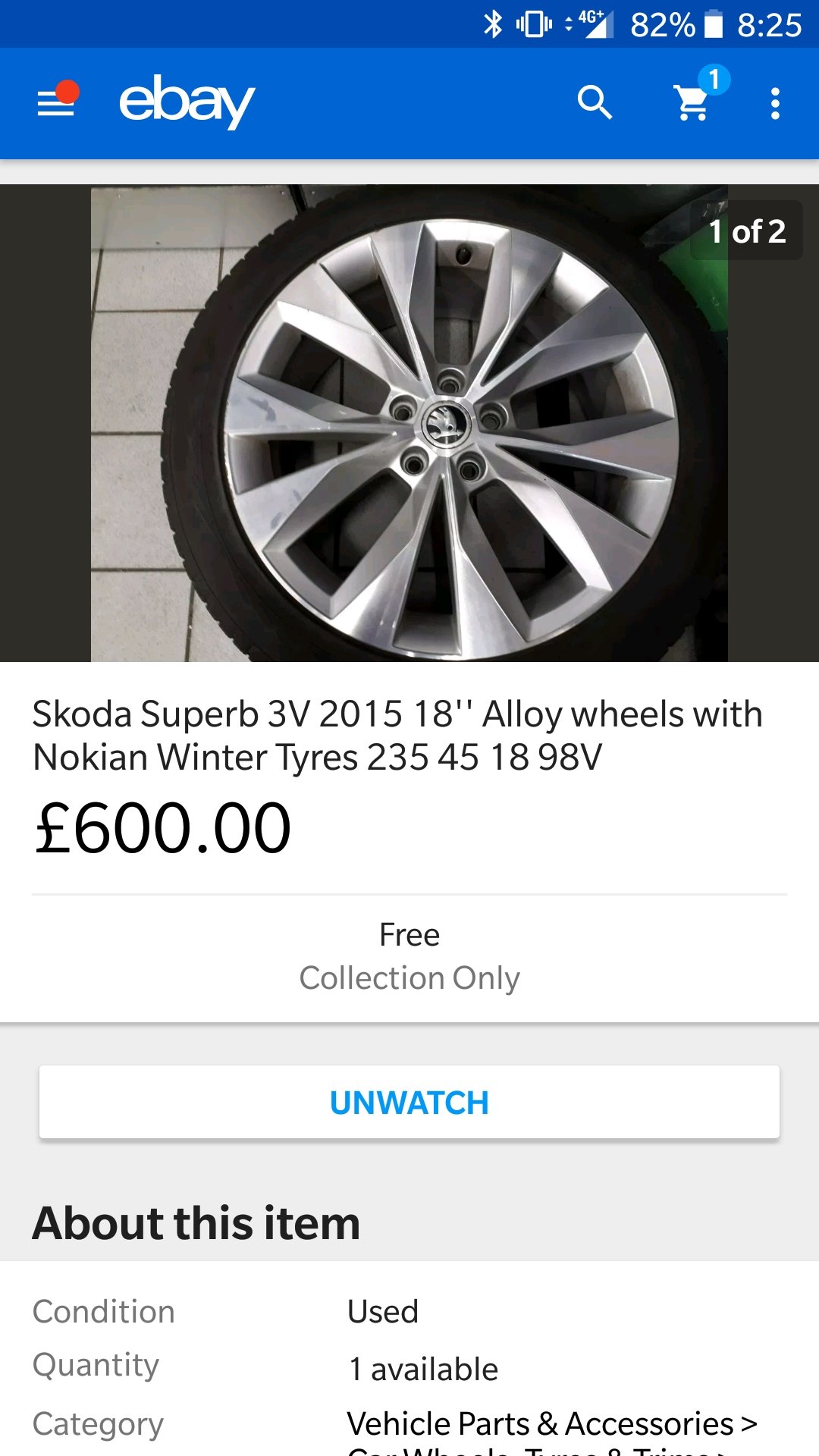

Thx to everyone for the info. I have found a set of alloys with nokian winter tyres already fitted frok ebay, managed to get them for 550 for the set.  Albeit they are 18s rather than the 17s i was initially looking at. Screenshot_20180806-202527.thumb.jpg.141572796f7c83638cee1faa0b687f00.jpgScreenshot_20180806-202522.thumb.jpg.55c61faa840d73665468fcd010711bee.jpg
A good buy indeed. Those A4 Nokians perform great on our 220
Thats very assuring to hear as i have a 220 as well.
