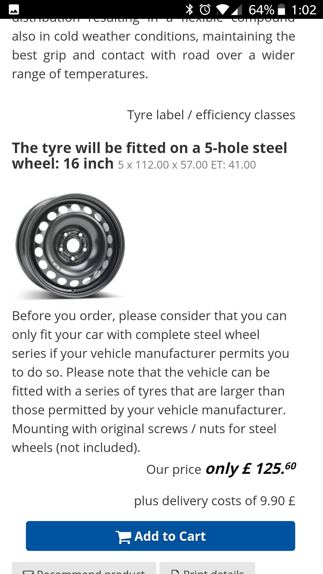

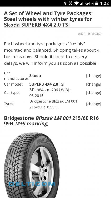

Does this look right? Offsets and all that (i have no idea what all those numbers mean lol)  Want to make sure before i order later in the year.  As mentioned above will this effect speedo?

It seems about right. No steel wheel option on 17"?:blink:
My main concerne is that 215/60 R16 is not an official size for Superb (it is almost same diameter as R17 though). I don't know how strict they are in UK. 16" should fit though because spare wheel is also steel 16".

No, there is no significant effect on spido. And offsets seem right.
I would personally go with 17" alloys. Tyres would not cost much more and you can get alloys near to steel wheel price.
