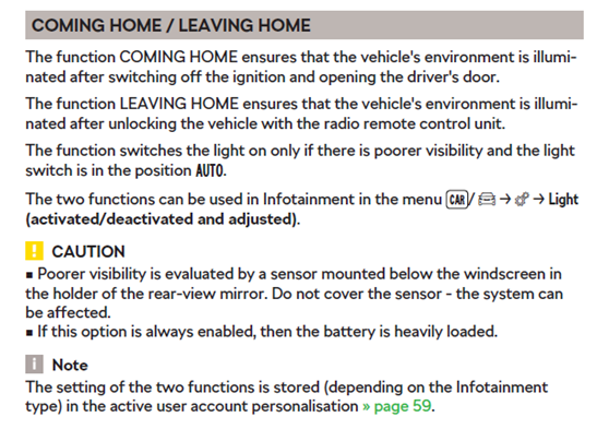

@Zenbasses FYI there is an ambient light sensor (mounted in the back of the rear view mirror).
@JR RS has it right re the conditions for CH/LH lights to work.
In the manual (p77 of my pdf version) it says:
So there are four things to check:
1. CH / LH is set in the infotainment (which you've done).
2. Lights are set to auto
3. Outside has "poorer visibility" (which is obviously subjective)
4. The sensor in the back of the rear-view mirror isn't obscured / covered / damaged.
You might also want to check whether you have set up CH/LH in the personalisation for one key but not another? (Just a thought if you have different profiles set up in the car).
