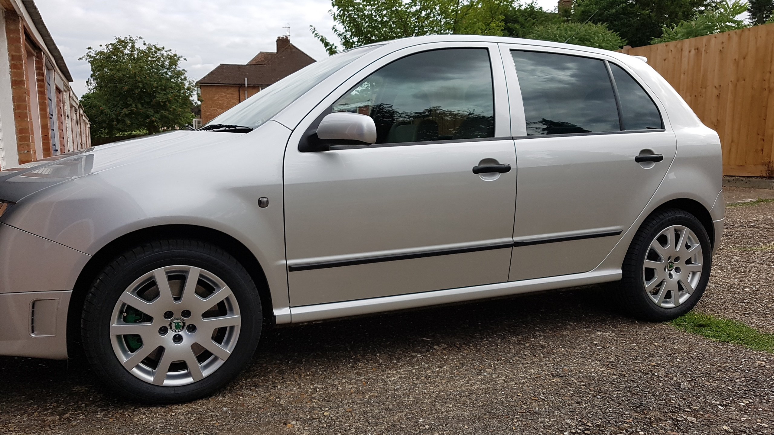

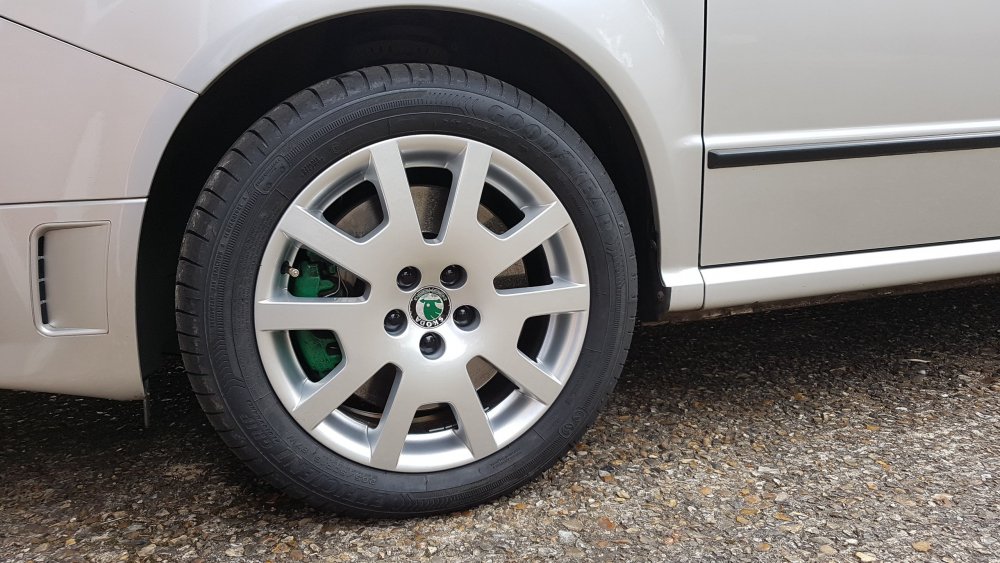

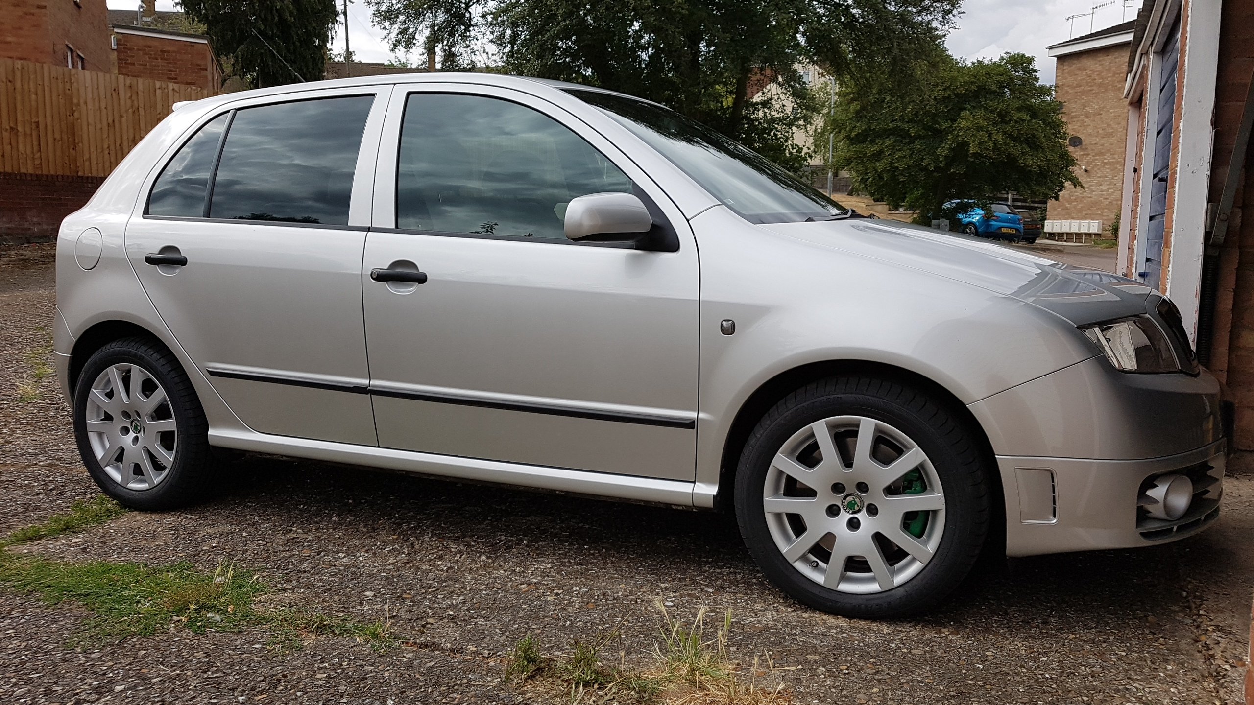

Any side pics of these on car?

Just fills the arch a bit more
One more photo.

Great, thanks......I need tyres soon and may get these as well. (same colour as mine too!!)
