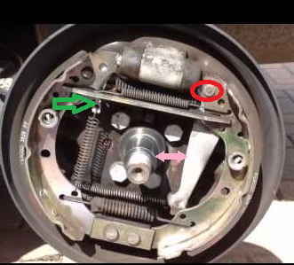

This image has a red circle around the pivot that locks up with corrosion, and a pink arrow showing the normal movement that you may find doesn't happen.
The (in theory self-) adjusting wedge is on the left side of the stub axle with a spring coming down to the shoe.

It isn't usually a problem with the adjuster, as I said; usually the pivot stops allowing the lever to move as it should.
I will add a green arrow pointing at the adjuster though.  One minute.
  • Sponsor
It gets pulled down vertically whenever there is space for it to move, effectively lengthening the horizontal bar that it goes through. Check the pivot with the red circle round it first, it's almost always the problem.

Was the pivot that I circled in red  seized/immobile?

I used the pivot point you marked, but since some springs started popping out, I just rebuilt the brake...so now ive done that too
