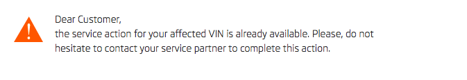

Checked my car and the below message was displayed
Does that mean my car has not been updated?

I would say that it hasn't had the fix, you can check under the boot carpet if there is a small sticker

It's hard to say, Skoda might not have updated their webpage.
The best check is to find out what software version the ECU has. VCDS and similar can do this, it's also normally shown in the VAG DPF app.

What version should I be looking for? And where in VCDS can I click to check ?

Anything above around 9970 is 'fixed'.
Quote
Address 01: Engine (J623-CFHC)       Labels: 03L-906-018-CFF.clb
   Part No SW: 03L 906 018 C    HW: 03L 906 018 BR
   Component: R4 2,0L EDC   H24 7100
If you have a VCDS autoscan, it's the number in red above.
