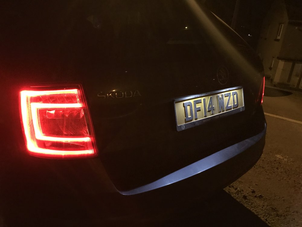

Might get one of these as well...

Yes they need coding or will show bulb out warnings. 5 Min job with VCDS, OBDEleven etc.
