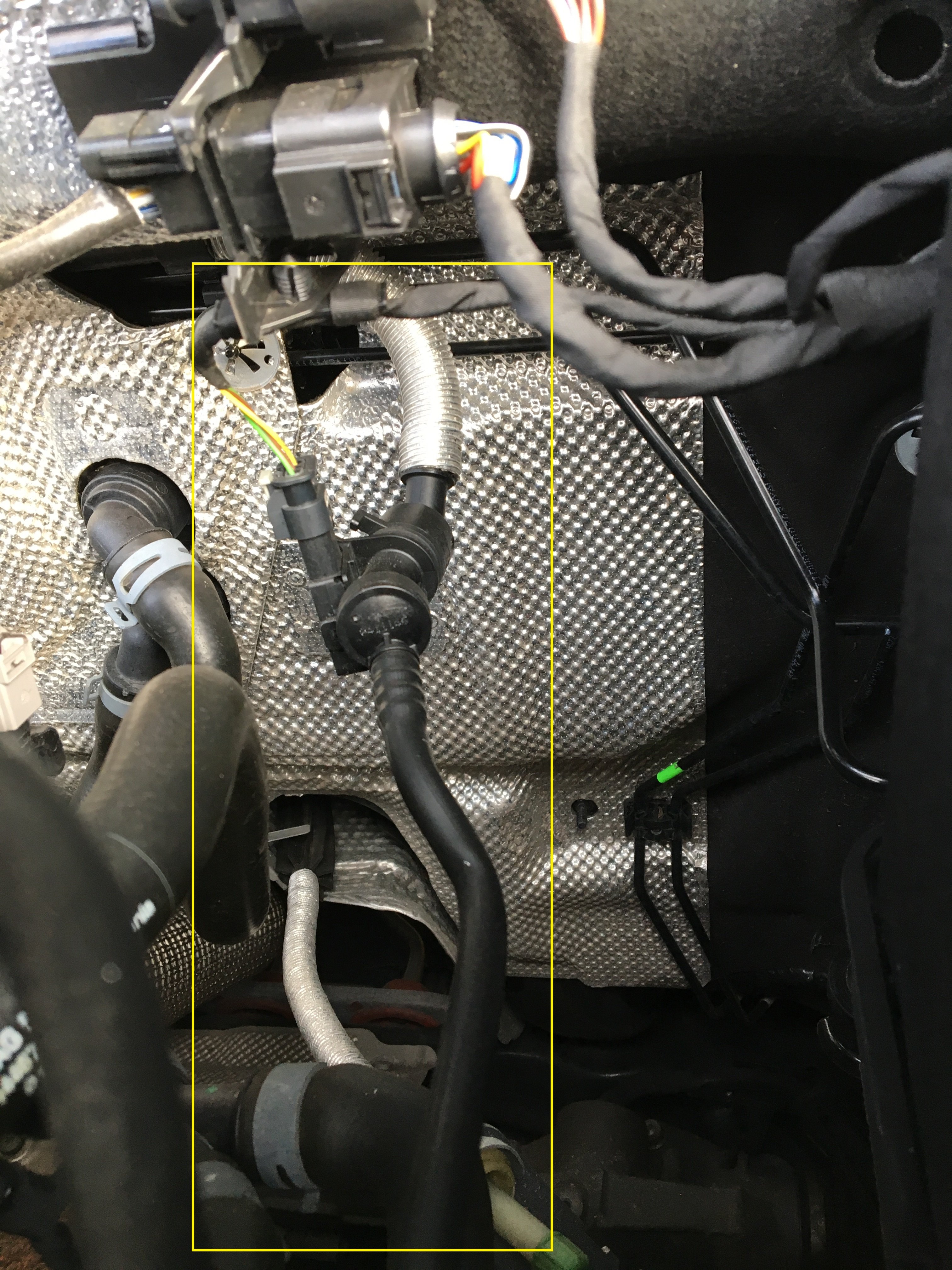

Weird pipe / sensor?
Hi there, just for my own curiosity, does anyone know what this pipe and sensor does?
From a 2014 1.4 TSI 140 engine.
Petrol, 1.4 TSI (103 kW, 140 PS, 138 hp ) Code CHPA, Engine Code EA211, 7-speed DSG
Cheers!
And what do all the other items do? I may as well ask.:wondering:
Wonder if it's part of the  Active charcoal filter system with solenoid valve N80.
It's the warp drive actuator, and can be enabled with VCDS version 978345.14 which is due for release in the year 3034
Forgot to say what that part actually is. It's the vacuum feed for the brake servo. Although it looks like the tube goes through the bulkhead, it just gets routed behind the bulkhead heat shield. One end connects to the throttle body, other end brake servo.
Thanks MoggyTech!  Good skills.

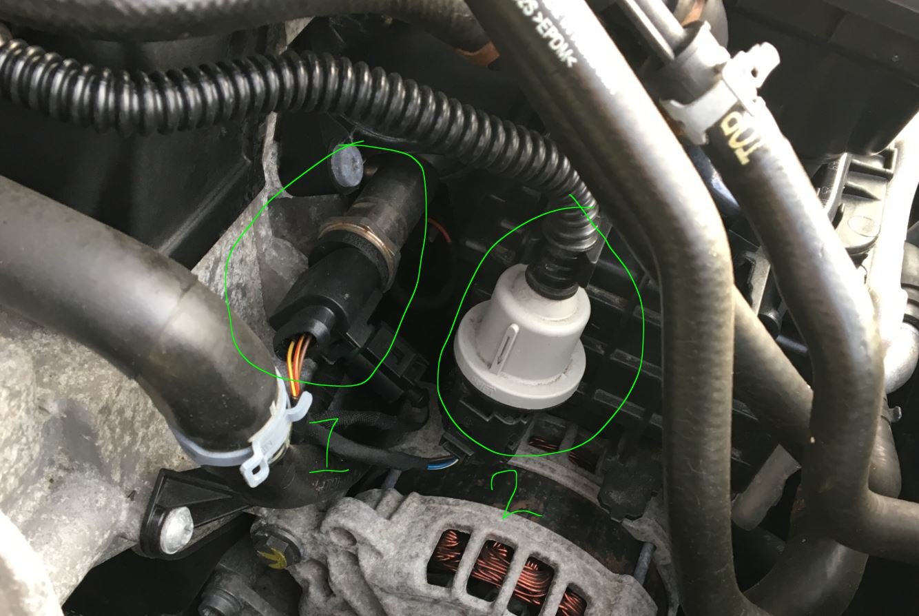

How about these two?
One on the left is the fuel pressure sender, one on the right PCV no return vavle.
Top play, thanks for that MoggyTech! My curiosity has been satisfied :)
