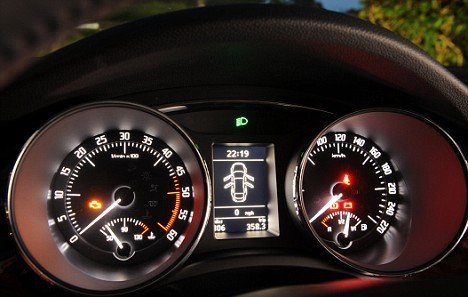

The launch of the MkIII Octavia was when Skoda removed the green dipped headlight 'telltale' symbol on the central dash display. All subsequent models, including the Karoq and Kodia have suffered the same fate.
My current Superb...
As with this thread, some claim it isn't needed, another unnecessary light or distraction, trust the automatic headlight control to do its job.
Others prefer it for reasons mentioned earlier, the automatic system isn't infallible, not recognising fog, getting confused in overly bright environments etc.
In this weather it is easy to forget winter, but I can remember the number of drivers in modern cars driving in low light / wintery conditions with only DRL's.
Sometimes common sense and manual intervention is still required to stay safe. If a little green LED on the dash helps (rather than down and out of clear sight on the headlight switch), then I'm all for it.
