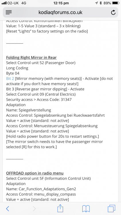

Has anyone managed to activate that the passenger mirror dips when reverse is selected? I have an SEL with manual seats but I'm pretty sure it can be done in VCDS so if anyone has the procedure for it id love to have it :)
I’ve enabled it with Carista but it doesn’t seem to work!

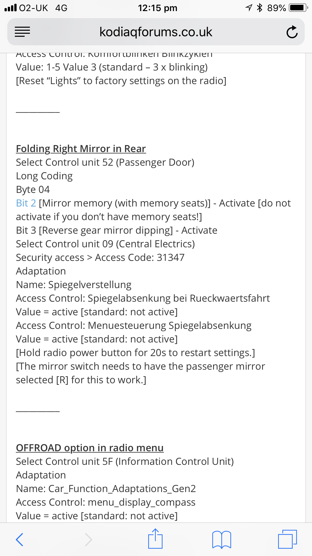

IMG_0907.thumb.PNG.0fe2fabb133bfd7c4ce76cd14227d24e.PNG  We tried this , but it didn't work. The option to select it on the radio appeared but it didn't do anything :( Was hoping someone might have better luck than me

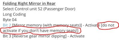

Do the Kodiaqs mirrors have potentiometers fitted, regardless of whether or not they are enabled?
For a short period of '13 there was a fault with a batch of potentiometers at the SEAT factory so my Leon didn't have one fitted.  I could enable the 'mirror dip in reverse' function with VCDS but due to the hardware not being present, the mirror wouldn't return to it's original position, when moving forwards at the speed threshold.

If the Kodiaq shares any coding with the current MkIII Octavia (MQB platform) then it looks as though it might never work properly if electrically operated memory seats were not factory fitted.
It looks as though it can be made to work on lower spec Kodiaq's, i.e. the mirror can be made to dip, but...
- The mirror doesn't adjust down enough rendering the feature useless.
- The mirror won't return to normal by itself, it stays in the dipped position, even after you've reached the speed threshold in a forward gear.
- The mirror does attempt to return, but doesn't know where the previous mirror position was so you have to manually readjust each time.
- It'll only work with the switch in the 'L' position, meaning it doesn't work if you've selected the mirror heating.
It seems cars that left the factory with this feature have a potentiometer fitted in the mirror housing which mitigates against all of the issues mentioned above.

Try this VCDS procedure, although the poster experienced the issue of insufficient movement of the mirror resulting in him reversing the coding...

we didn't activate bit 2 as the it said not too.

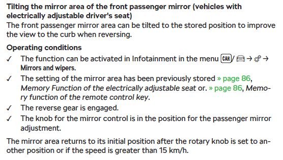

Does anyone RTFM these days? My guess is you've not actually set the position yet...
Storing front passenger ́s exterior mirror settings for reversing
The function for lowering the front passenger's mirror area during reversing can be activated in Infotainment in the menu  /  →  → Mirrors and wipers.
› Unlock the vehicle with the remote control key and switch on the ignition.› Turn the rotary knob for the exterior mirror control to the position for the
front passenger mirror area » page 83.
› Engage reverse gear.
› Adjust the front passenger's mirror to the desired position.
› Disengage reverse gear. The adjusted position of the exterior mirror is stored
in the remote control key memory.

I have it on my 2012 Superb. Where it moves to depends on you. So you have to select L on the switch, and move the mirror to where you would like it to be. So if its moving in, use the switch to move it back out, and down to where you want it for example. I miss that our Furby doesn't have it, and will be upset if it doesn't work on the new Kodi I get on Tuesday!
