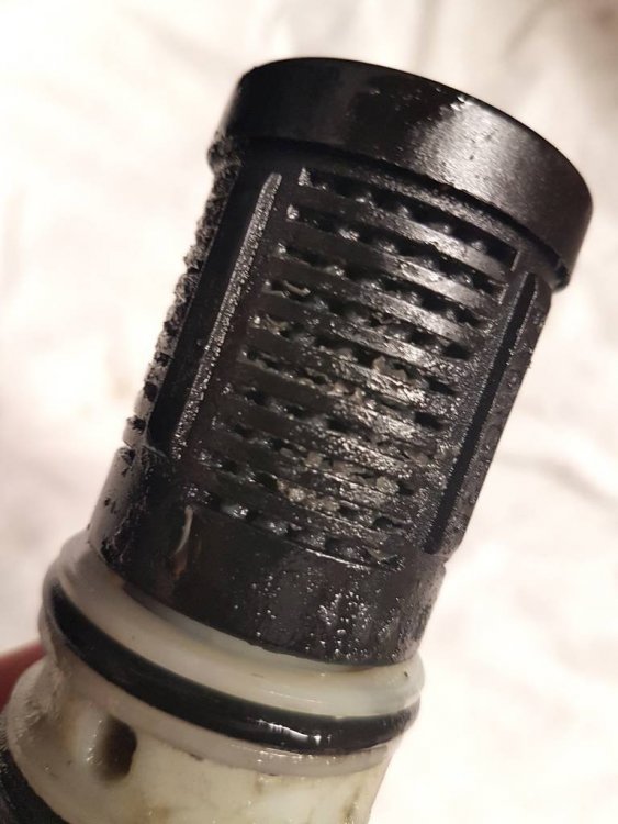

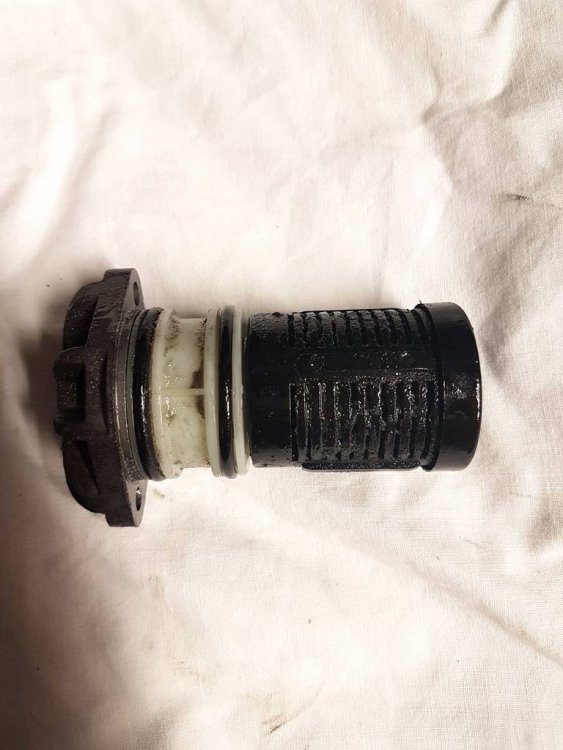

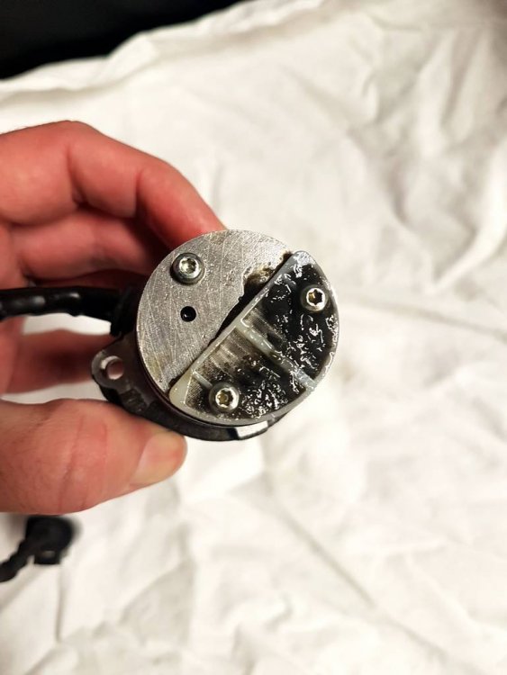

Just to update this thread I decided to go forward with a new pump, filter and oil to restore my Haldex to what it should be.
Cutting a long story short, after a lot of informed reading on here and elsewhere, I sourced the parts online via Haldex Repairs and received some very helpful emails from the company owner.  I then sourced a local company who had knowledge of Haldex repairs and booked in with them for the work to be done.  They work on a lot of tuned/high end cars with Haldex systems and seemed well versed on oil changes and cleaning the pump strainer etc, and in truth were the only company that I found that seemed to have much knowledge on Haldex servicing.
I asked that they return the pump and filter for inspection and you will see the pics below.  The car has done 41.5k and already had a scheduled 'Skoda' Haldex service (oil change only) as per the book.  The state of the pump strainer is pretty much fully clogged and the filter is rather nasty.  I was pretty surprised by the state of it all and glad I had made the decision to replace both items.  It would be easy enough to clean the pump strainer and stick it back in but I wasn't wanting to mess around and risk further issues with pump failure.  I will do some checks on the pump to see whether it is fully dead or not when I get a chance.  My conclusion to this saga is that I will now have the Haldex oil changed and pump removed to clean the strainer at least annually, or every 10k miles approx.  Whether I include a new filter each time I am unsure, possibly every second oil change say 20k miles would be more reasonable.  I believe this approach will drastically help prolong the life of the Haldex pump and system.

from where did all that dirt comes in filter?
Most likely from the clutch pack in the Haldex unit.  When the clutch operates a certain amount of dust will be generated I imagine.
Sure, It is wet clutch. Like on motorcycles i think..
