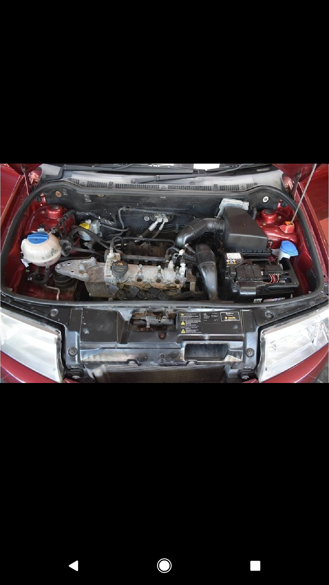

I am not sure I know it has 3 cylinders I think. Is a htp.
Here is a screenshot of the engine.

That's a 6 valve engine. Code BMD I expect. Not the most trouble-free mk1 Fabia engine type. How many miles on the clock?

I wouldn't, the 12V is ok, the 6V is a ticking timebomb. There's a reason it's for sale cheaply.
