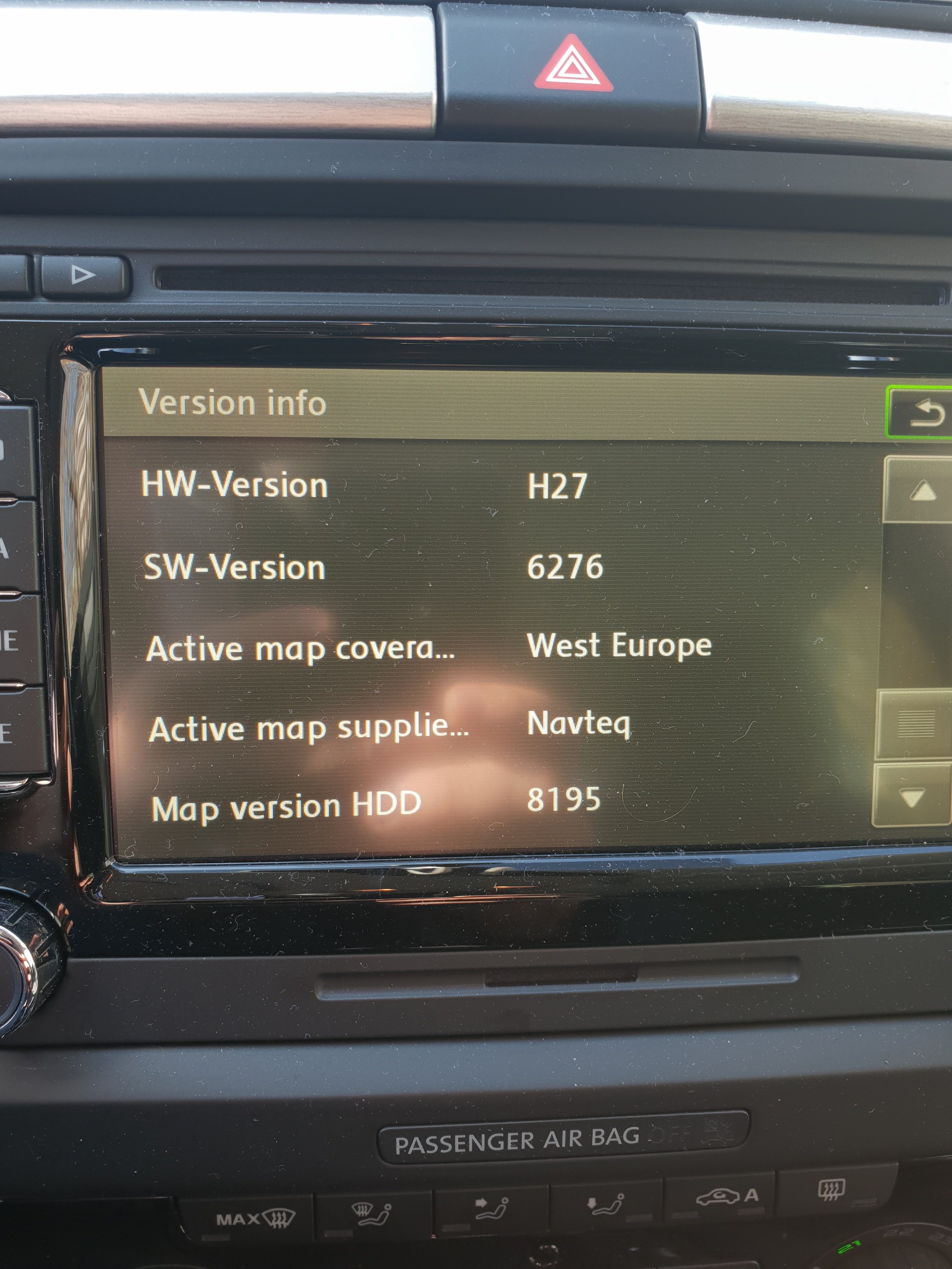

Hi guys!
I'm new around here and also a new owner of a Superb 2 facelift.
 I've searched to find If there is any update for my car's system and I could not find any for version 6xxx. My dealer tolf me there are no updates to be done, but somehow I doubt that.
In the attached picture you can see the actual versions on my car.
Can you please share some of your knowledge with me? Thx in advance!
There's no sftware update available for your unit. Maps could be updated and the lates is V16 - 8536
Many thanks Rustynuts! All the best!

Hi again,
I'm wondering if you know if the LATEST software version for my unit is indeed SW 6276, please?
Many thanks in advance again.
1 hour ago, Xande007 said:
Hi again,
Unless mistaken, 5274 is the latest version for your hardware, and 6276 is for a different hardware revision.
