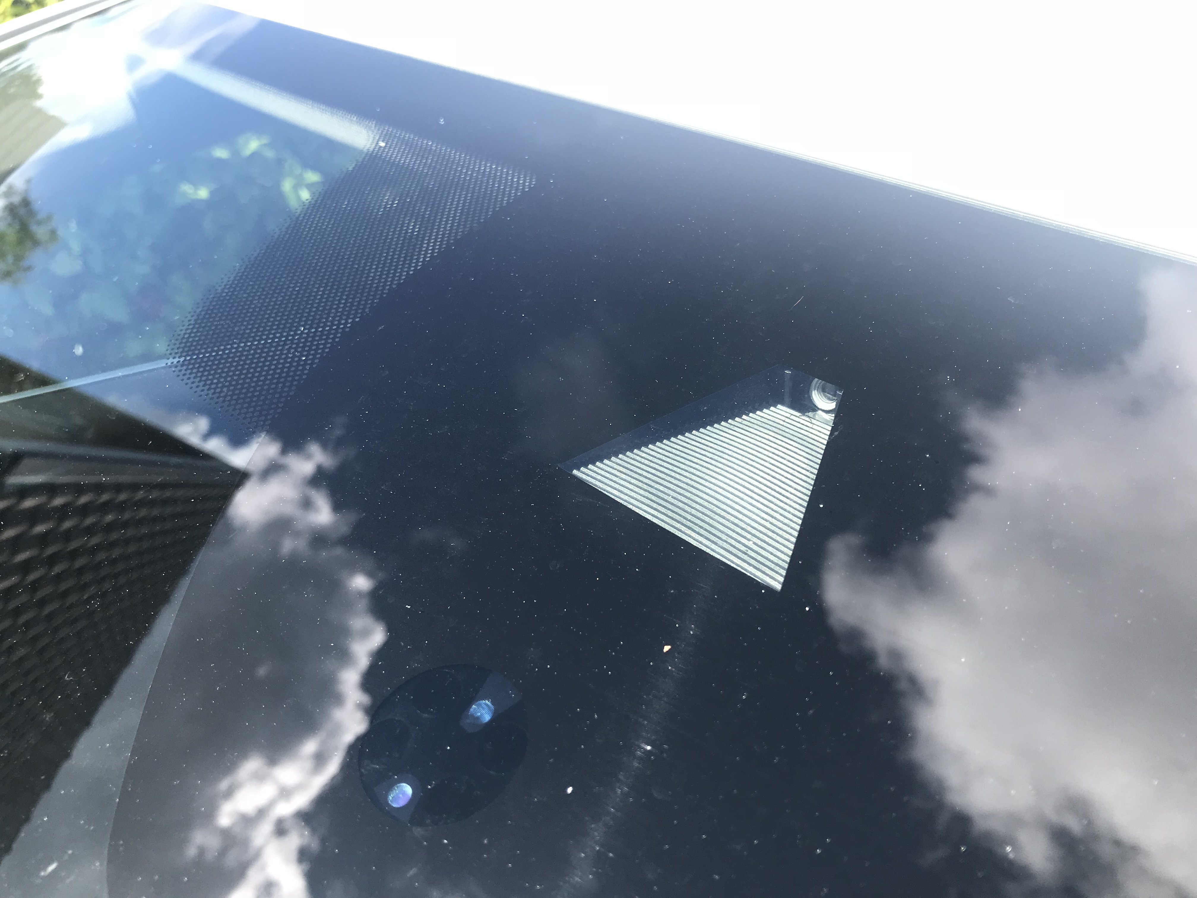

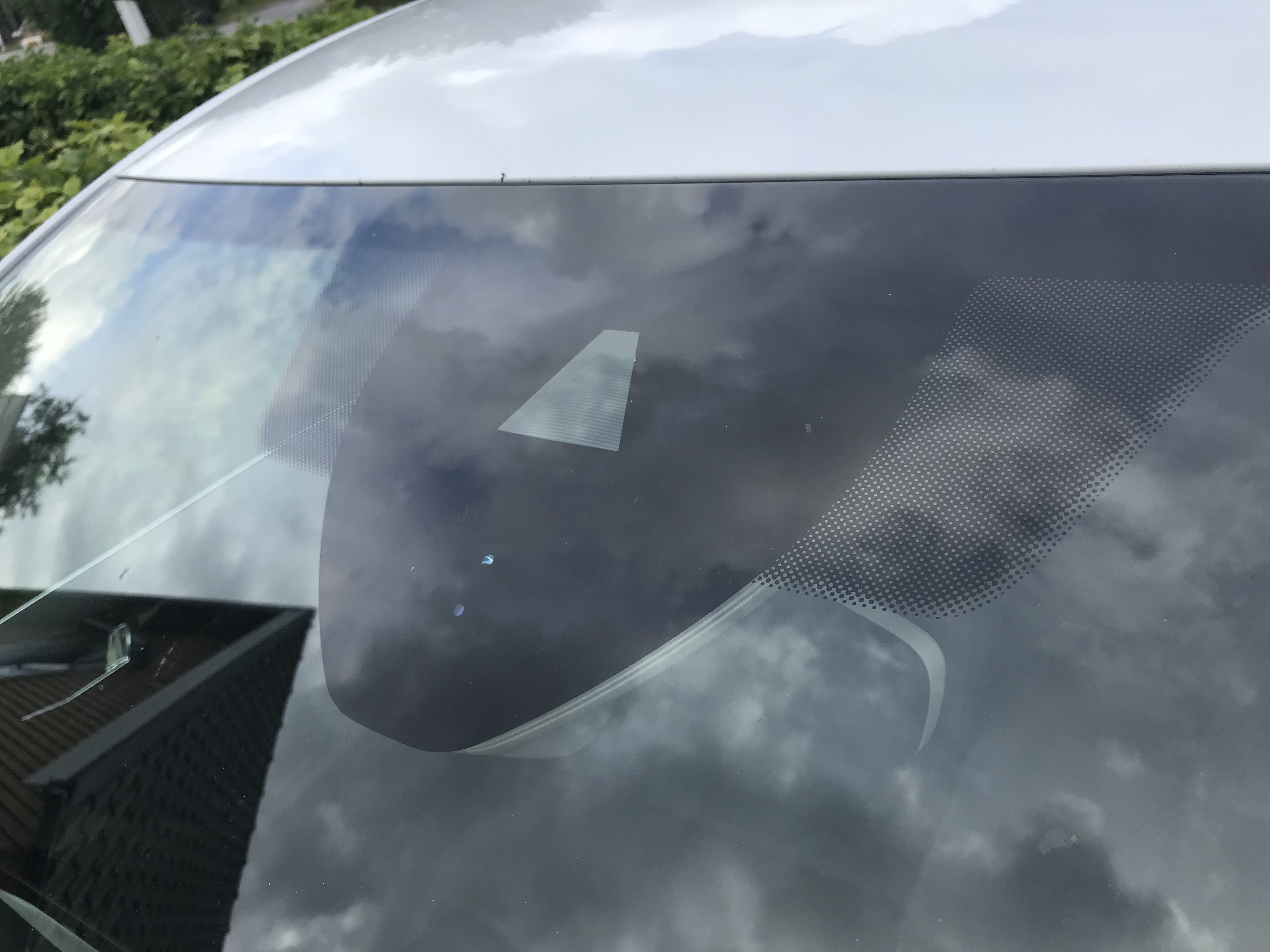

Hard to get a good picture but this is the top middle of the front windscreen, not sure if either of these things are the camera ?
Looks exactly like on my L&K, I’m pretty sure there is a camera lens there but I think it’s for the ACC adaptive cruise control. Not sure if that’s the same camera that is used for traffic sign recognition or lane assist, I don’t have those features on my car either.

What does the camera in the windscreen look like?
@DrSunshine As you have an L&K you have the camera - it is standard on the UK specification L&K (it's a part of Lane Assist).
You have the hardware for Traffic Assist (sign recognition) so, as Gizmo says, all you need is someone to enable the adaptations (software) with VCDS or similar.

Do you know if the Swedish MY2015 L&K specification have the same front camera? Is it seen in the photo I posted above?
And if it’s there, do you know if traffic sign recognition can be coded in somehow even though the car lack lane assist?
@jaggafredde I stand to be corrected but my understanding is that you need the A5 camera/module which comes factory fitted if the car came with any of the A5 options (Traffic Assist, Lane Assist or Smart Light Assist).
Vehicles fitted with Light Assist (HBA - High Beam Assist) alone have a camera but not the required canbus functions to support these additional options.
The mere presence of a camera does not guarantee that further options can be coded.

But how do I know if the car have the A5 camera? Is it a basic feature that is fitted on all Suberb MK3?
It doesn’t have any feature that require the camera, to my knowledge at least, but I thought the ACC used that camera so my knowledge on this is obviously limited :P
Stuff like this should be retrofitted afterwards at a Skoda seller if it’s just a software activation with no extra hardware needed, for a fee of course. It’s weird that Skoda isn’t jumping on this train. They’re just leaving money on the table for the aftermarket VCDS/OBD2 sellers.
It´s not standard; only if the car is equipped with one of the features, that uses the camera (Traffic Sign Recognition, High Beam Assist / Smart Light Assist and/or Lane Assist).
It´s easy to tell, if the car has the A5 camera - it looks like the photo from your post from yesterday at 2:04PM ;)

It’s difficult to take a photo of it but it looks like a lens in that triangle area. Is that where the A5 should be?
Yes.
