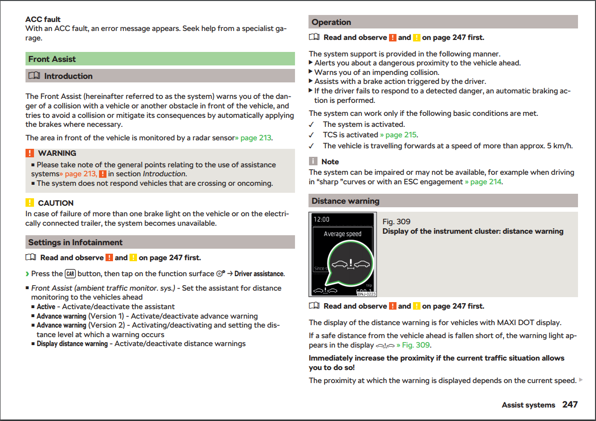

So my hubby has managed to trigger the front assist warning a good few times during motorway driving but the car didn't apply brakes. Should it have or is this warning only at motor way speed? What is the difference between front assist warning and the one with the exclamation in the middle of two cars?
Today the front assist warning displayed followed by what I would describe as a half-hearted attempt to apply brakes but they released. I was driving maybe 18mph tops on a residential road with no car in front or behind, no trees, no shadows etc.
Front assist first gives a visual warning followed by loud audible warning and then applies brakes if you don't react in time.
If you do react quickly then you'll only see the visual and maybe hear a little of the  audible warning.
My Fabia has only once fully applied the brakes when a van suddenly stopped in front of me.
The two car exclamation means you are driving too close to the car in front and need to pull back to a safe distance.

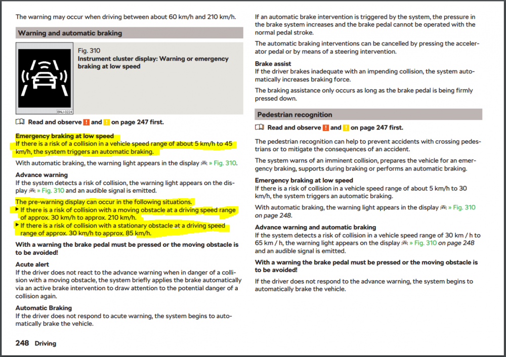

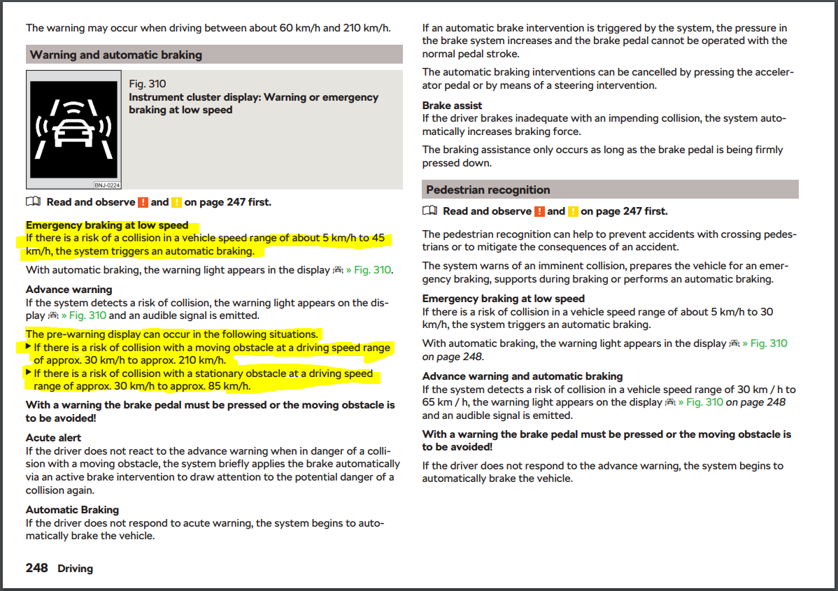

Does it work at motorway speed or is it advisory only?
I highlighted in the manual below. You have to be going between the set speeds detailed below for the the auto braking to fully activate.
Above those speeds it will only warn you of impending doom but will apply a greater amount of braking force on your behalf if it believes you are still going to crash when you have your foot on the brake while heading towards something

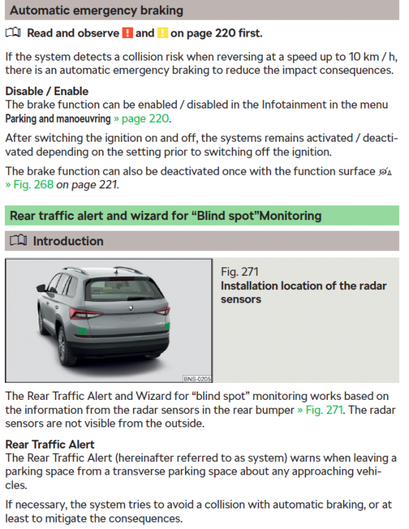

It appears slightly oversensitive when on fast curves and beeps irritatingly. Only had one occasion when it has put its foot to the floor and that was when I was reversing into a parking space and it mistook a blade of grass for something important and stopped the car dead.
Front Assist works in reverse?
No, but both the parkpilot system and the rear traffic alert do.
