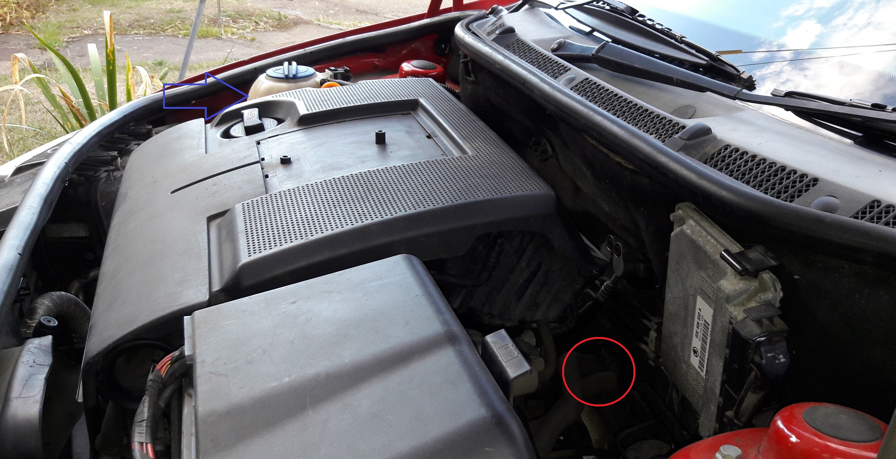

1 hour ago, sepulchrave said:
Heater matrix is the highest point in the system
Are you sure?
The red ring is around the heater matrix pipes, the matrix itself sits horizontally just the other side of the bulkhead.
Is the expansion tank perhaps a tad higher? :wink:
