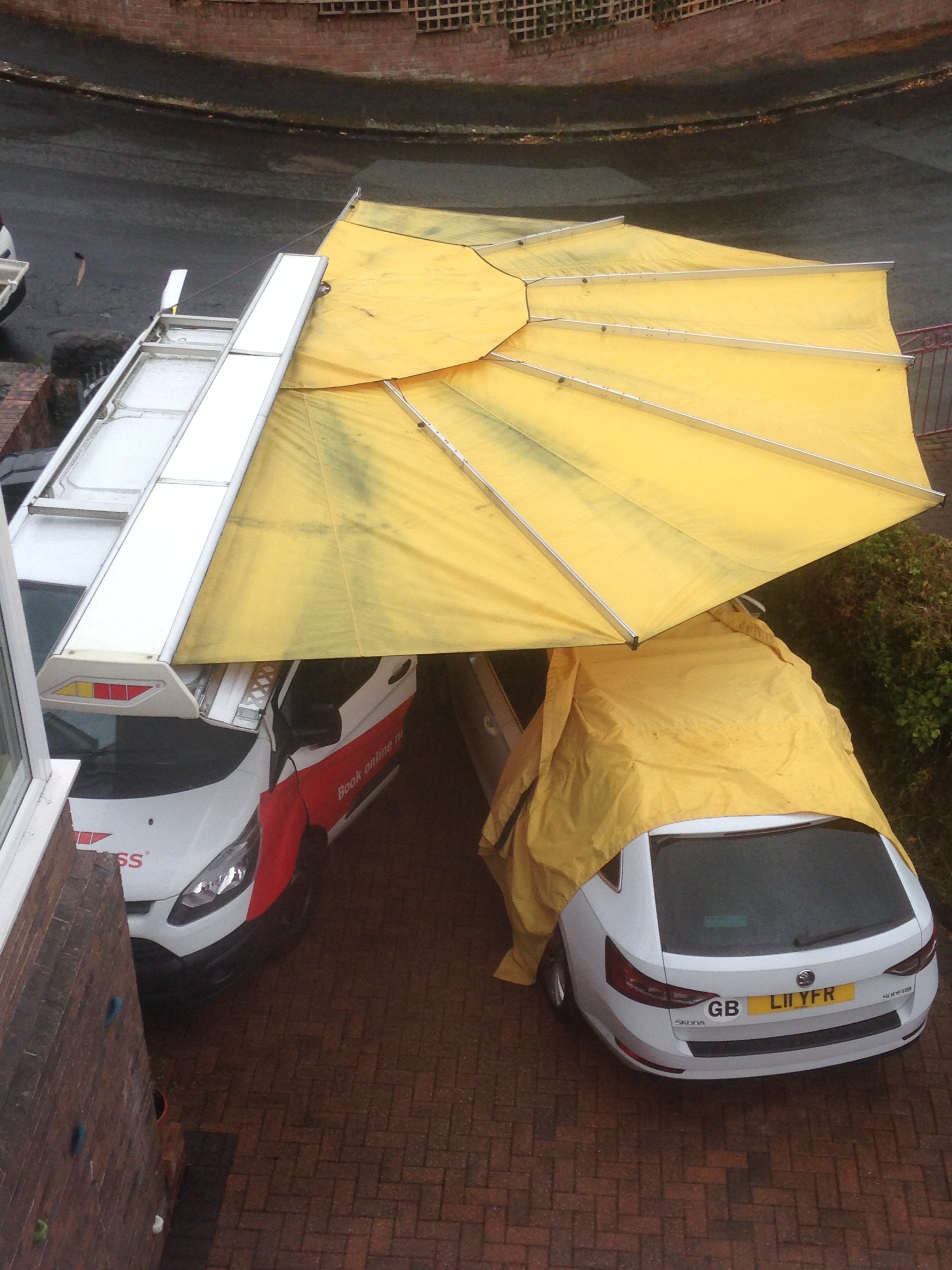

Some serious 'awning envy' in our house this morning! Man with van looks like he knows his stuff too so I'm hopeful all goes well. New screen should be in place within a couple of hours.
Looks impressive - hope it all goes well. Do you have the camera built in to the windscreen? If so, how are you getting the calibration done?
