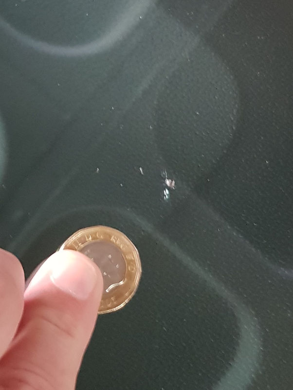

So here is a picture of mine.
Autoglass seem happy to repair it, and it's booked for Wednesday. Hope it doesn't get any worse before then :sadsmile:. I'll ask the technician if they know anything about screen shortages and report back (hopefully with an "after" picture showing a successful repair).
That coin must have been going at a hell of a crack for it become embedded! :blink:
Nice clean finger there, obviously a white collar worker....;)
I superglued it over the chip, to help out Autoglass. I'm sure they will appreciate it. And I always scrub up for a photo of course...
I have a lot of hits like that and I don't see why repairing that would have any effect? At least on mine I can't see the hole getting to 2nd layer of the window (which is what is concerning). The chips otherwise are slightly visible but not annoying. Window should not break further if first layer is not penetrated. These windscreens can handle a lot of crap, but a right angle and bye...

You might be right JackySi, but over here a repair is the usual course of action where possible, since repair is cheap and replacement is expensive in relative terms. To give you an idea, the cost to me of the repair is a princely £10.00, with my insurance company picking up the rest of the tab (c£120 IIRC). A new screen, with the recalibration of the camera etc would run to several hundred pounds and put the car off the road for longer than I can afford to be without it. Sorry to hear about your screen damage - 14 screens in 2 cars is horrific!:o

I understand. Didn't mean it like that, if its possible to repair its of course better course of action. I just think that these really small chips are not going to do any difference if you glue them/repair with the "standard" repair methods. It doesn't do much difference to windscreen hardness unless you actually get chip in same existing chip, but how much chance is for that :D
That photo shows what looks like a tiny sub surface crack in one of the lower layers. The glue repair is not about strengthening but vacuuming out moisture and sealing. Once water is in, then a large temperature change and certainly freezing will see that tiny defect crack the windscreen. Been there, seen that.

I see. I did never think about that. I'll get my tiny chips looked at too then. Perhaps I have the same issue. Thanks :=)

From the outside it looks like a chip, but from the inside you can see a 1cm crack. Obviously it hasn't penetrated completely, but I do suspect sub-surface damage. As xman says, moisture and temperature changes are the big risk - hence getting it fixed asap.

FYI mine was repaired on Wednesday. It isn't completely invisible, but at least I can be confident it won't spread now. I'm averaging a chip per year, so I might go for replacement if the inevitable happens again.

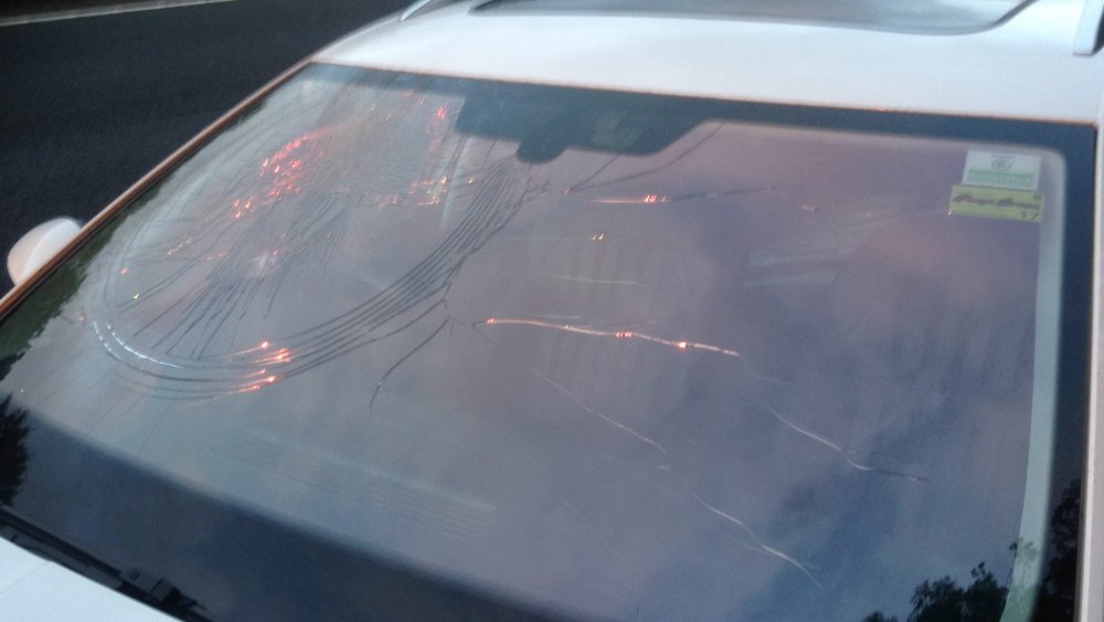

This is what happens when a pidgeon hits your screen at speed! Serves me right for being in a hurry.5E5CB862-D103-4324-A514-7B7B85DC0816.thumb.jpg.ae09ac1613edc0065cc4998af9dd98e3.jpg
Screen is heated and has sensors for wipers and lights. Only 5 day turnaround by Autoglass, hopefully the fitting will be straightforward.
Knowing my luck I'll pick up a chip within the first month!
That's really really bad luck! WOW!
