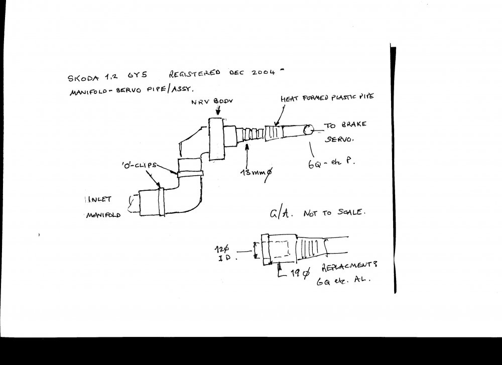

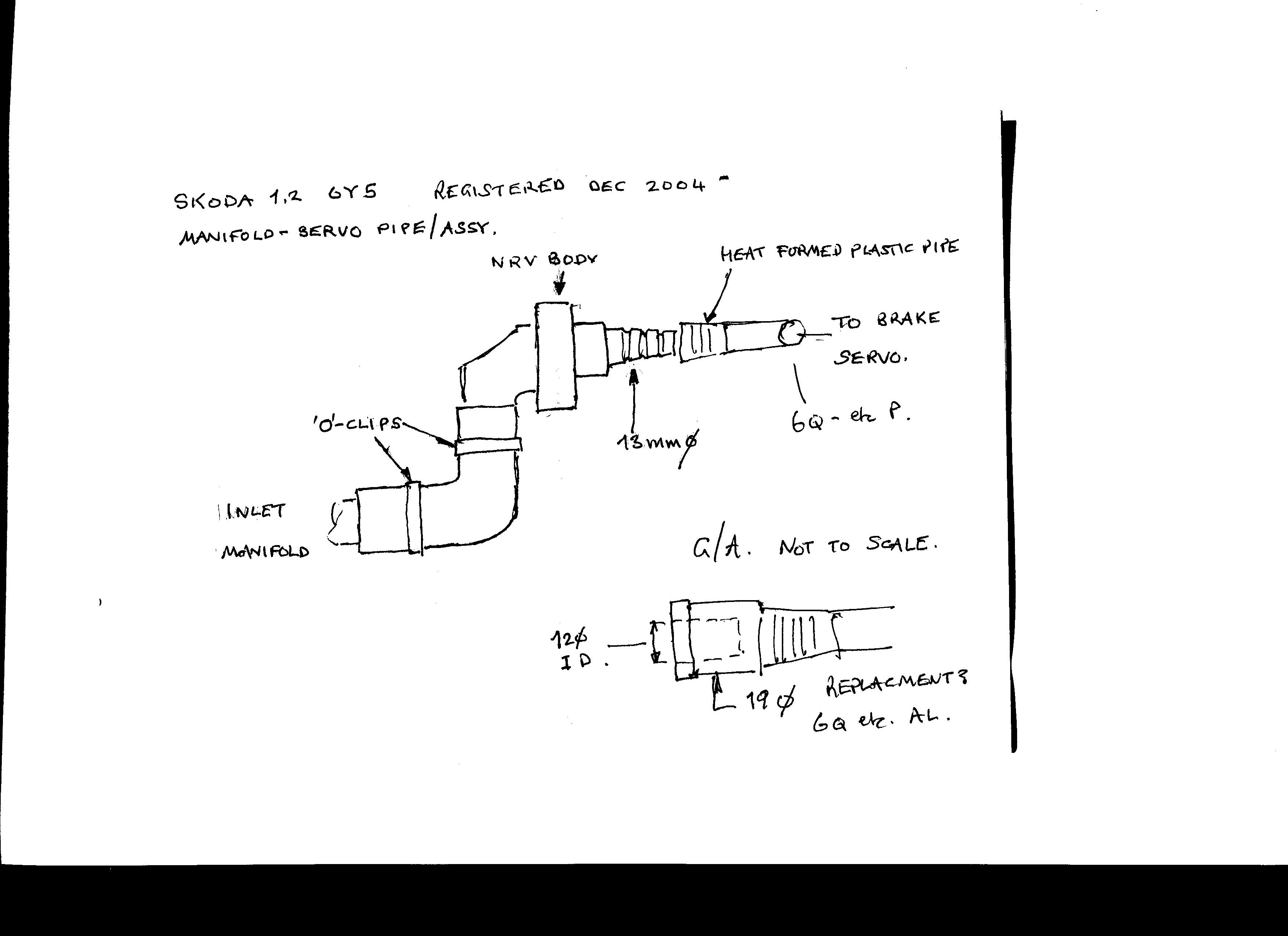

Attached is quick sketch of the NRV. My Fabia was registered in December 2004 so would have missed the change in item number! Judging by rhe dimensions of the replacement assy. I think that the hose was meant to attach to the old (existing) NRV nipple. I would think that the old NRV was prone to failure hence the modification. Replacement (braided) pipe is secured with Oetiker clips.Scanned190.thumb.jpg.f36285de2524f764760d4756638ca34e.jpg

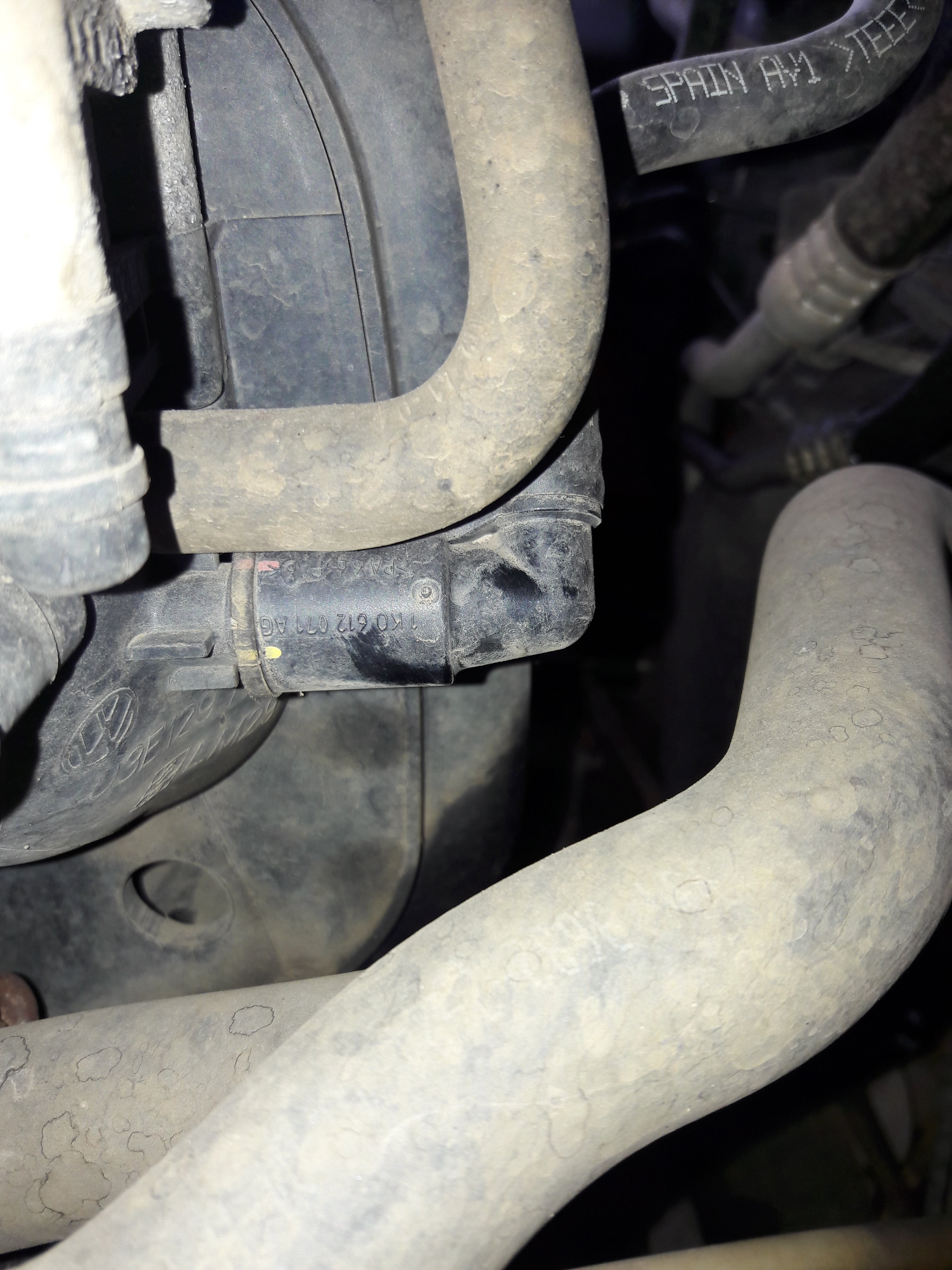

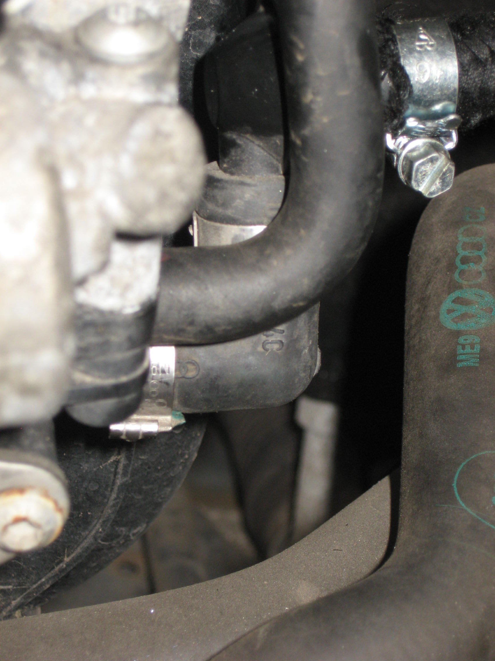

6 hours ago, AlandLyn said:
I can fit the 6Q2612041AL straight onto the inlet manifold outlet but I do not know the size of this outlet pipe
It fits:
