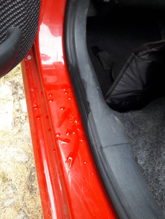

Are you certain it's not coming from the door carrier seal? Telltale clue is water on the horizontal bit of the door orifice seal after rainfall.
Picture of a rear one:

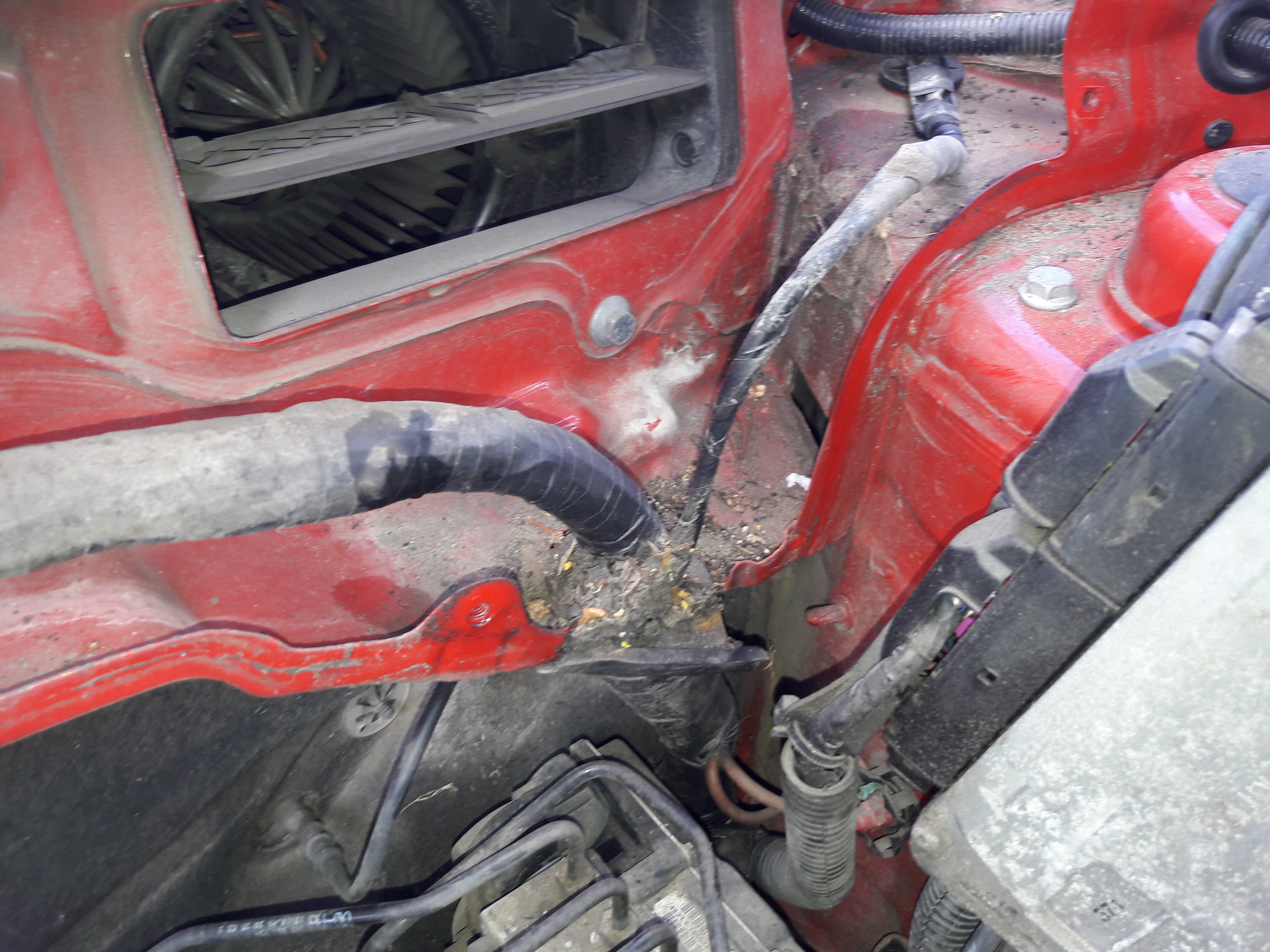

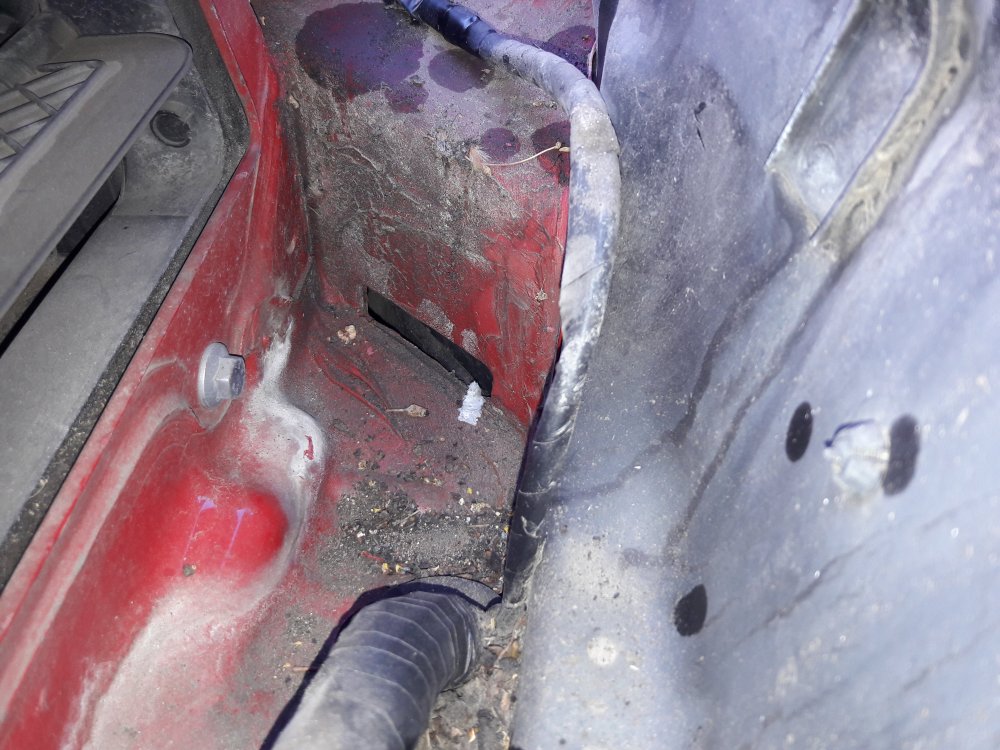

Will pop a pic up in a minute.
Easiest way to clear it is probably to remove nearside front wheel, and wheel arch liner, then hook out any debris from the exit point of the drain.
This is the (rectangular slot) drain from inside the 'waterbox', the big bunch of loom cables in the foreground goes down to the engine bay, ECU and other stuff.

Pic added above. Air entry high on the left, recirc flaps in 'outside air' position.

Just in case it is coming from door seals - if its not, it probably will be soon!

Btw is this picture taken looking up from the wheel arch?
And does clearing the rectangle hole not just push it back under the scuttle panel?
  • Sponsor
No. Looking down into/along scuttle.

This one should help you orientate yourself.
Reason I suggest going from outside is that the wipers have to come off to get the top of the scuttle off, and they can be a right bugger, scarily corroded onto their spindles and hard to remove even with a wiper puller tool. Wheel arch liner is just a load of T25 torx screws. Edit, If you do go from above/inside, there's no need to remove wiper motor, that's at t'other end. This view is with front of scuttle also off, but you probably don't need to do that.

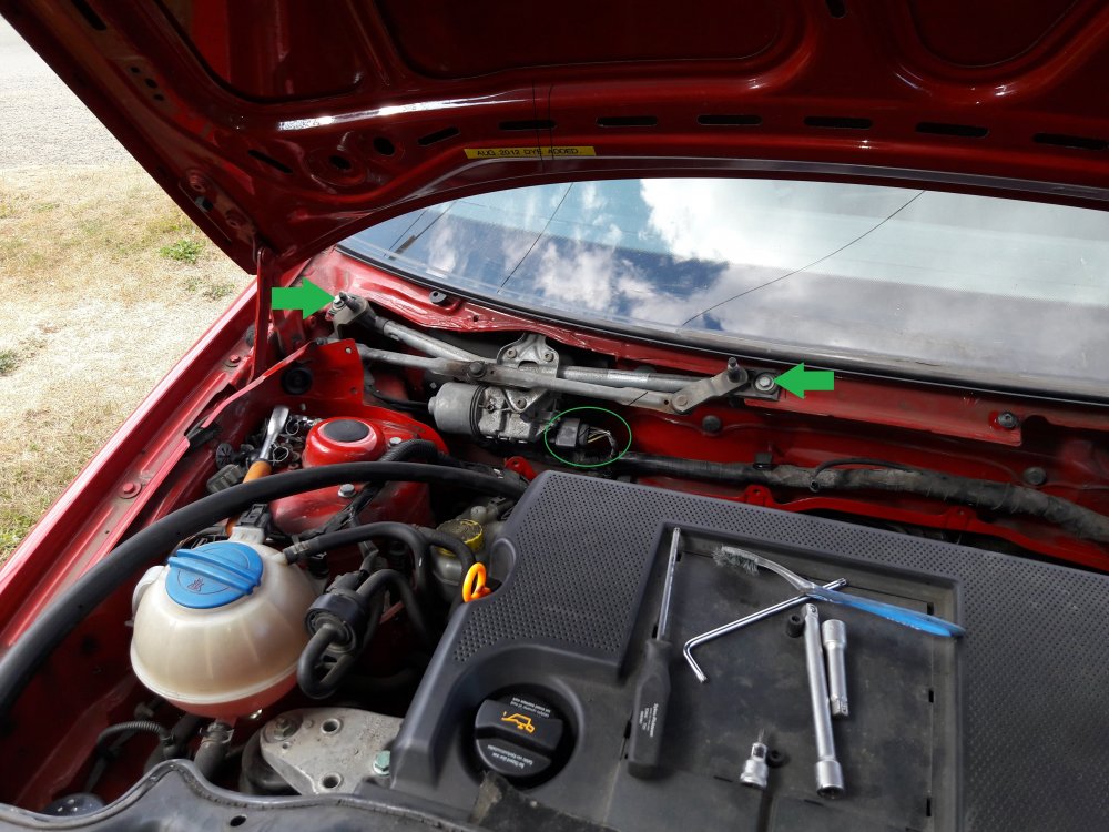

Wiper motor is actually a piece of cake to remove, if you ever need to. Two easily accessible screws, one electrical connection. Will try to find a pic...
Edited by Wino

If you do decide to go in this way, make sure you have a wiper puller that can fit on the wiper arms, and I'd advise just slicing the tops off those three clips with a sharp blade under their heads rather than trying to pull them out.  Also, the rear edge, that seems to slot into the bottom edge of the windscreen, at first glance, doesn't really. There's a downward facing lip on the scuttle lid that fits into a slot on that bit that goes onto the windscreen.  Start at the end and pull the scuttle lid upwards, at right angles to the windscreen. The lip will peel out of the slot, leaving the part still attached to the windscreen, you can just about make it out in the picture above showing the wiper mechanism screws.

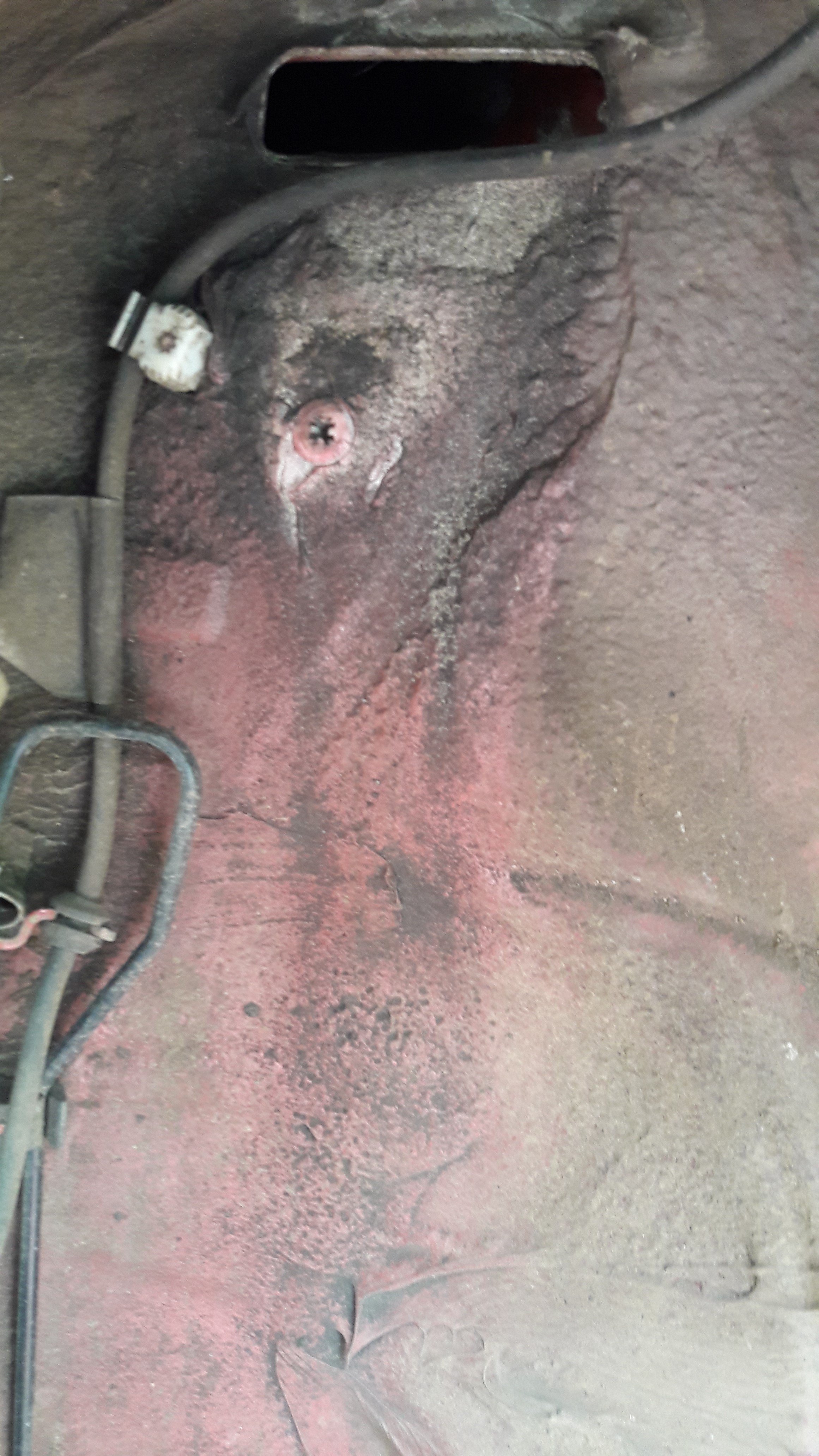

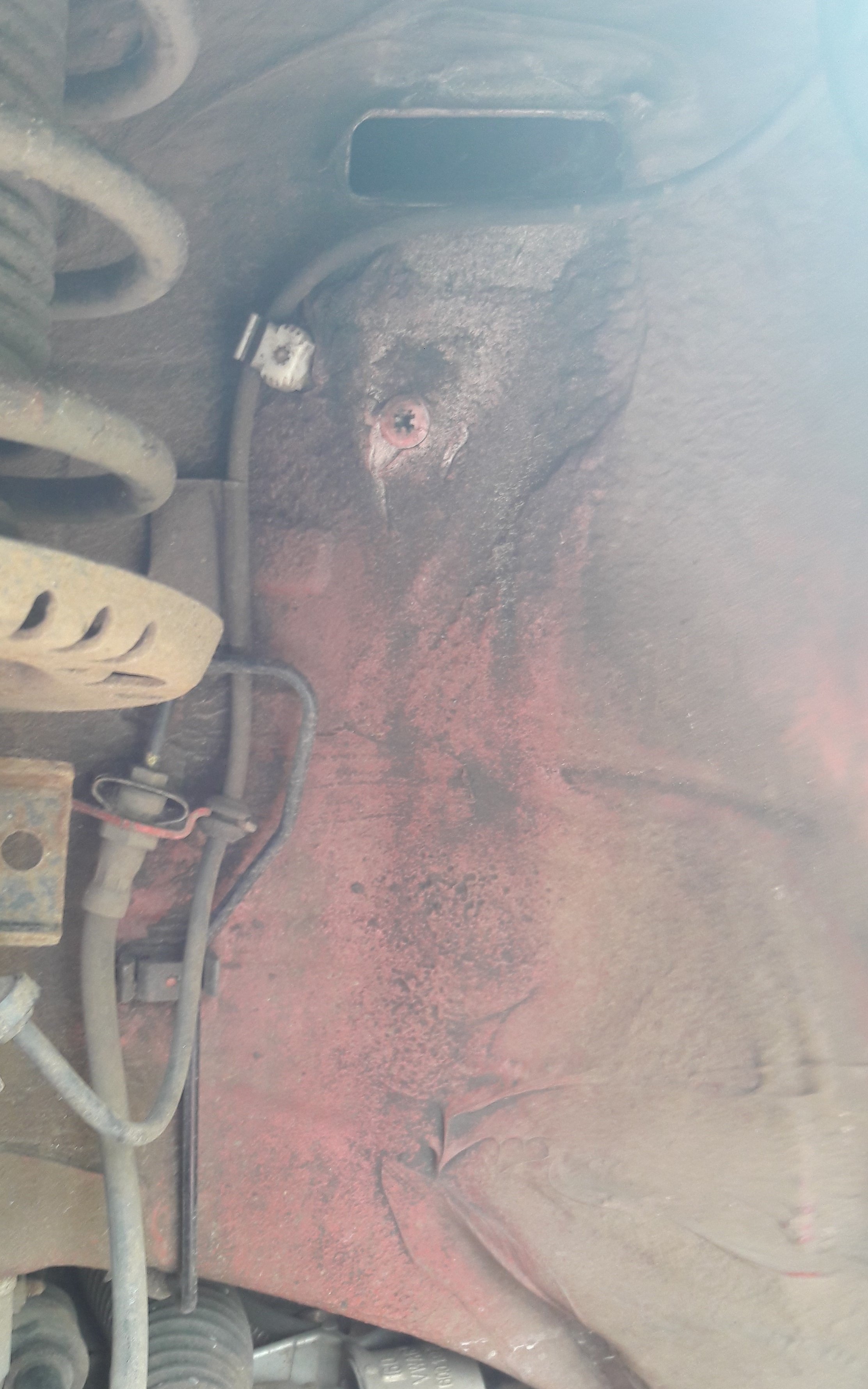

Just discovered a photo from a while ago that I'd forgotten I had.  Looks very much like the outside of the drain, viewed from the wheel arch.
And from slightly further away:
Edited by Wino

So dont have to remove the arch just the wheel then?
  • Sponsor
No, that's with the arch liner removed (during a clutch change, I think). Look at your car!
You may be able to get there with only removing the screws from the rear half of it and bending it out of the way though.
