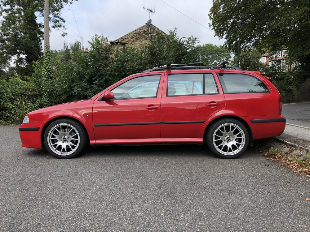

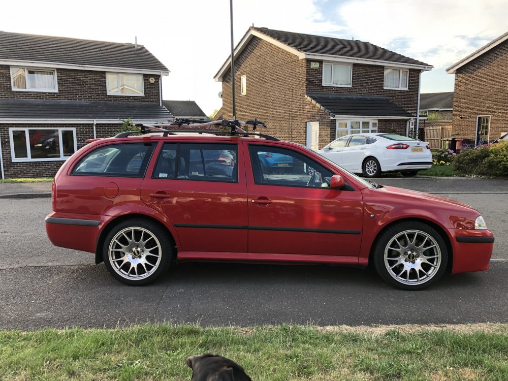

Here you go:
Now I really don’t know :rofl:
Mine has a similar "haunch" to the back - perhaps due to allowances for heavier loads in the boot?
My Red Wagon also has a similar stance on OEM shocks and springs.
@eyestwice - Well, my Elegance is even more raked than that. Of course, it also has new rear springs and the 18 years old original fronts.
-20mm springs should sort it without having to much of an effect on the handling

Yours looks more racked than it should be. Maybe it has non-vRS springs in the rear?

The rears have settled a bit now so I’m fairly sure they’re the correct springs. Tho there is still a little nose-down stance.
Which would make sense when it comes to being loaded up I guess.
I’ll flatten it out when coilover time comes :nod:
