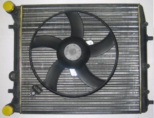

Can I just change the motor? It seems to be fixed through the radiator fins and not screwed/bolted to the car body or rad plastic. There is no fan shroud.

I haven't come across that arrangement, so not sure if it's a factory variant or a later 'DIY'.
Is there any sign of a VW group part number on the fan?
Looks like this. Might not be the correct rad but it is the fan, complete with its socket also fixed through the fins.
Ooh, not as Skoda intended!

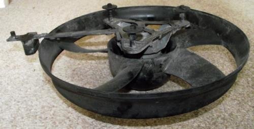

Can't see why it wouldn't be removable without destruction of the rad, it would be a terrible design otherwise.  Can't you see the fixings down the front side of the rad, with the bonnet open?
You're right. Access to front and back fairly easy. 10 minute job. Only two pins in the plug and they still don't fire up the fan on the bench when connected to 12v.
