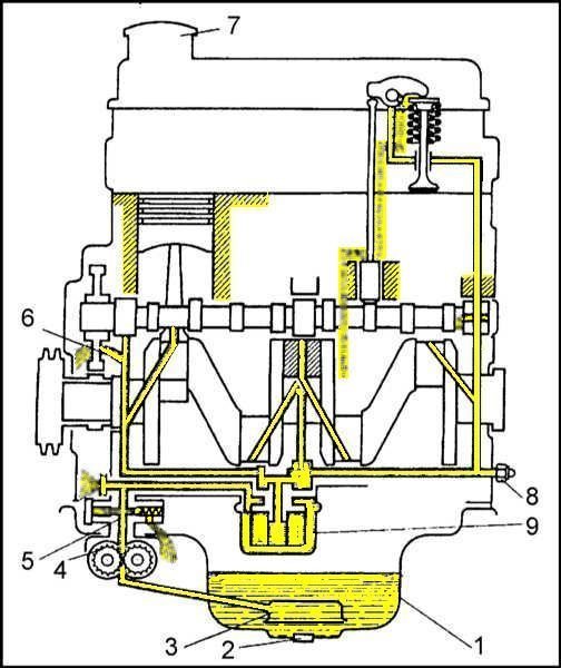

The timing chain job was a success. After carefully setting the valves clearance and ignition timing, the engine is back to its factory performance.
One tip: before installing the new timing chain, make sure the lubrication by splashing hole in the engine block is free. See 6 in illustration below.
So this wear was caused by missing lubrication?
I don't know. I haven't seen the car with my own eyes to be able to have a first hand opinion. I am only counting on information fed to me by my friend and the photos he took. I think it was more a bad maintenance thing.
I added that tip just as a precaution or a prerequisite before installing the timing chain.
