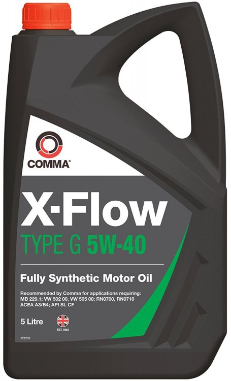

I have just started driving and have been kindly given my nans old Skoda fabia mk1, 1.4mpi year 2000. The oil light has come on so I am looking to buy oil, but I do not have the manual (my nan must have moved it/lost it before she passed away).
I'm looking to get something reasonably cheap as I'm a student. I found this oil on amazon and was wondering if it will be ok for the car?
https://www.amazon.co.uk/gp/product/B002XUR3LE/ref=ox_sc_act_title_2?smid=A3P5ROKL5A1OLE&psc=1
It's this oil: Comma XFG5L X-Flow Type G Fully Synthetic 5W40 Motor Oil, 5 Litre
As you can see I've included a photo and the link on the amazon page.
Thanks in advance :)
That'll be just fine for a 1.4 MPI, however you can use any motor oil you like for topping up, have you checked the dipstick though because it must be bone dry if the oil light is on unless there's another reason?
Perfect.  To VW502 00,  for fixed service intervals.
Maybe look into ASDA if one near you.  Their ASDA VW 502 00  so 5w 40 FS might be sitting about the same price.
Maybe produced by the same producer....

The 1.4 mpi uses 10W/40 oil.
It's just for topping up, it'll be fine.
Yeah, I guess so.

For an MPI I'd use a much cheaper semi synthetic 10w/40 oil from Asda or any reputable supermarket brand. We must have done over 400,000 miles with four similar engines in Felicias and Favorits with no problems at all......just keep it topped up. If the oil light keeps on flashing or comes on permanently, then it needs investigating by somebody knowledgeable and reputable. It might be serious, it might be a minor fault. These engines can use a bit of oil, but that in itself is not a worry as long as you top it up and check it every two to three weeks until you know how much it uses.
