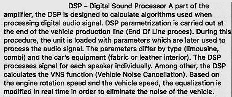

I'm looking to upgrade my Canton sound system by replacing the amp and speakers, but JL Audio advise me that if the car has noise cancelling microphones around the cabin this will nullify any sound improvements I wish to make. I've had a look around the internet but there seems to be a lack of clarity about exactly how Canton implement this technology, and whether it uses extra microphones or simply applies out-of-phase narrowband EQ filtering from the amp depending on the speed I'm travelling. This text sample is from the Canton technical manual (which I don't have but would love a copy), and it's very ambiguous. Has anyone upgraded the Canton system and run into any obstacles?

The description doesn't say it's using microphones. But... the description could be misleading, or I'm misinterpreting it.
If it's using the speakers to play anti-noise, and if it doesn't use microphones, then I can only think it's working in open loop, without feedback. Then it needs the speakers to behave in the expected way. If the speakers change then the anti-noise will be wrong.
If it just changes the EQ on the music dynamically to boost frequencies that would be otherwise be drowned by the engine then it's maybe not such a big deal.
