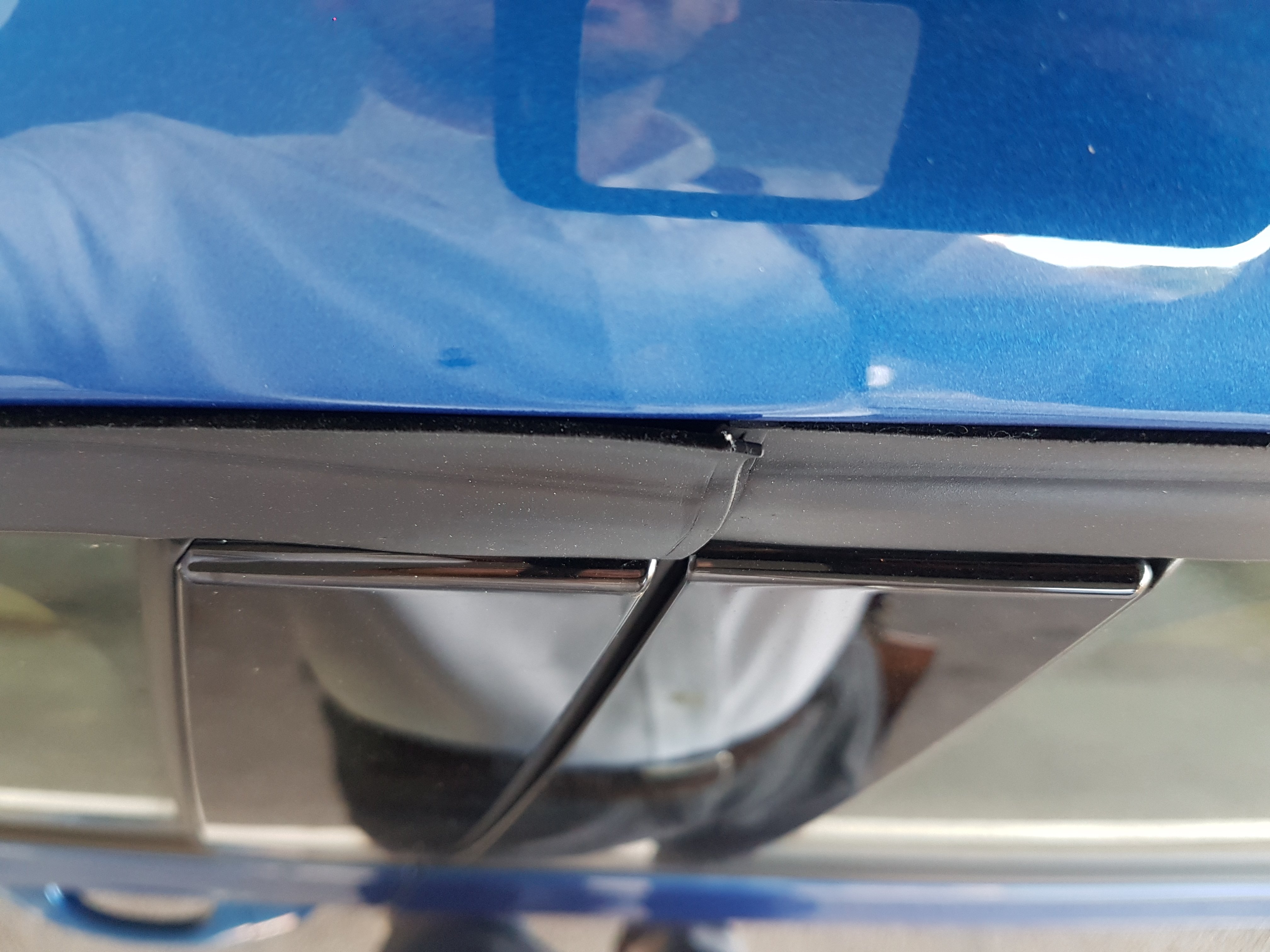

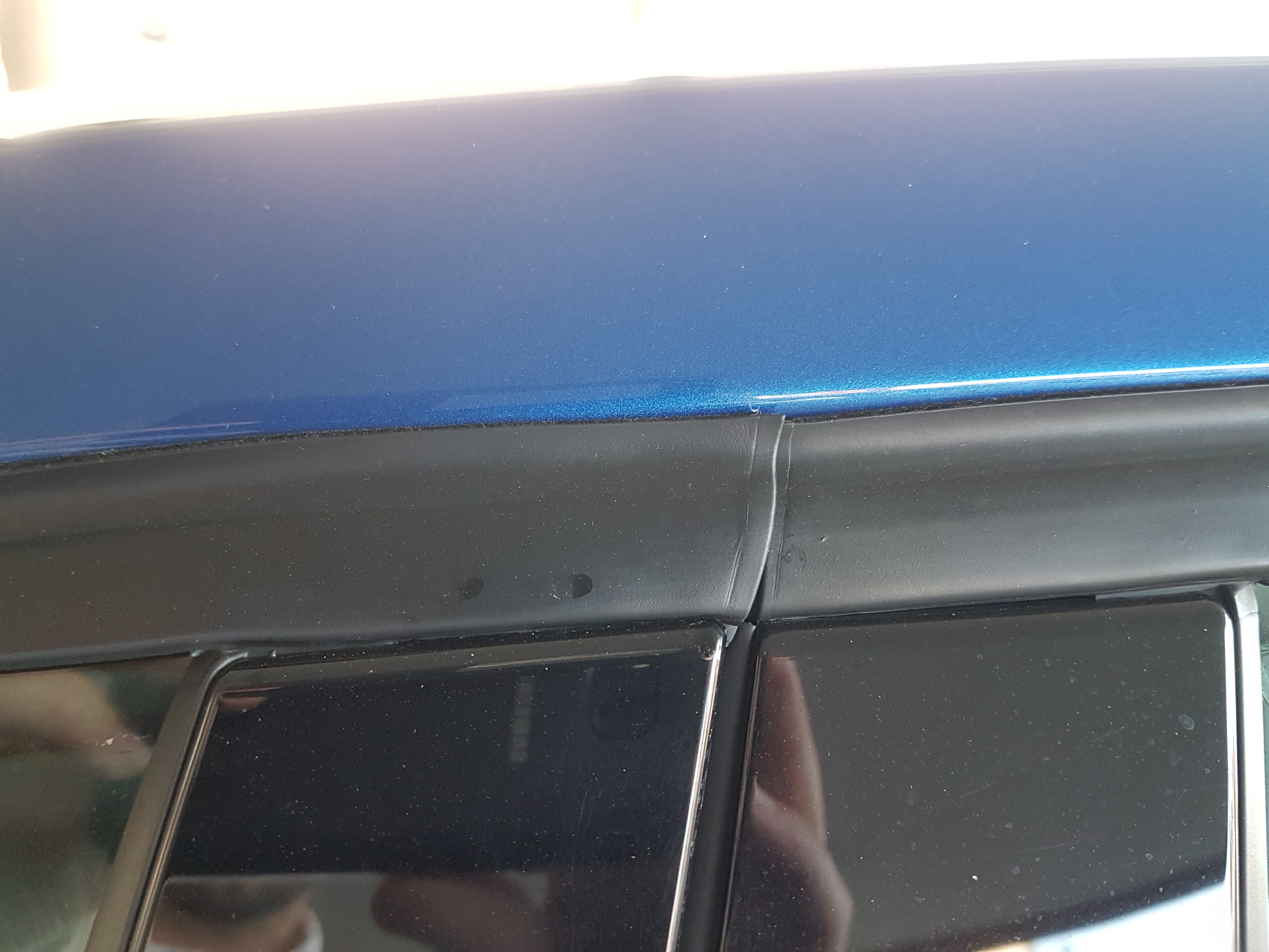

As for the gap I have the exact same thing. I tried forcing it into place but it stays offset. I did however check when pressure washing and there is no moisture coming in.
Good to know the gap is "normal", thanks.

1 hour ago, paulsoava said:
Here is what mine looks like
Great, thanks for that! That's exactly how mine are :)
Wouldn't be an Octavia without getting moisture on the inside of windows.:D
That doesn’t look right to me. Rear one looks bent.
Well it is bent. Actually, it is the front one I presume (left in the picture; driver's side on LHD car). Car was new, didn't notice when I picked it up from the stealer's. Afterwards I checked for related problems but all seems fine. I inquired about repairs but they offered to change the whole seal and plastic. Too much of a hassle and at my expense. So as long as nothing happens I just came to live with it.
