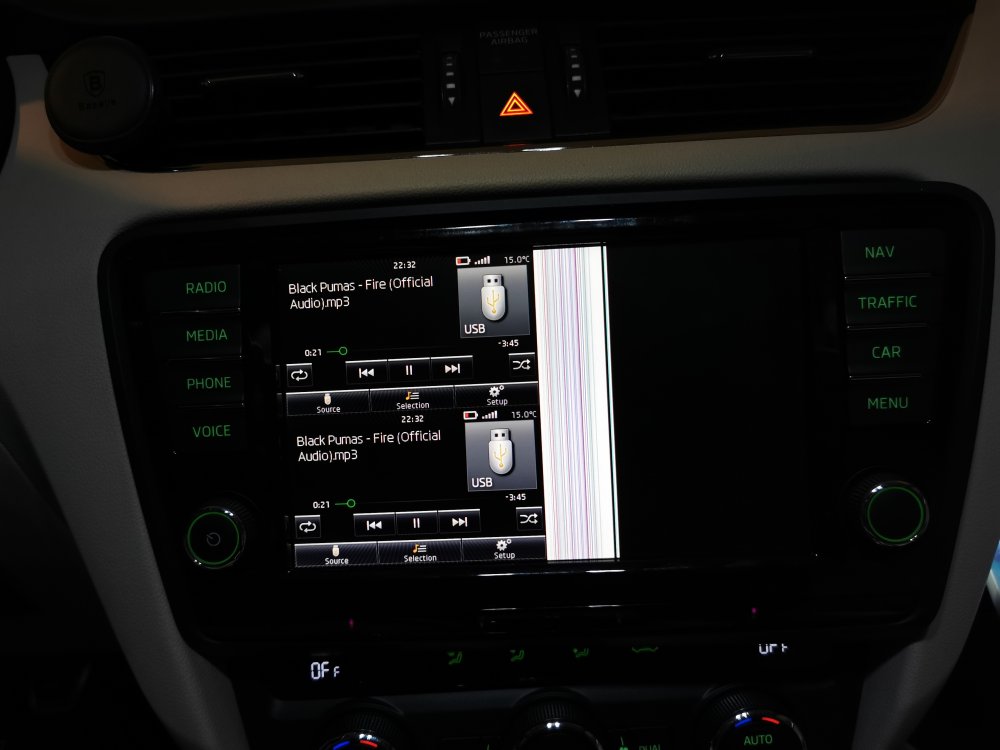

It’ll have 2 SD slots if it has any kind of nav unit in it. The MIB1 Amundsen has a 5.8 inch screen and the MIB 2 Amundsen has a 6.5 inch screen. The MIB1 Amundsen has a CD drive, the MIB2 doesn’t so if the unit has 2 SD cards and no CD drive you have a MIB2 and you can plug in an 8 inch screen no problem :)
It can be quite hard to tell the difference between the 5.8 and 6.5 inch screens but hopefully this helps
MIB2 on top and MIB1 at the bottom. There is a slight difference in the thickness of the bezel. Once you pick the car up, take some pics and post them up. I’ll be able to tell you exactly what you have.

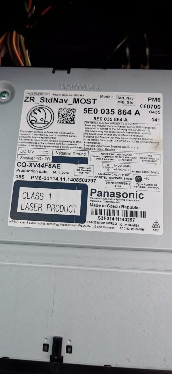

Not quite, perhaps I’m not being clear. If you have the smaller screen, 2 SD card slots and a CD drive then you have a MIB1 Amundsen and you cannot upgrade the screen.
If you have the smaller screen, 2 SD card slots and no CD drive then you have a MIB2 Amundsen and you can upgrade the screen.
When you pick up the car, post up a picture of the screen, the glovebox unit and a screenshot of the system information and then we’ll all know for sure :)

Its a 2 sd card only unit :party:....
Oddly as well the instrument lights on the dash are white on my model so the MIB2.5 Amundsen screen will match just fine

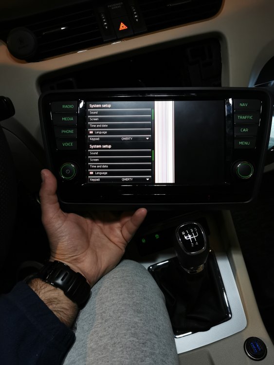

That’s a MIB2 Amundsen so an FL screen is a straight swap :) The dash and steering wheel on yours should have white lights and the rest should be green. The FL panel will have white lights and the rest will stay green which is exactly how the FL cars are anyway. Keep an eye out for an FL screen as cars equipment don’t have any in again but there’s a 2018 vRS breaking on eBay right now which may have the screen still on it. People will try and rip you off, don’t pay any more than £250. I paid £200 for my Columbus screen but I’ve seen people trying it on for £400 plus.

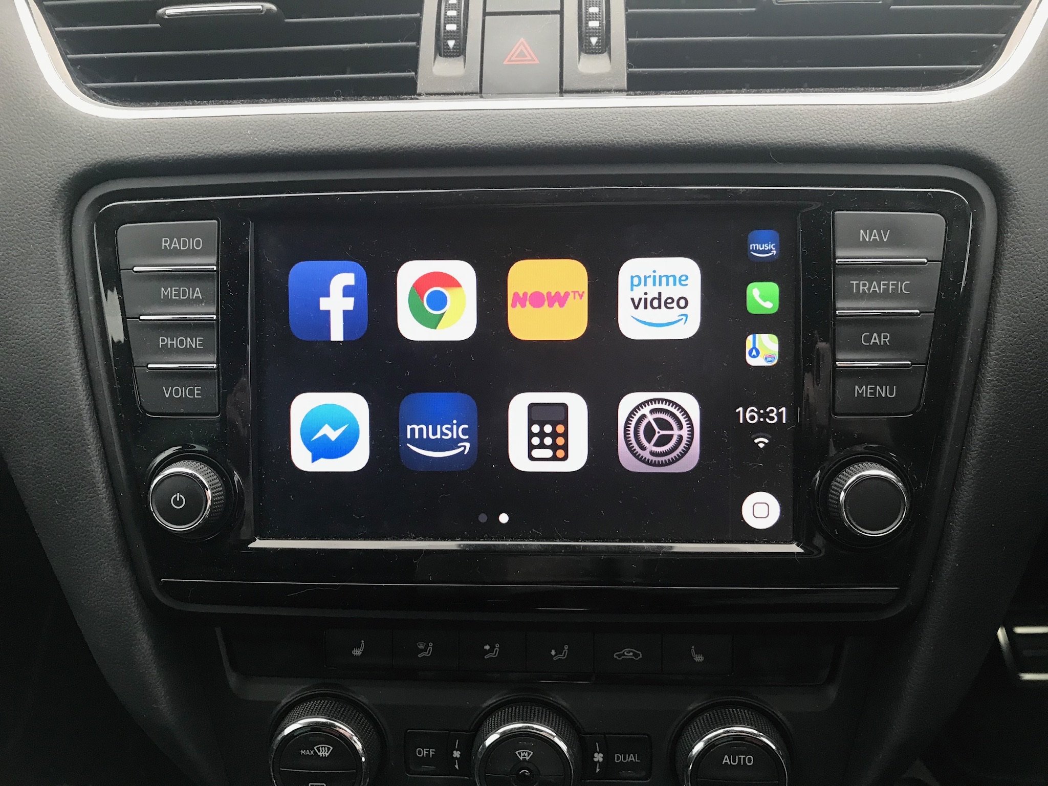

It does nothing. It links back to SmartLink on the FL but the pre FL MIB2 doesn’t have the algorithm ready to do that. AFAIK you’re stuck with it. You can watch Netflix on a jailbroken iPhone via CarPlay. I watch Now TV & Prime on mine while stationary of course :)

That’s the Columbus FL screen. SmartLink requires a USB plug in which on the Octy would mean a visible cable but I have rerouted the cable to the centre console so it cannot be seen :)
