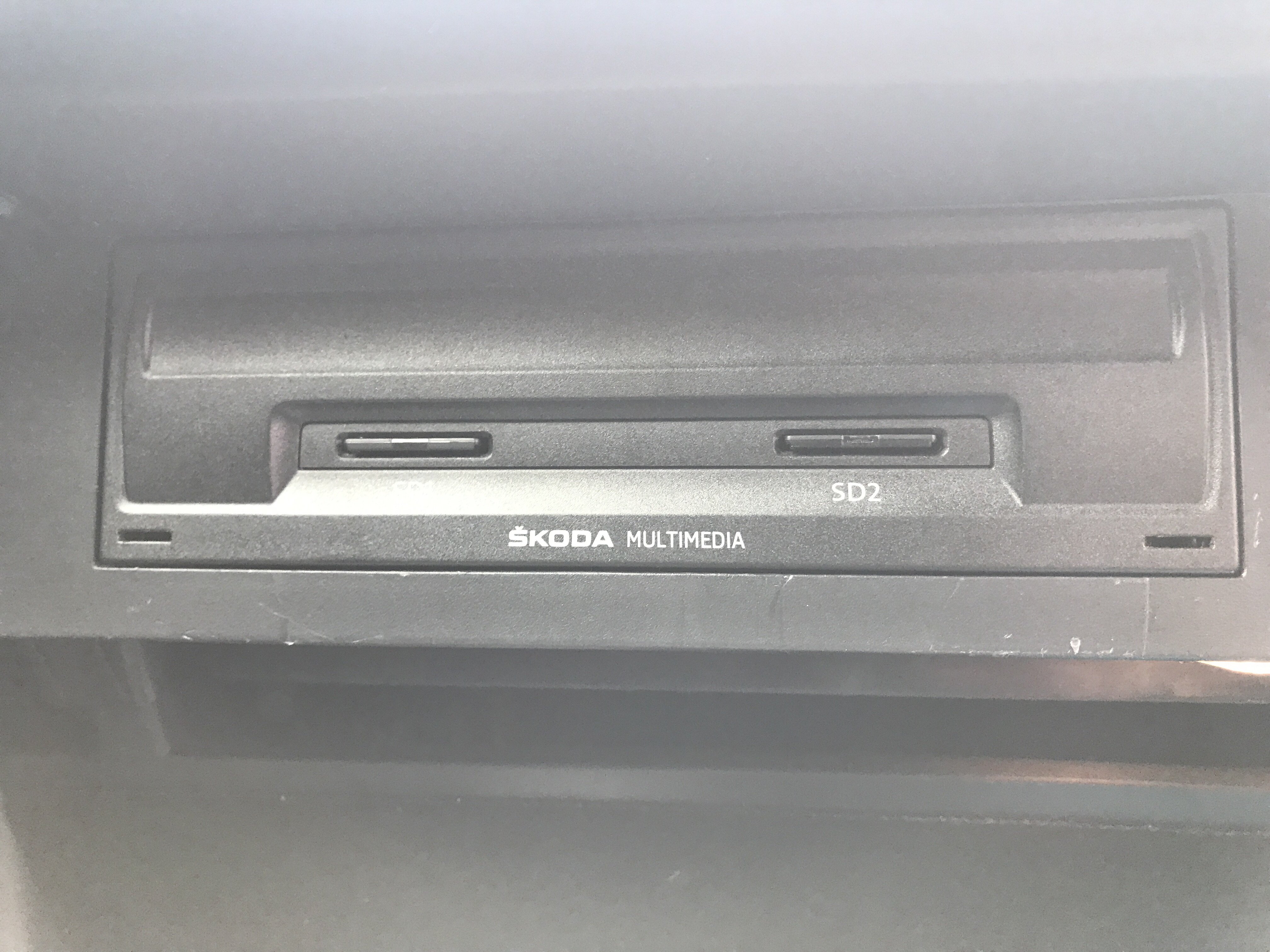

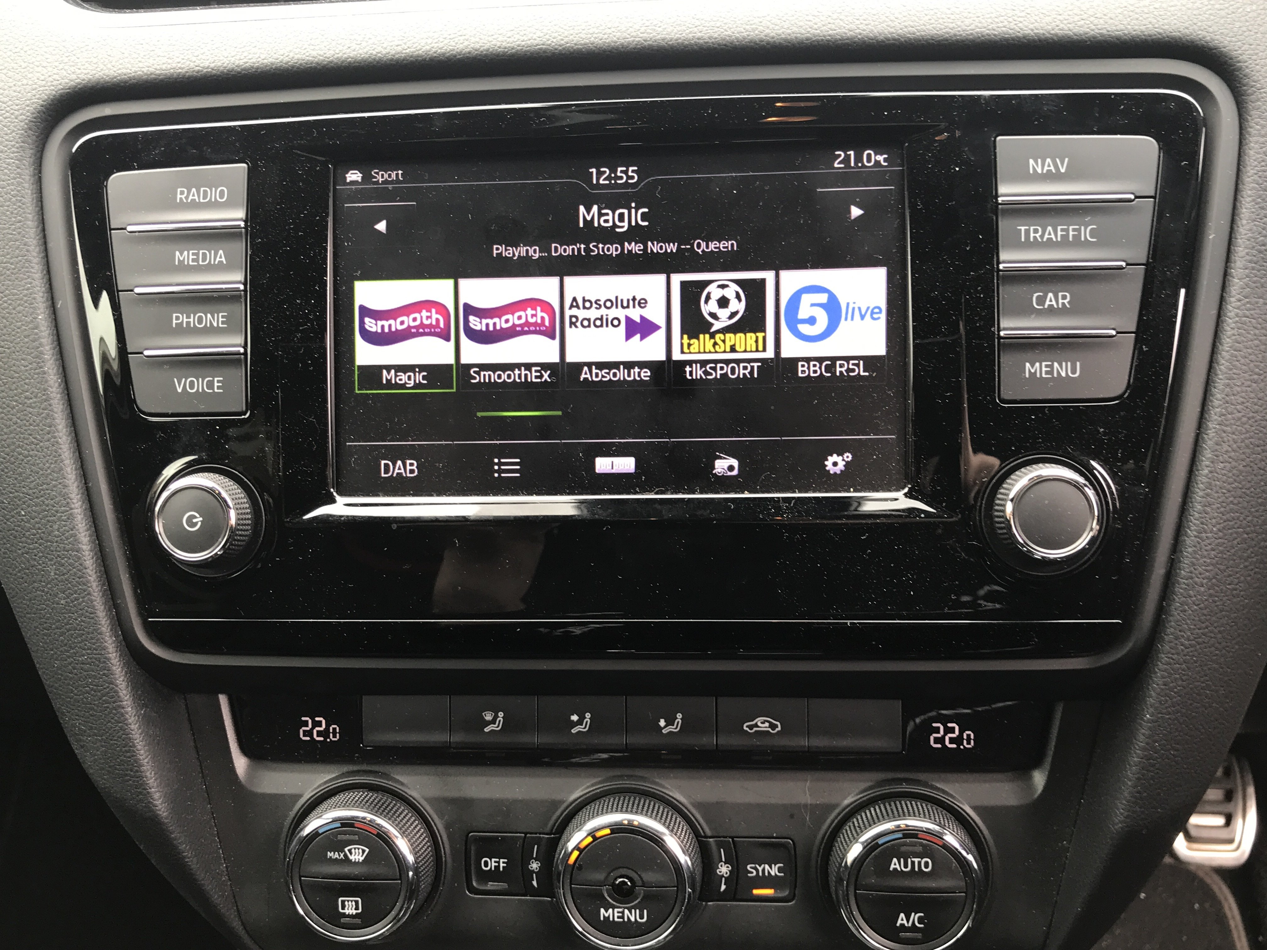

I’ve got MK3 2016 - I have got the Amundsen screen the unit with 2 SD slots as images below the lights on the screen are all green.
I'm interested in getting the bigger screen and like the newer version on FL Octavia.
dvd playback and such

Sasha's post on the previous page covers it I think. Pre-FL Columbus screen or FL Amundsen screen are a straight swap to get a bigger screen but don't get you DVD playback. For that you'd need a Columbus glovebox unit and screen.
As above, if you want a DVD drive you’ll need a Columbus unit. My unit has Video In Motion unlocked but I dunno if that’s just for MirrorLink or if you can use an SD card to store a video. I will give it a go at some point :)

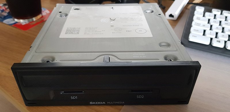

@SashaGrace thanks for the help today, you know your stuff. got this unit and the shark fin and usb connect for £150 all in, just need the 8" screen and maps card then for Pawel to do his magic.

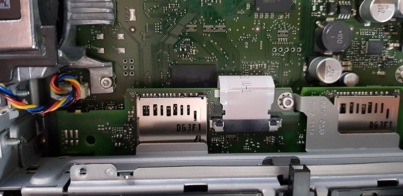

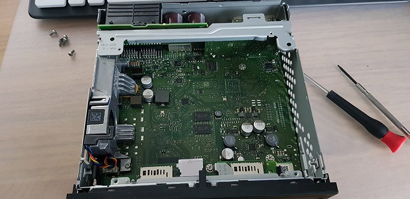

I open it up as id heard someone talking about a HDD conversion, cant see anything other than the SD ribbon slots. There may be a slot on some models for a hard drive or SSD but must be the newest models, nothing here to see except the silver unit at the back which looked big enough to house a SODIMM style card but it was welded to the PCB

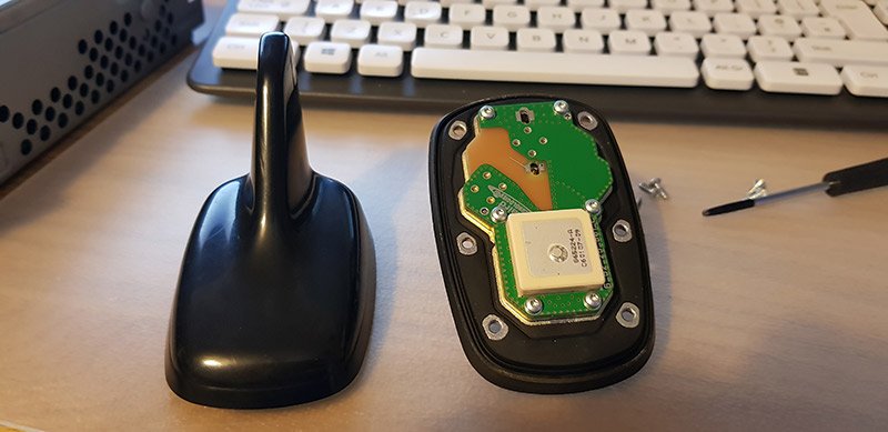

so with the bolero MIB1 you need a GPS antenna and i wanted it to look as factory as possible so got the sharkfin for almost nothing. This one is GPS only you can get all four connectors DAB aerial would be nice as my reception is gash at the best of times. don't need the phone box as my phone is too big and i already have a xvida magnetic charger and dont need to cable up the phone. I will be bricking it cutting the hole and might get a body man to do it correctly :sweat:
plastic fin... you can guess what im going to do with this? yep carbon dip!
blue GPS connector

anyone got an image of the cut/aperture for the fin? is doesn't look round from the shape of the spring clip? that would be too easy :dull:

@JohnnyType2 the HDD is in the Columbus only but all that looks a bargain. If your using the proper GPS connection you may not get the GPS fault in the module that I have.

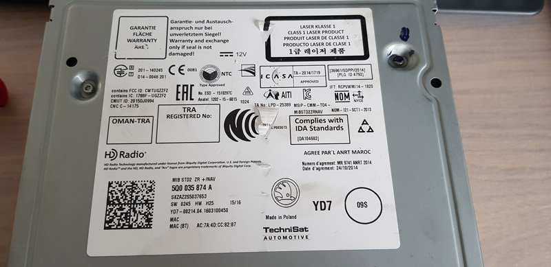

My pleasure - just pls note I'm not available between September 15th an 30th so either you have to wait till October or ship it ASAP using some fast delivery.
BTW: two more units with forum colleagues, Amundsen 5Q0035874A and Seat version of Amundsen, named Navi System, 5QA035858.
