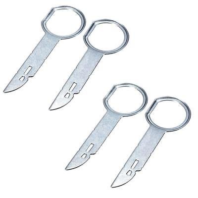

what type of removal tool do you need to get the screen out?
just four euro stereo removal key, pennies on ebay or you can get them from halfrauds.

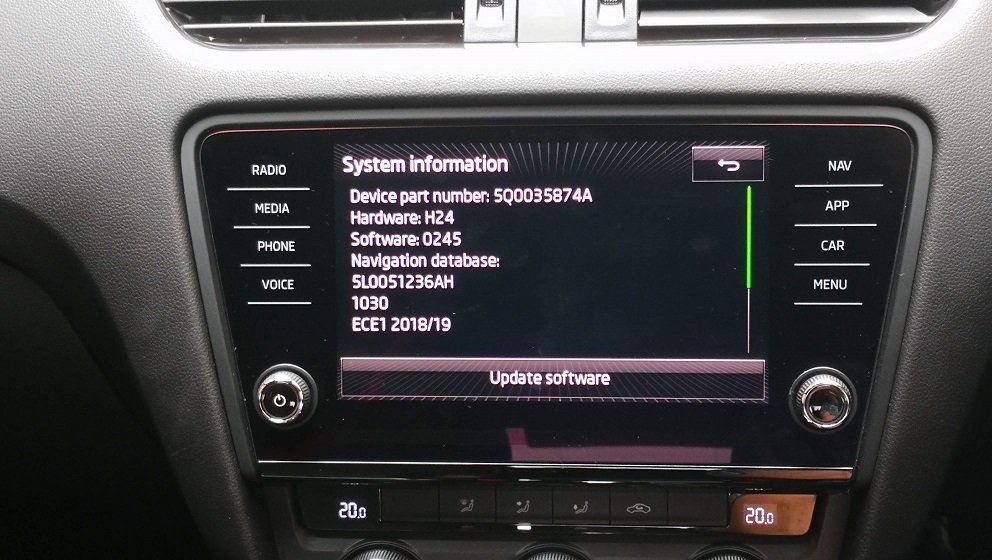

So far this has been a real headache for me :(
Currently running Bolero MIB1 with canton, bluetooth and handsfree and want to upgrade it.
I found an Amundsen MIB2 head unit (5Q0035874A) and screen (5E0919605M) for 526 euro including shipping to Sweden. But I still need to remove CP, probably do SW and/or HW-hack and apparently also find a Canton MIB2 unit as well.

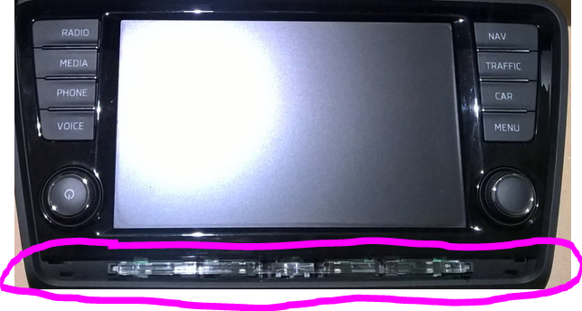

After a few days searching I found a decent Columbus MIB2 screen (5E0919606) and head unit (5E0035043D) for the same amount as the other package which is probably a steal but the bottom frame of the screen is missing something, like an insert. Can I use my Bolero MIB1 insert? If not, are they easy to come by?

By the way, regarding the bottom frame in my picture. Can I put in the one from my Bolero MIB1 unit, does it fit?

Can you get away with just using 2, ive found 2 in the garage ?
9 minutes ago, BlockABoots said:
two to remove the head unit but you will need four to remove the screen
My bolero MIB1 is the smaller screen 5" and doesnt have the bottom detachable bar, i cant comment... but from the picture it looks similar.
Will these do.....
1 hour ago, BlockABoots said:
Will these do.....
yes they are spot on
