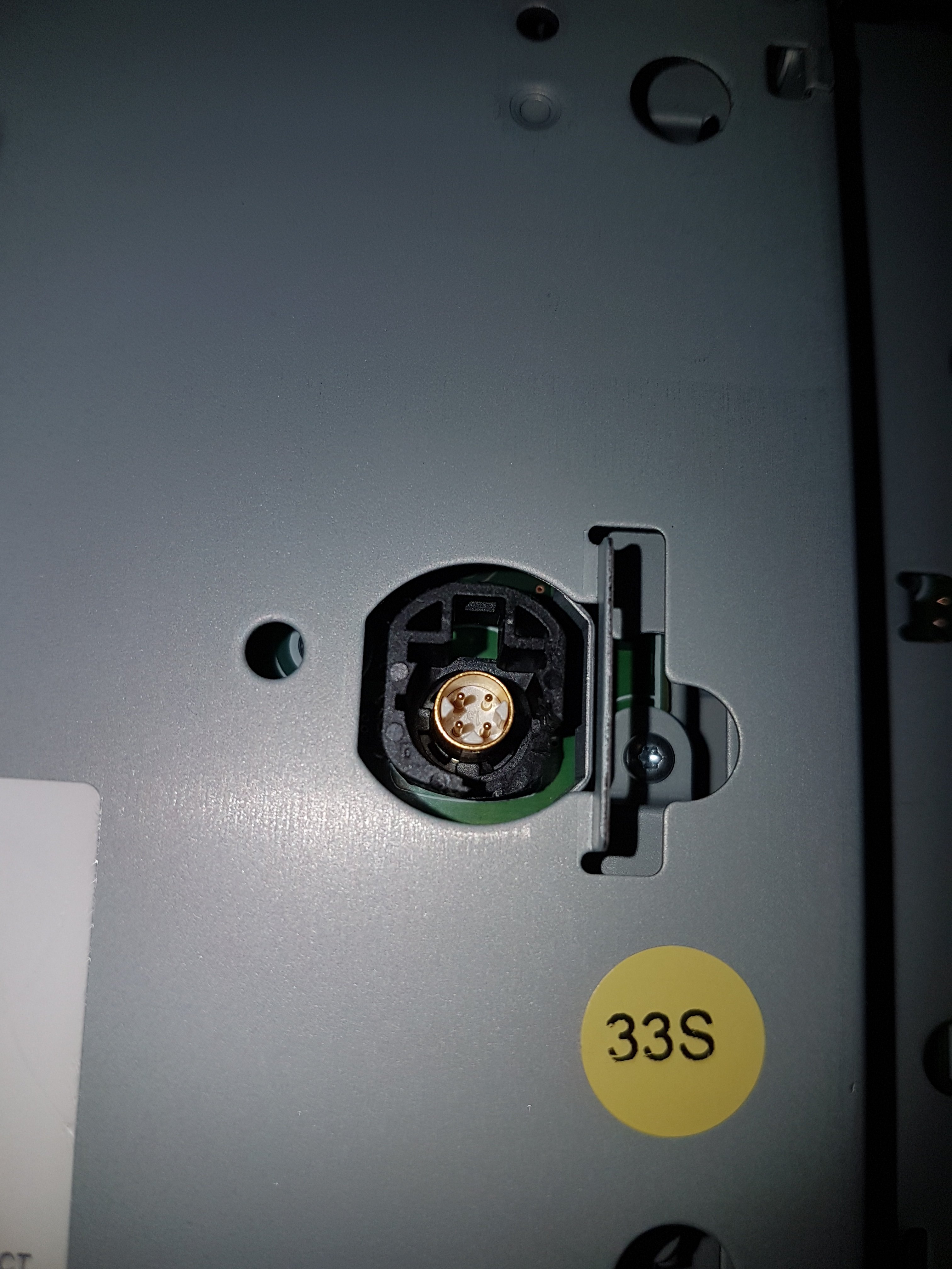

I have a Bolero MIB2 with 6,5" screen and 800x480 resolution. And I will try to use a MIB 2 columbus screen with MIB2 bolero system. The input plug is a bit different on the screen so I will mill the missing slot for the plug into the plastic shell of the input of the screen - I don't want to slice the plug from the car cabling. I was just saying that when this columbus screen is used with its own columbus system all the elements are graphically reduced so to include more detail into the larger screen, but when this screen is used with the bolero mib2 system I think this will not occur. Bolero will just fill the larger screen as it does with the 6,5 inch - it won't show more it will just show bigger. For example 6,5 inch bolero screen displays 5 fixed radio logos at a time, since the columbus displays six fixed radio logos - so shows more detail. And this is all over the interface. It will be great if with bolero mib2 happens the same and I'm asking if someone has any experience to share?

VEEEEERY NICE! So I'm in s hurry to do this slot and finally plug the display. I will share photos or even video when it is done.

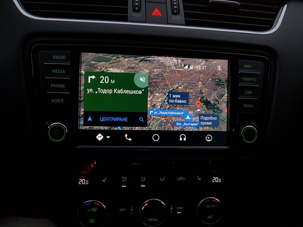

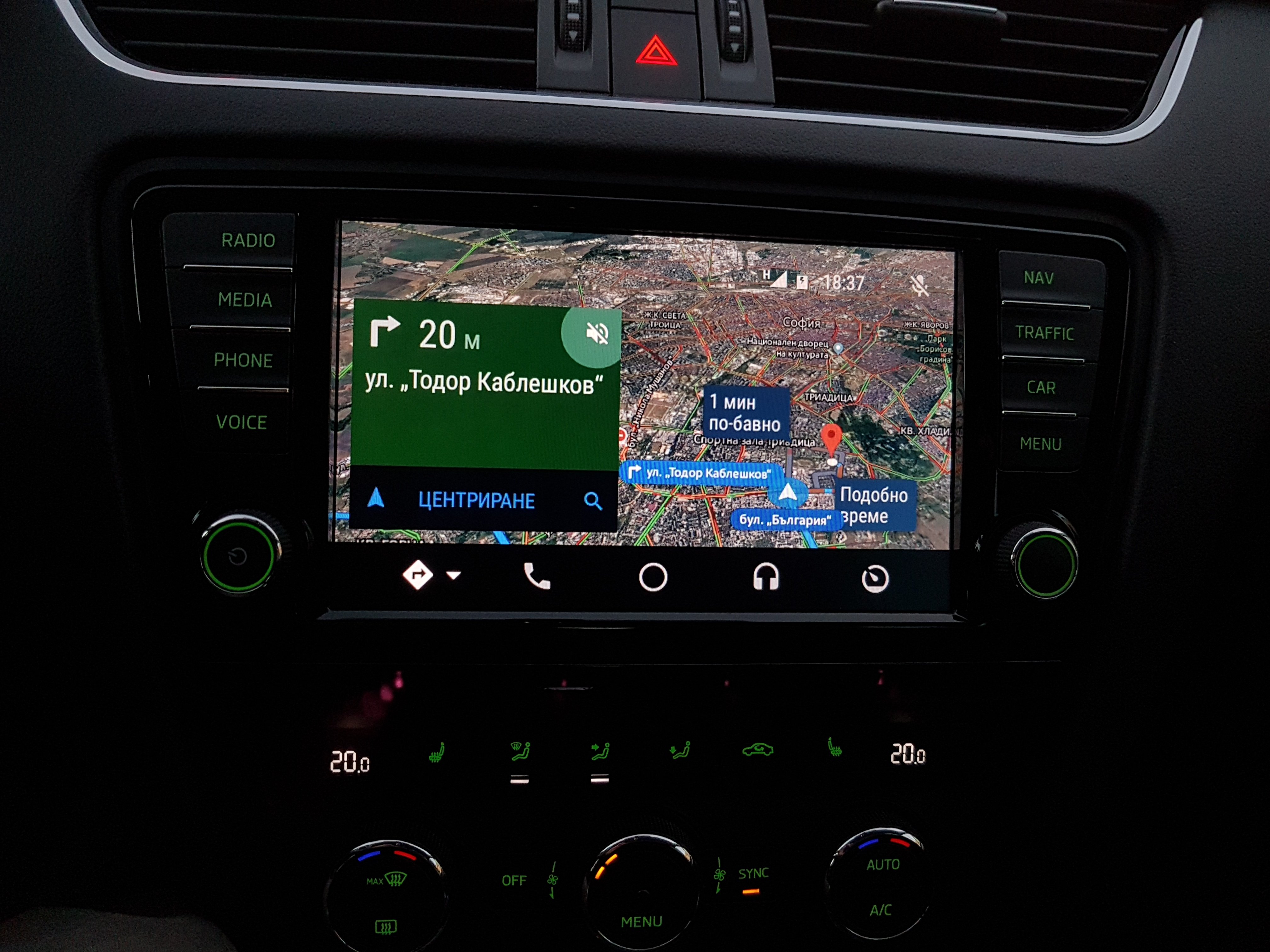

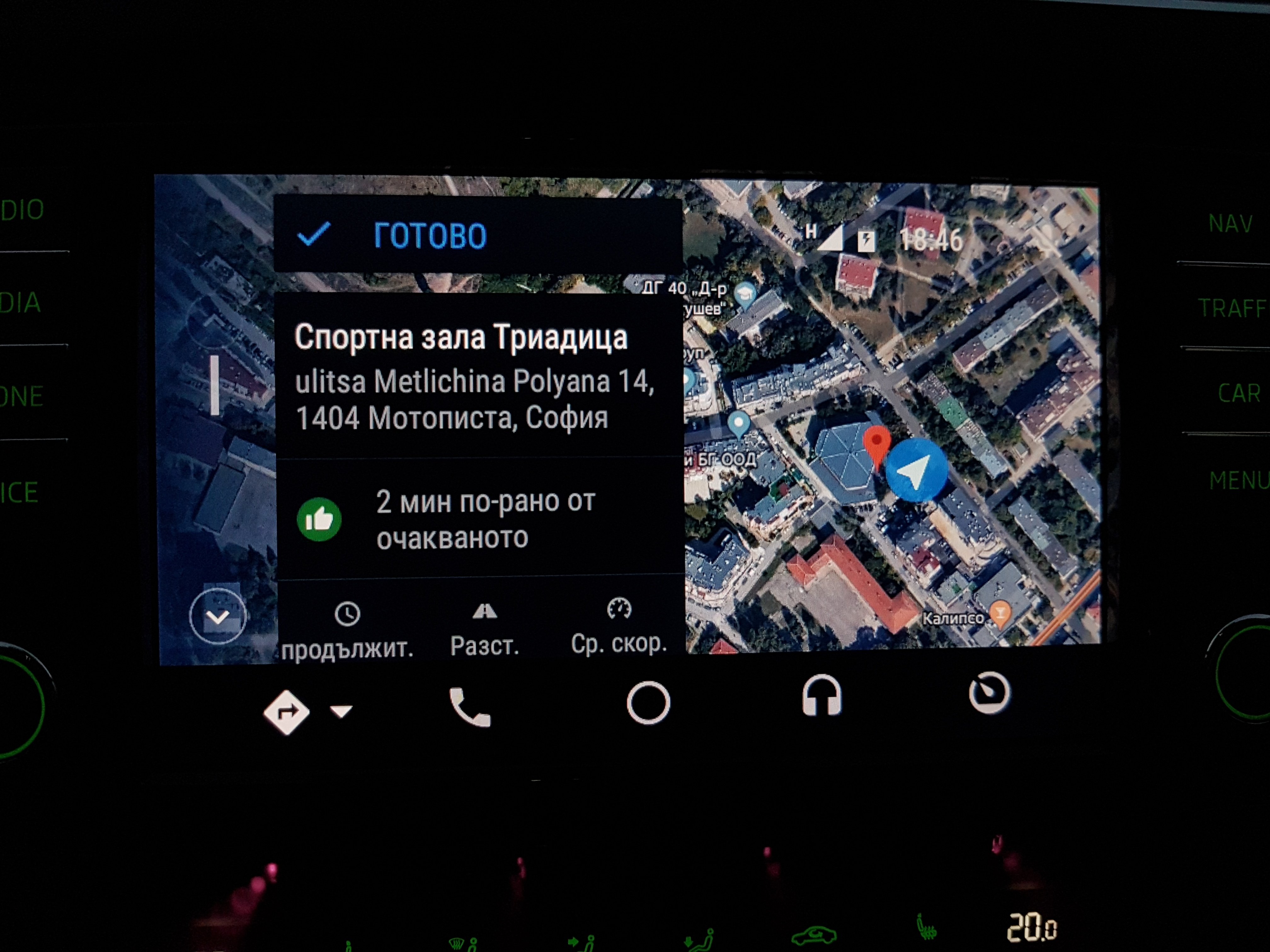

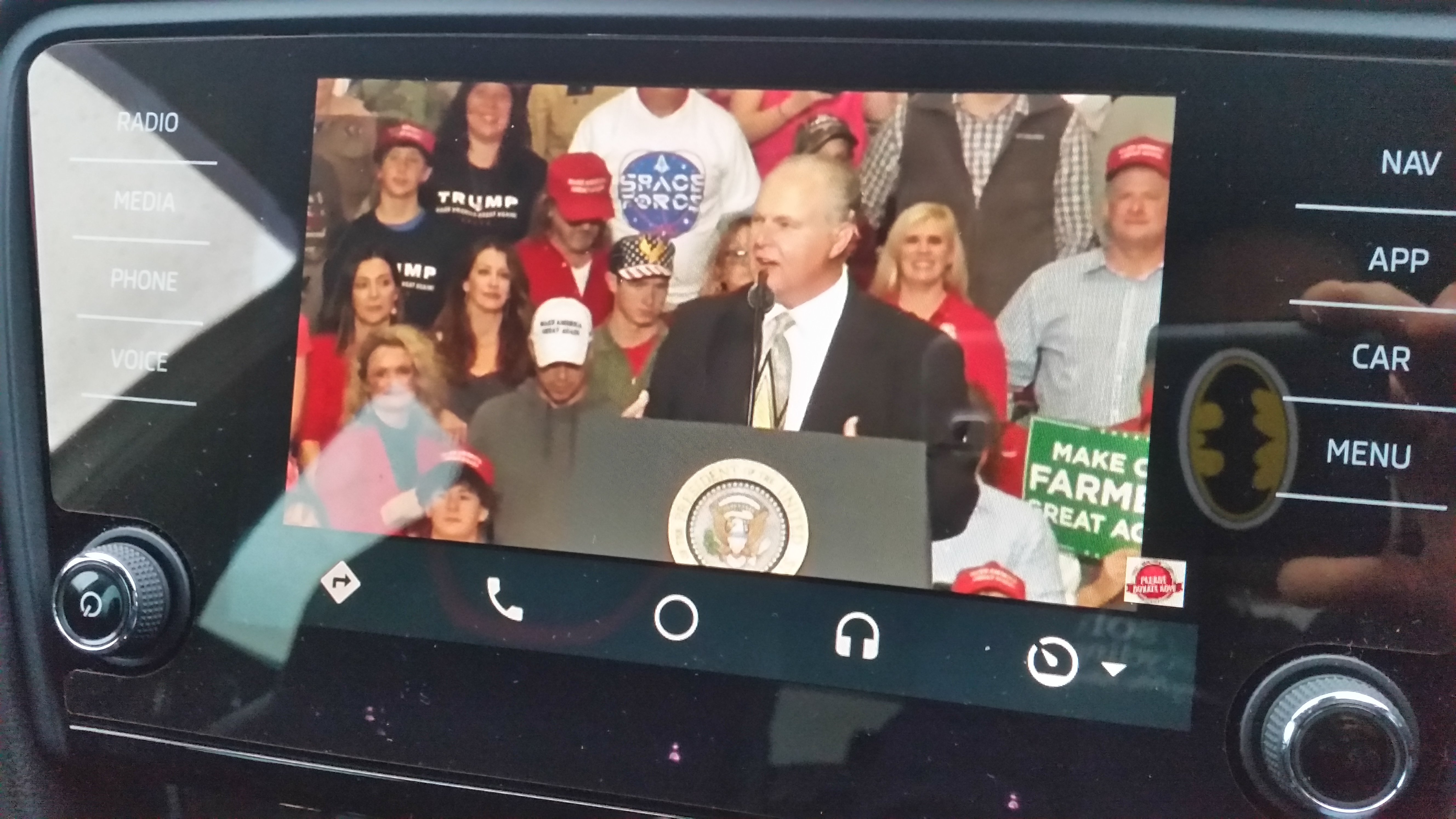

Mission succes. I'm posting some mirror link magic - samsung s7 fully operational on my new flat TV in a car. I'll post some photos too in next post. Gee I'can even start remote desktop of my computer situated in the office and start outlook, see/reply mails etc. That is cool! The screen rocks.

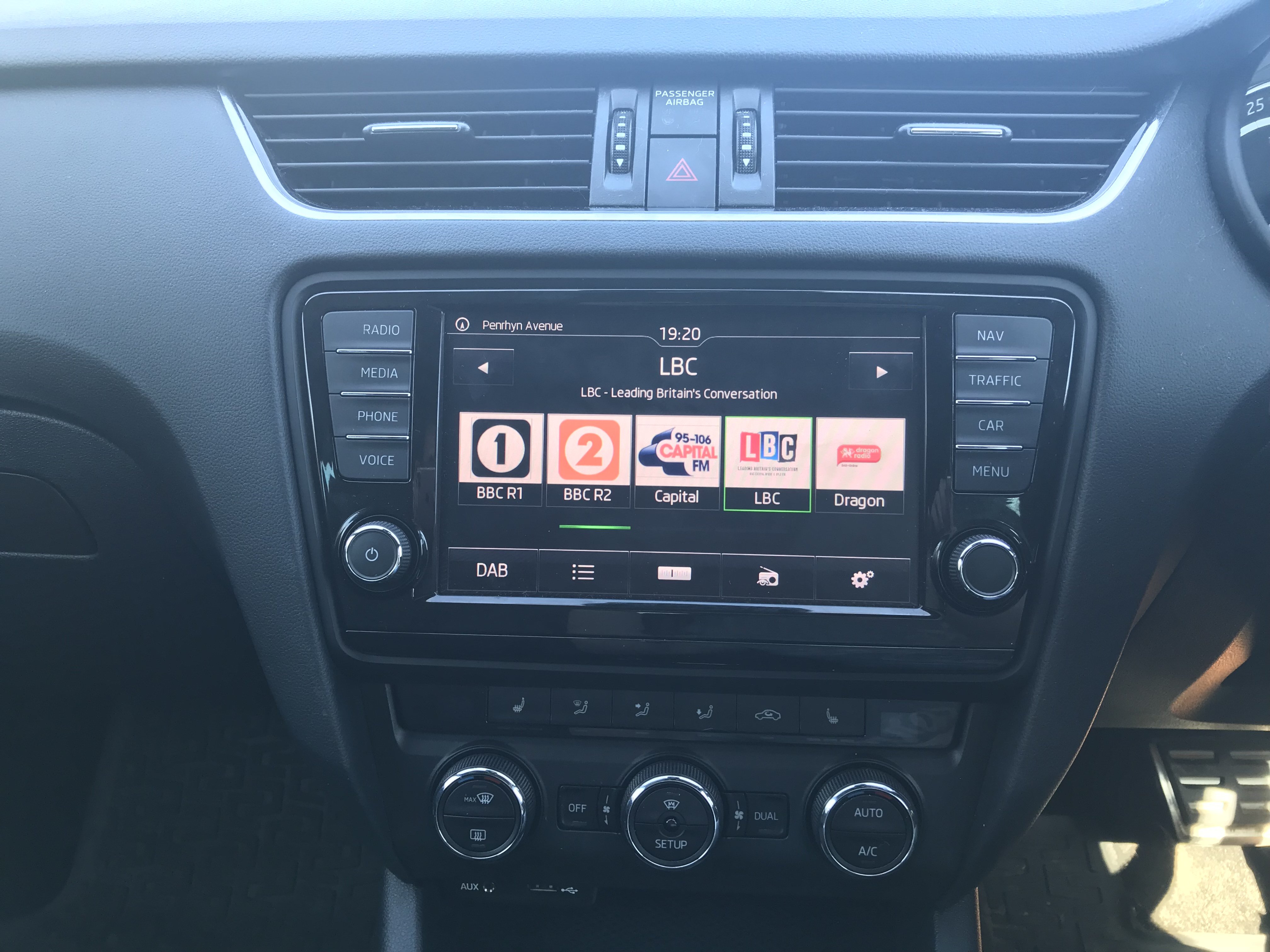

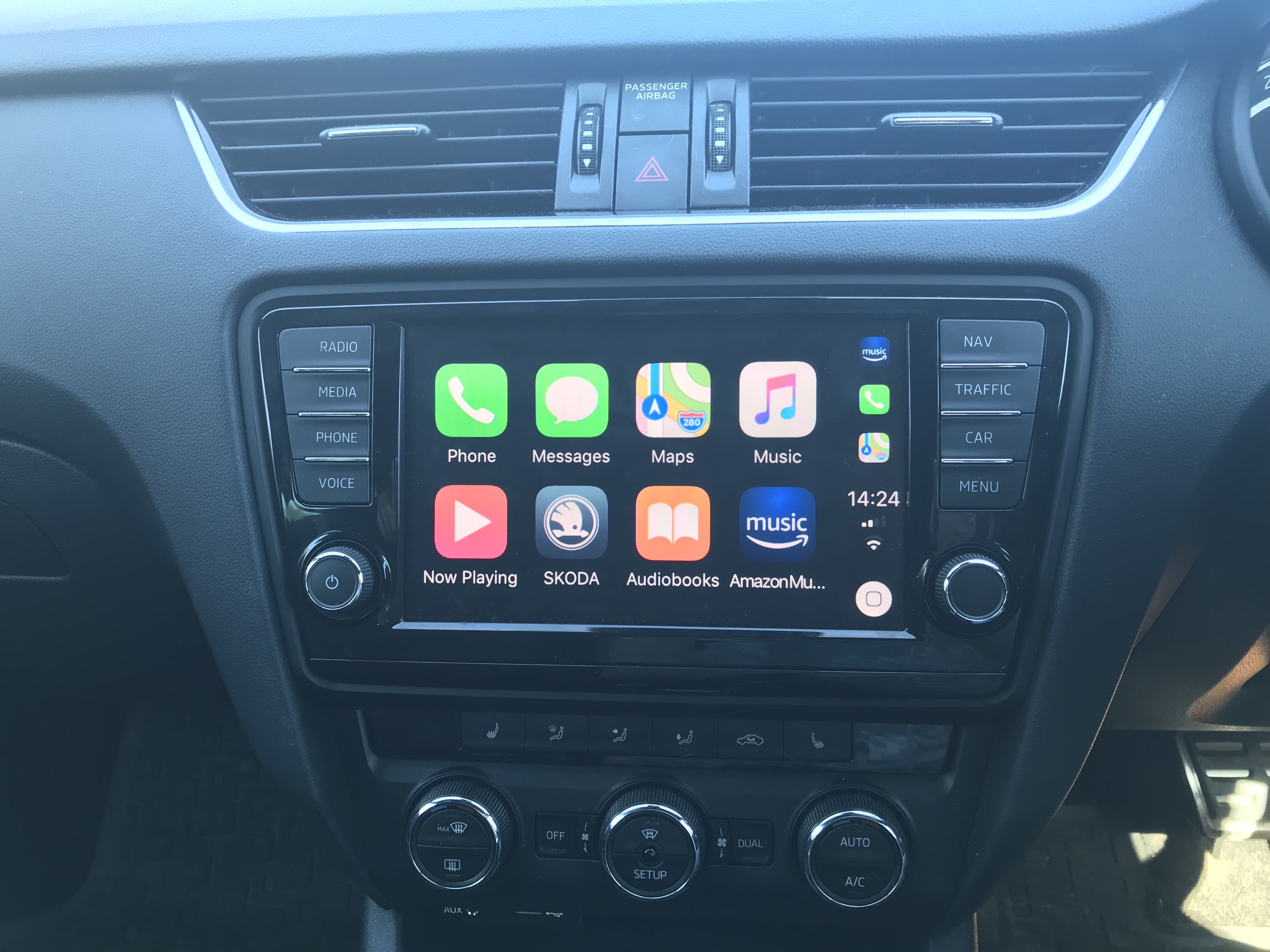

The plug on the columbus screen was successfully formed since the car is still on warranty and cabling is intact. Applying some photos.
well i have my unit back from Pawel and its working perfectly. The only issue is to get apps like youtube etc to work the phone needs to be rooted/jailbreak and i have a Samsung S8 which are notoriously difficult. I've bricked it a few times but when i get it working i'll report back.
the flat touch screen is beautiful though, well worth the money.
Nice one, glad you are happy with the install. It’s made such a difference to my car.
Happy new infotainment! There is no need to root. You simply need an android 7 which is done very easy with official samsung firmware and a samsung upload software. Then you need LG MirrorDrive version 1.2.1.2, EasyTouch for easy home and back buttons on the main screen and Nova Launcher to have landscape home screen of the phone, since it is needed to be landscape when connected to the car. By this configuration you get your full phone on the car's screen. I've published a video previously. You can start any app in your car - remote desktop, TV channel streaming apps, anything. LG Mirror Drive requires to be started a few times after the first approach to start an app, but after that it works solid as a rock. I even tried the augmented reality navigation of sygic projected on the car's display, but you need to put your phone on stand on the front glass since the camera is used to see the surroundings and the app augments the navigation route on the surroundings - it is so coool, better than a HUD.

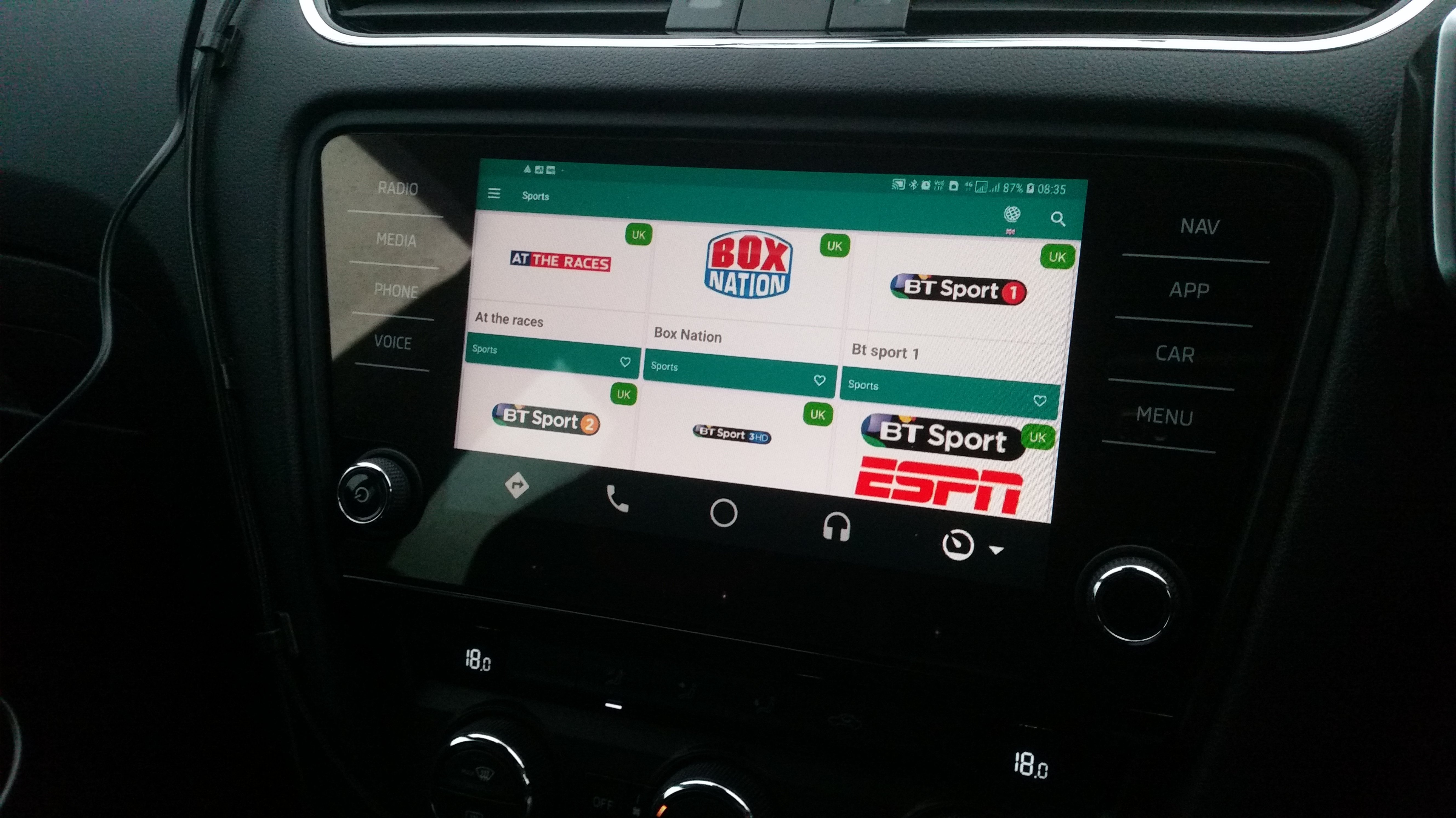

it was actually a pleasure driving home today, i got AA mirror link to work after finally rooting the S8+, i have to say its amazing!! the screen makes such a difference, thanks sash and pawel for the help!

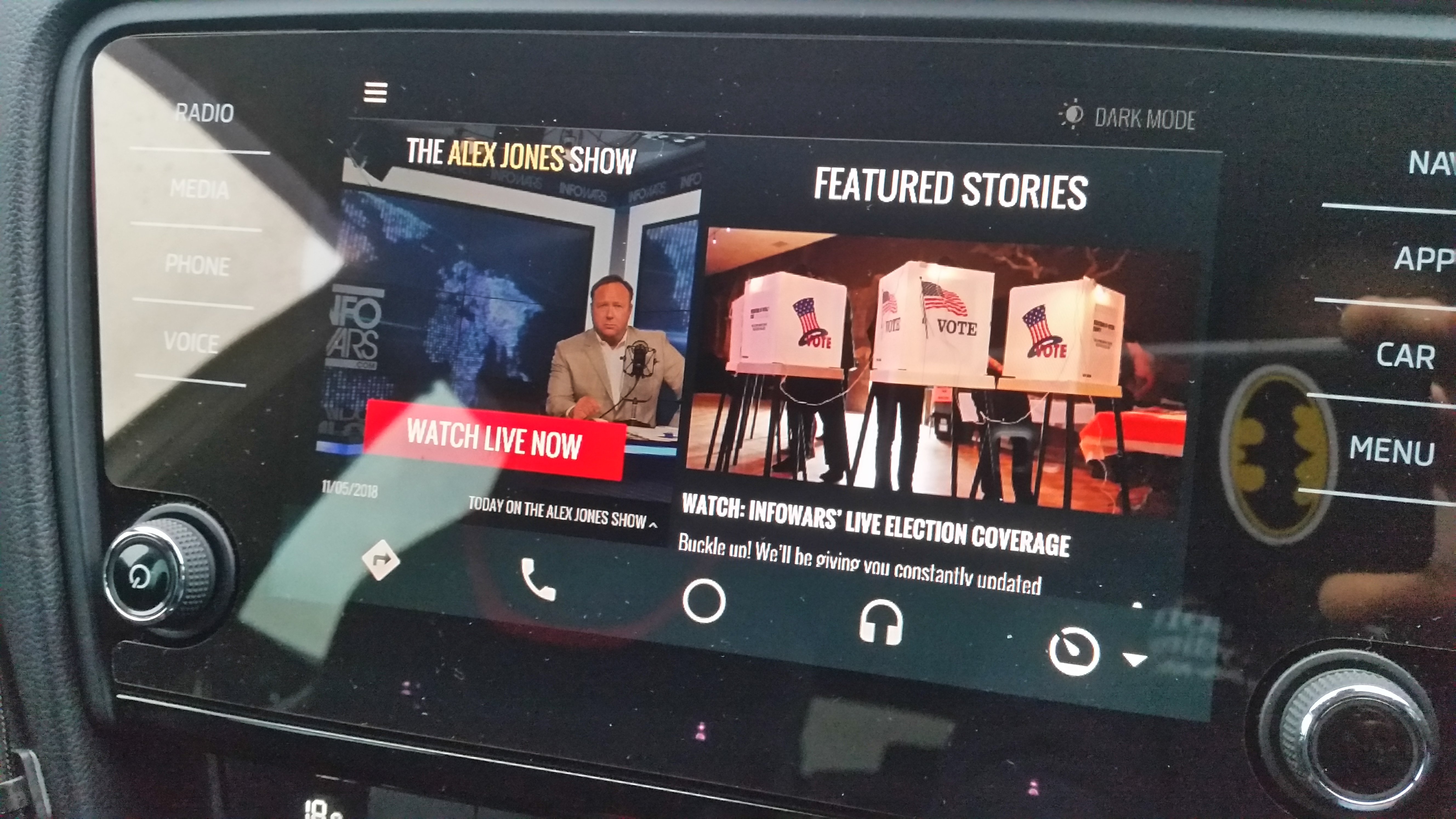

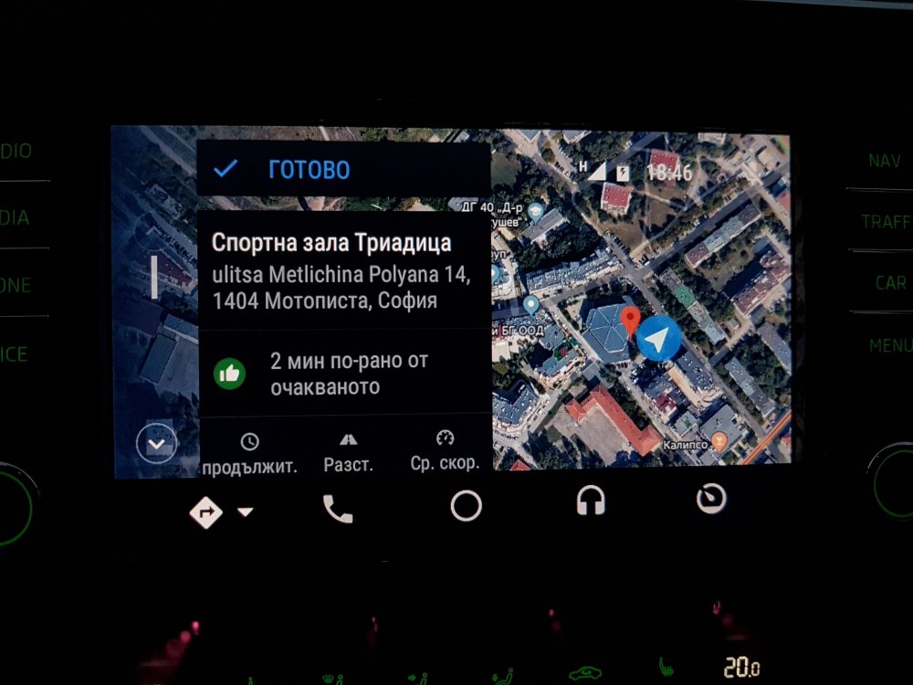

Android Auto working on the 8" touch screen! Im not happy with the icon setup just yet and i think it might be an S8+ issue, due to the massive scren and much higher resolution than the 8" screen, when you unplug from the headunit it leaves the phone with small offset icons which is not ideal and the phone nedds restarting. You also have to manually select AA mirror where in the youtubes ive seen it just starts straight in to mirror.

ive rooted an S5 (took 30 secs) and im using it as a wireless client for the Android auto. the S5 is a much better ratio screen for the headunit, the icons dont get so spaced out.
The display looks great. Do you find sensor buttons to be better for interaction? Bottom AA button line eats quite a space but otherwise it is nice that you can seamlessly switch between the android auto functions and the screen of your phone - it is worth trying. Can you give some more details on what release of AA mirror you used and why is it required to root the phone. Is it because the newer versions of google services forbid the AA mirror? And when you use AA mirror do you get actual screen of your phone 1:1 or it is some kind of summary list of extracted phone apps and some might not run properly under aa mirror. Any other impressions and remarks on AA mirror usage will be greatly appreciated. And for your safety don't watch netflix too much :) while on the road.

yes its a much nicer experience, the AA line is the same on all AA instances unfortunately. it works a lot better than car play but it doesnt look anywhere near as nice.
im just using the latest release, works pretty seamlessly once you have it set up. The app itself needs root, google services doesnt feature. yes you get the actual screen but you also get a hideaway screen that shows all the installed apps on one large scroller. Neflix doesnt work anymore on a rooted device, there are some people have got a work around but i havent had a chance to look at it yet
