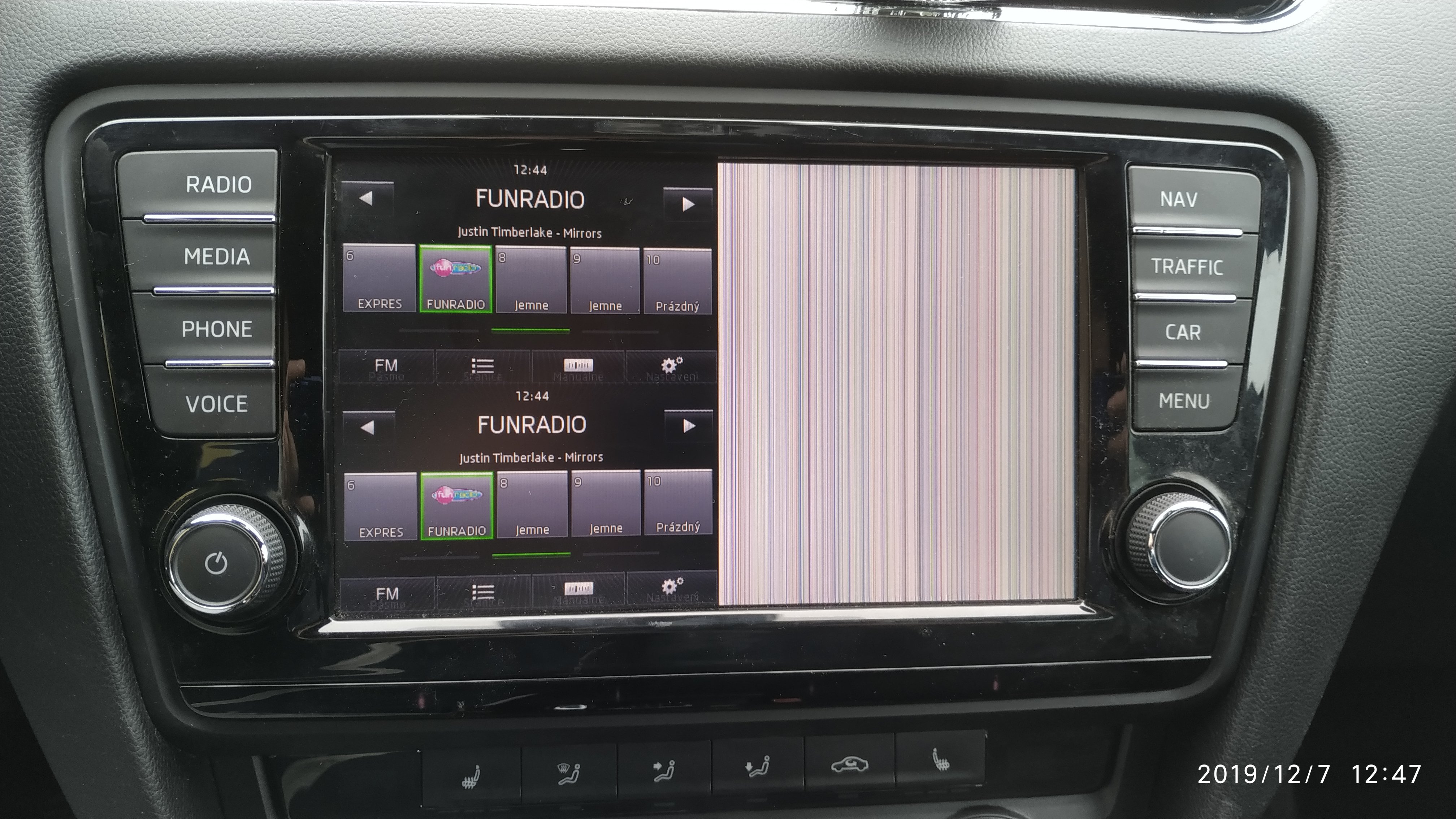

Hello i have amundsen MiB1, and i buy lcd columbus and replace it. All work good, but lcd have problem... Can anyone help?
Old amundsen: 5E0 919 605D
New columbus: 5E0 919 606
Primary Machine with CD a 2x SD: ZR_StdNav_MOST: 5E0 035 864 A
The screen is not compatible with the MIB1 Amundsen, only MIB2. You will need a MIB2 base unit (or a MIB1 Columbus) to match it.
5E0 035 864 A is not a mib1 columbus unit? This lcd is mib1 columbus?
5E0035864A is the part number for a MIB1 Amundsen. You have bought a Columbus screen 5E0919606. These are not compatible components. The screen is just a screen, the MIB1 Amundsen runs 240x400 resolution, not 480x800 for the 8 inch screen. The only fix for this is to upgrade the radio to one that supports the screen, either a MIB1 Columbus or a MIB2, or you go back to the old screen.
Then i must buy another radio unit? No exist resolution adapter for it? Which radio will be Best For this columbus display?
What solution do you recommend?
Swapping radios isn’t a cheap and easy process. All MIB radio’s have Component Protection that must be removed and then features need to be reactivated. I would recommend the MIB2 Amundsen for its cost, ease of rework and features including SmartLink for Android Auto/Apple CarPlay/MirrorLink. 5Q0035874A is the one to go for and then you’ll need to talk to member Pab567 about rework cost to get it to work in the car.

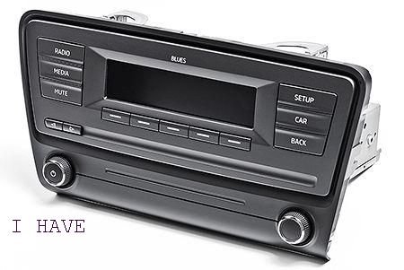

Hello !  My cars is Octavia mk3  2013 . I have  a Blues Radio Unit !
What must I do   to change  this unit with  a Bolero / Amundsen / Columbus     unit with Bluetooth ?
Can I do something with VCDS   for   Component Protection  ?
Thank you !
Someone asked a similar question a while back. You'll need to take the glovebox out to reroute the cables from behind the centre console to where the glovebox unit will be. Then you'll need the required cables for the screen and any other cables (GPS, etc.).
If it were me I'd go for an alpine halo 9. Single din so should fit ok and gives a load more functions than you have already and carplay/android auto ready. Should be mostly plug and play.
No, CP removal needs access to the Skoda database (or a firmware hack).
